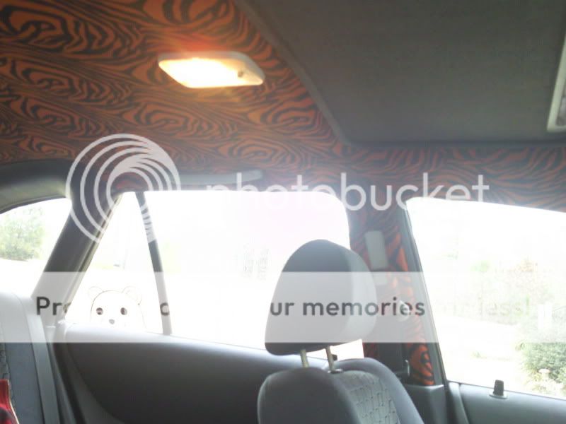

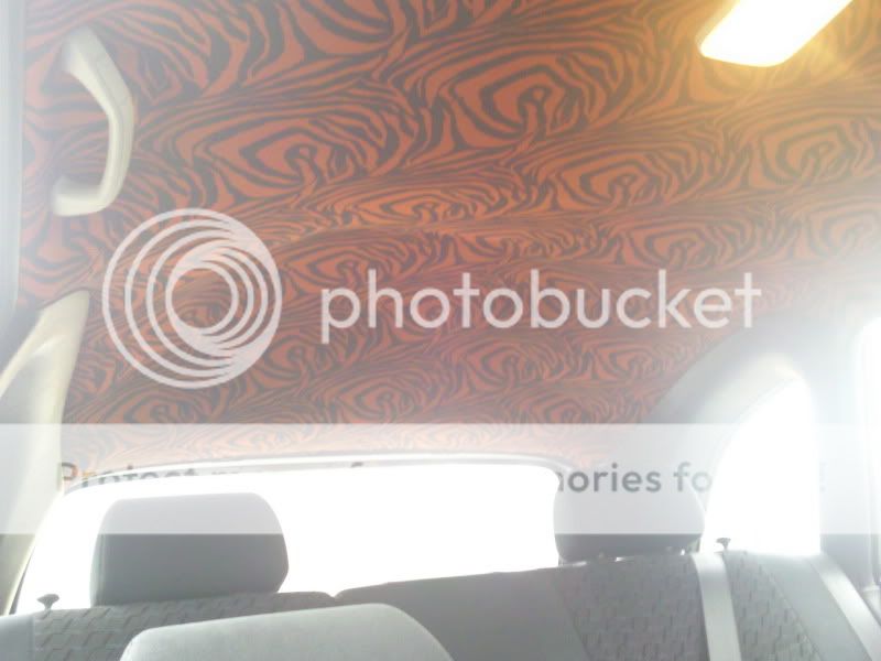

headliner
Dude that is weirdest! awesomest! Most bad ass headliner I think I have ever seen!! hahaha. Car looks amazing dude!!
