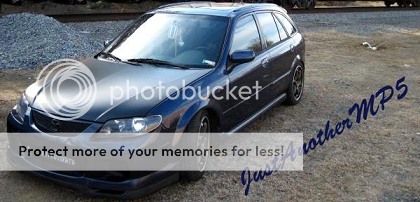

I know I took awhile, but I finally messed around with making a sig for you. Don't know if you'll want to use it though since u changed ur hood back...
sweeet, nah i actually liked that hood since it actually fit good lol
thanks man ill change that to my sig in a sec
