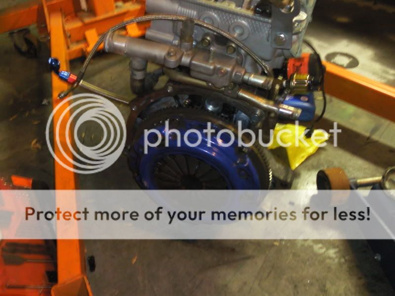

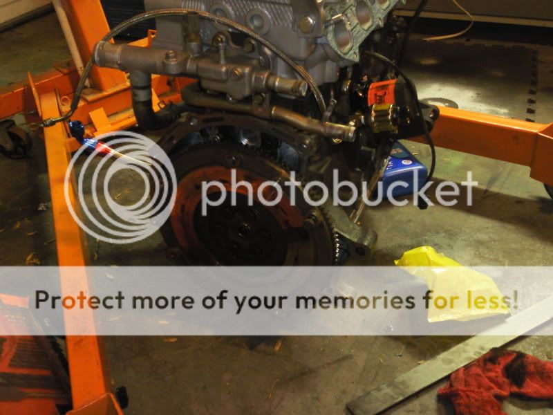

i just finished the timing belt, found how to do it somewhere on here by accident lol got the flywheel on and torqued and now im trying to find the torque specs for the clutch so i can get that on
pics once im done getting the trans on

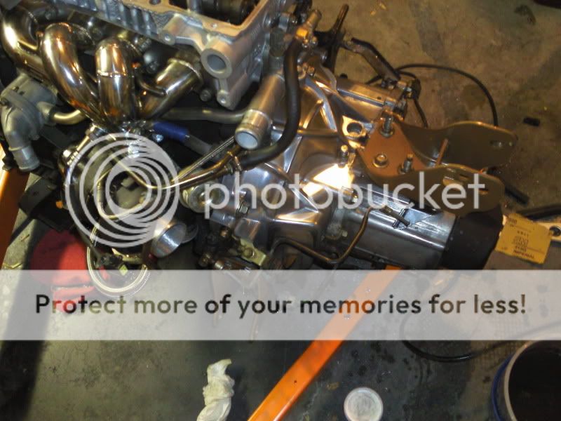

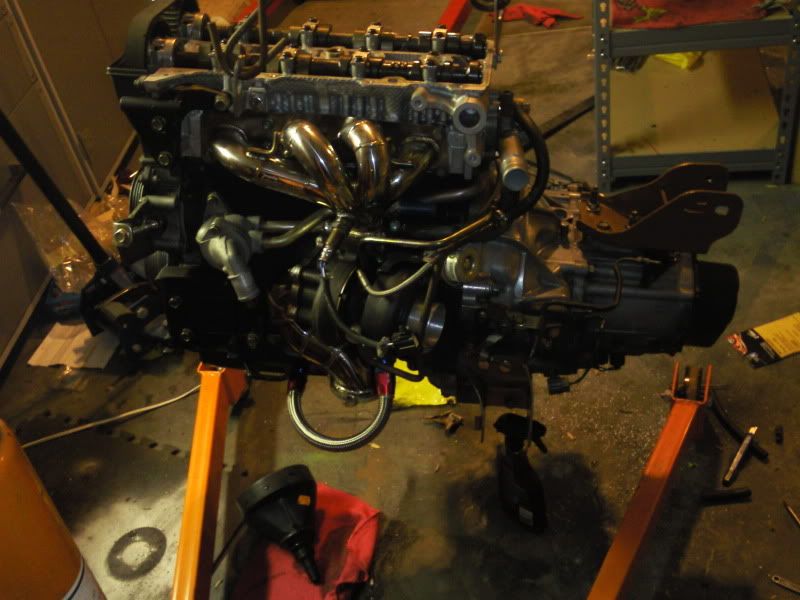

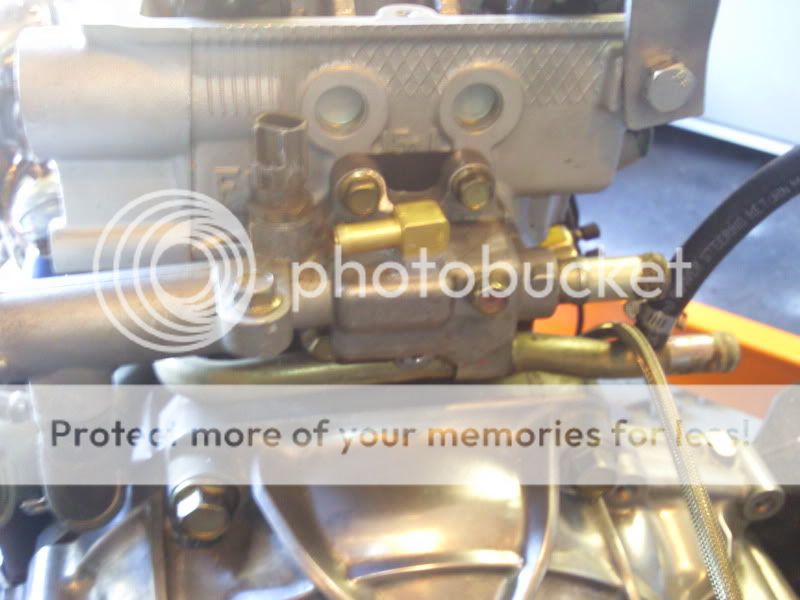

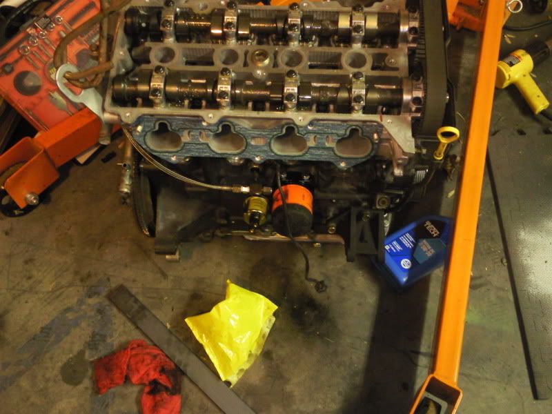

i got the turbo mani, turbo, coolant lines, s pipe, all the engine mount brackets on the block, and intake mani on the engine today

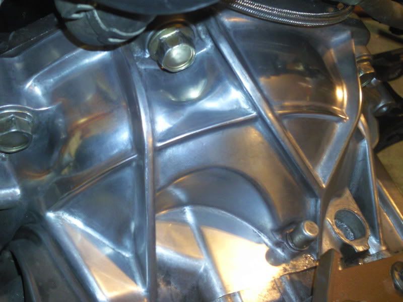

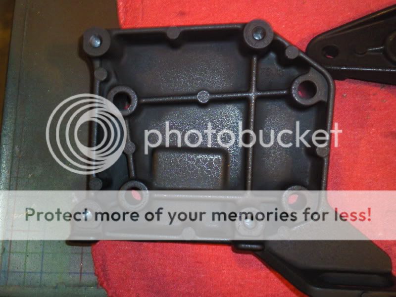

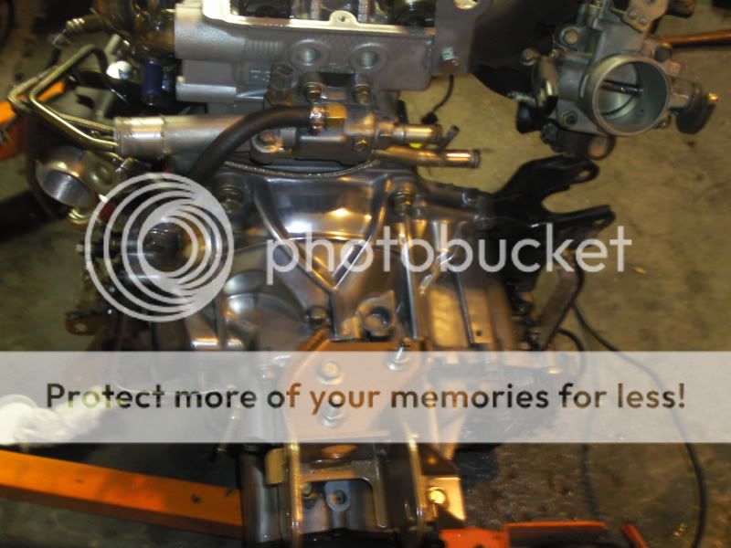

i started cleaning the trans and thought i would give somthing a try, u might be able to see it in the pic but it looks a ton better in person

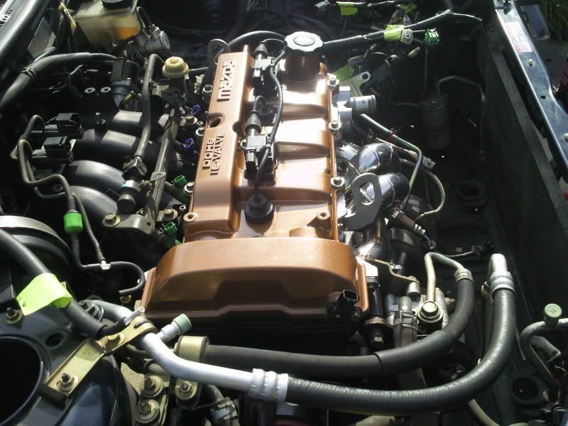

IT RUNSSSS!!!!
i forgot to put a video camera in front when i started it but i took a video with my phone right after i started it, it was warming up and i let it run for like a good 3 minutes before i saw i had a coolant leak lol
i know where its comin from but i was hoping it wouldnt leak..kinda my fault
but i have to take the manifold off to get to the leak and then once thats tight i should be set to break it in
idle was a bit bumpy at first and blue smoke was comin out of the exhaust but i spilled some oil in the sparkplug hole so maybe thats why lol
man im so ****** excited

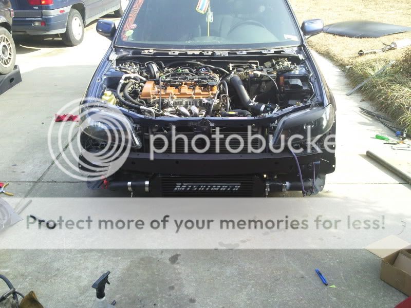

lol hang on a sec man! i need to get it on photobucket first
edit:

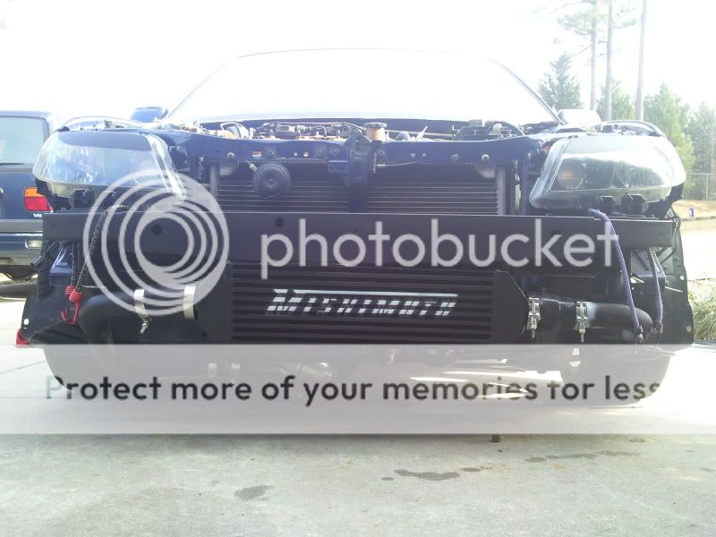

those are all the pics i have right now, and yes i know the IC is crooked, i need to fix that but i need some more 2" pipe to lengthen one side of the hot pipe so i can get around the frame right there
