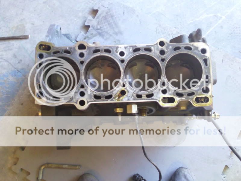

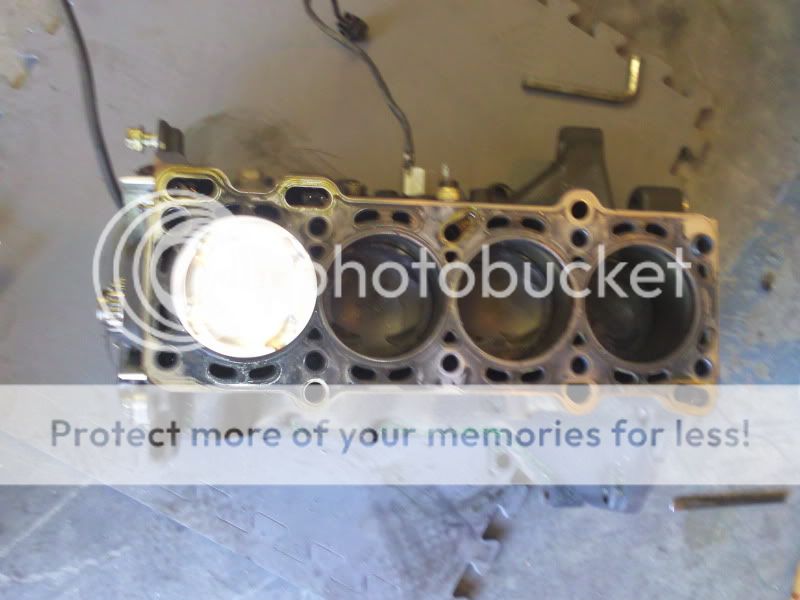

got the head off finally, had to use a cheater pipe on a regular allen wrench lol but i got it
head
new to old comparo

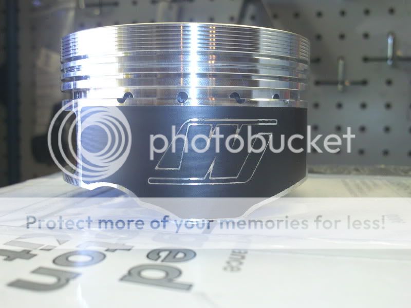

wisecos

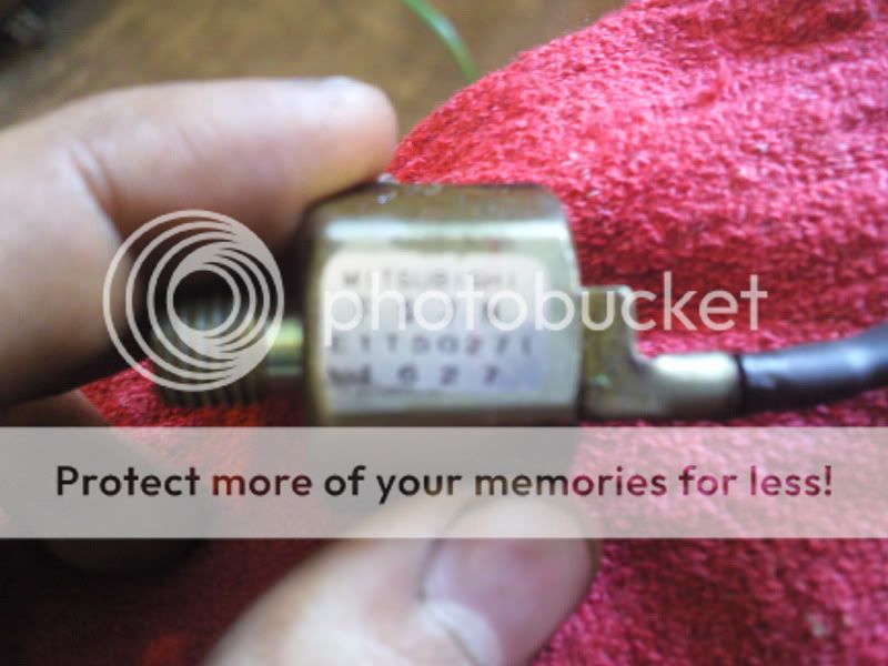

cant really see it but apparently mazda uses some mitsubishi parts

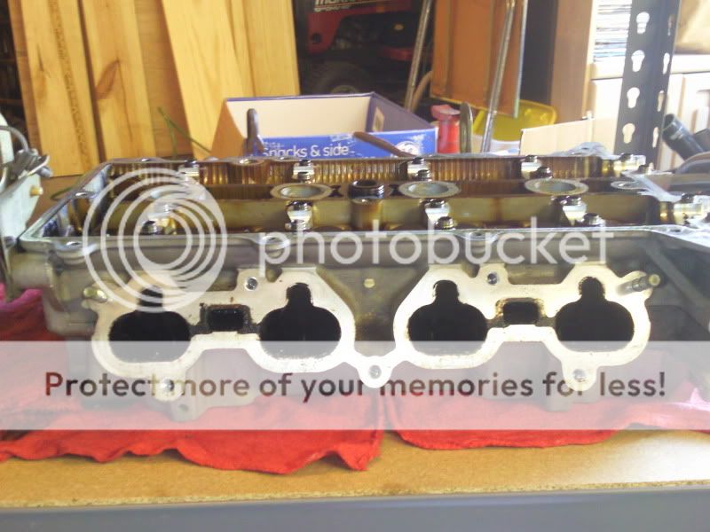

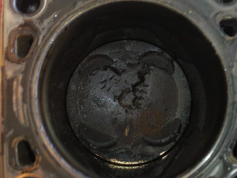

lots of carbon build up, YUck!

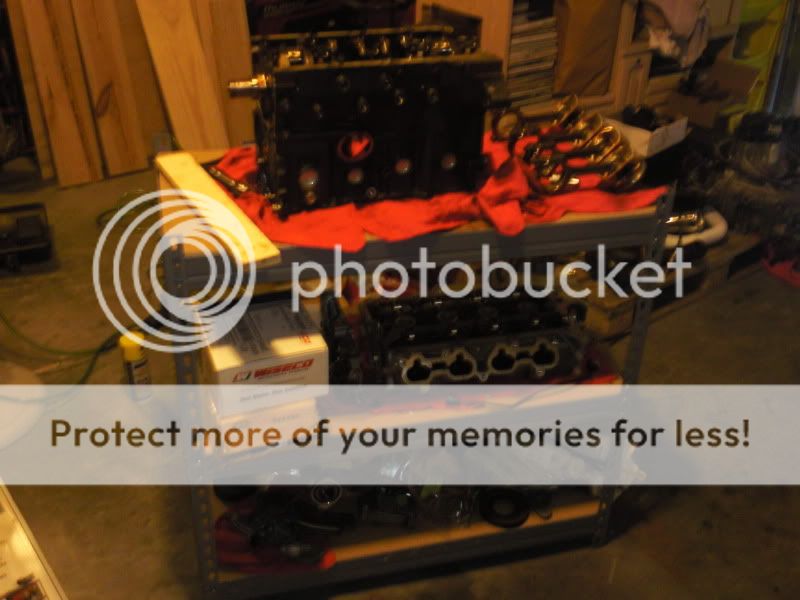

work station

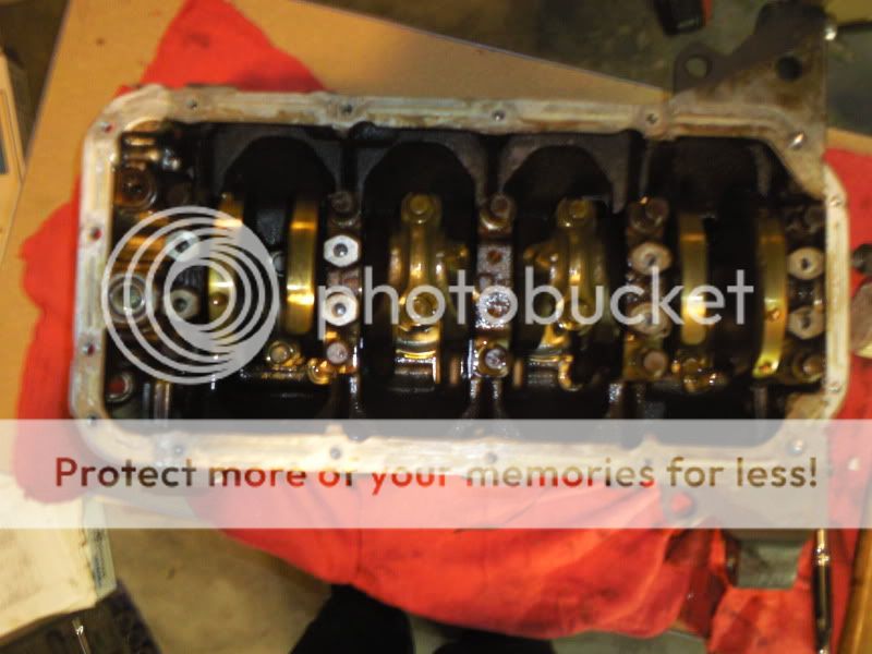

all thats left for me to do is take the crank out, already have the bolts loose, just take it out and torque the main caps back down so i can take it to the machine shop and have them do there magic
ok well i just dropped off the block and head at the machine shop
