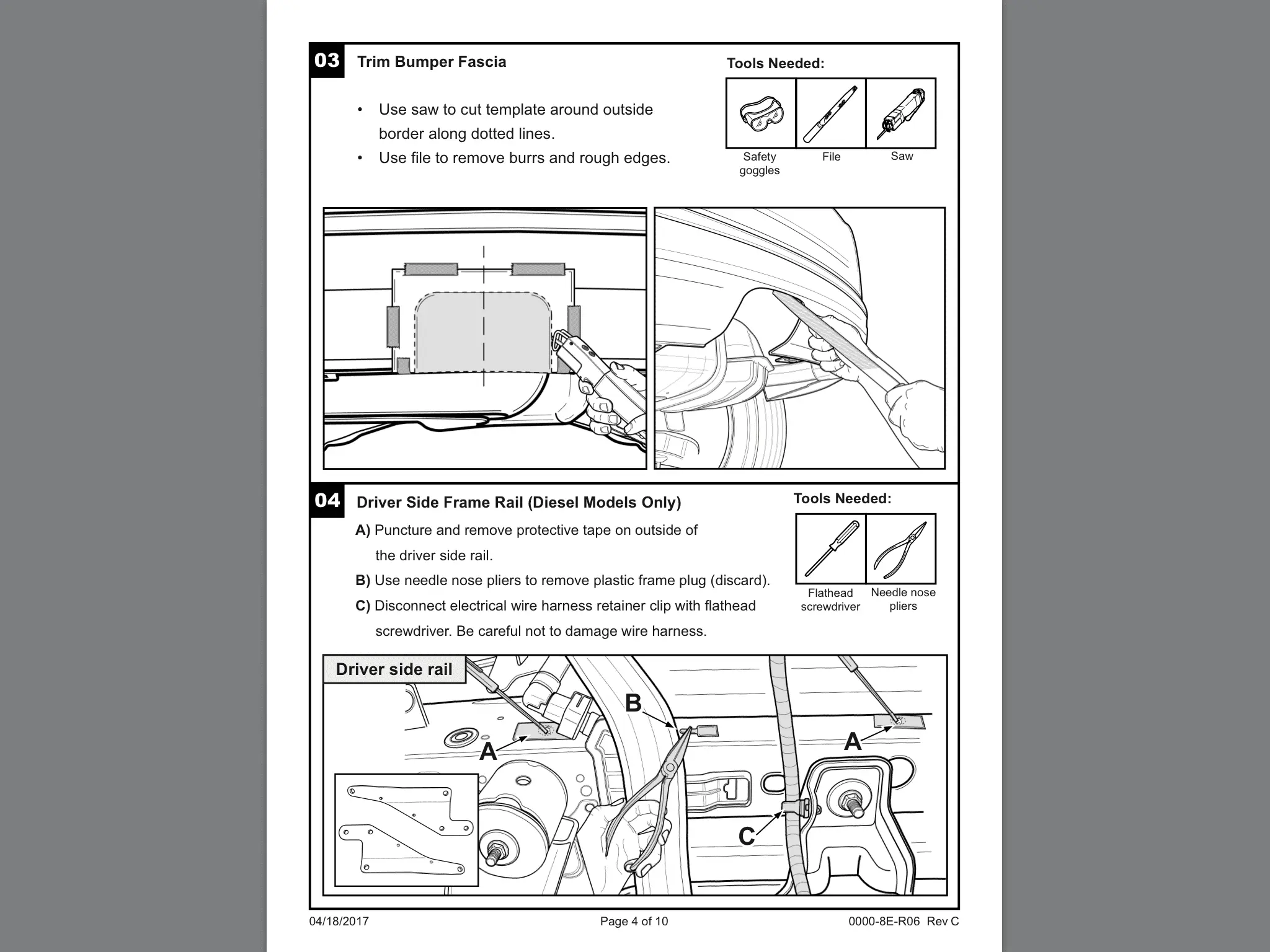

Yes, thanks for posting this! That is what I expected. Mazda corporate admitted that this is not what the installs look like now. The new ones require a cuttout like the template I posted earlier.
Hey gce,
Could you let us know where you found this picture? I was told by the dealer that the picture shows a 2016 and earlier installation.
There clearly is some confusion out by Mazda, what they show online, and the dealers as to how to properly install an OEM hitch and what the customer should expect.
Tom

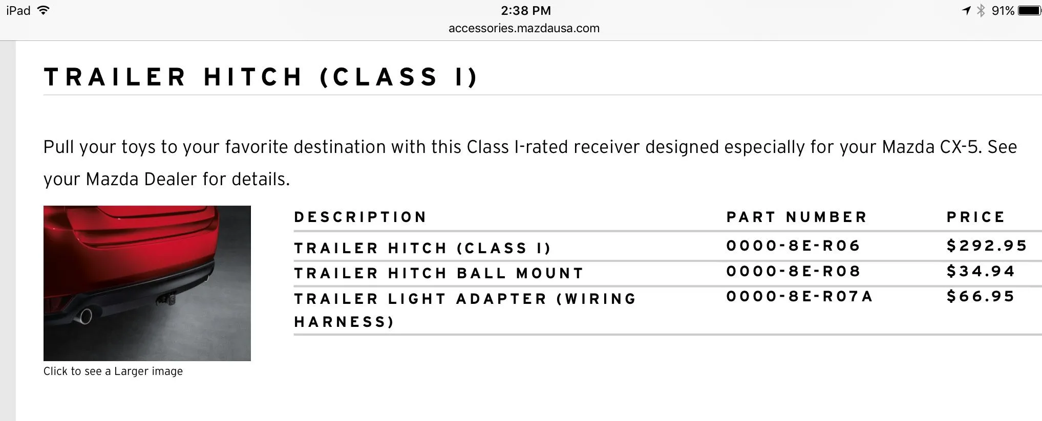

Found it. Right from the Mazda USA accessories site:
Does not look like mine.......

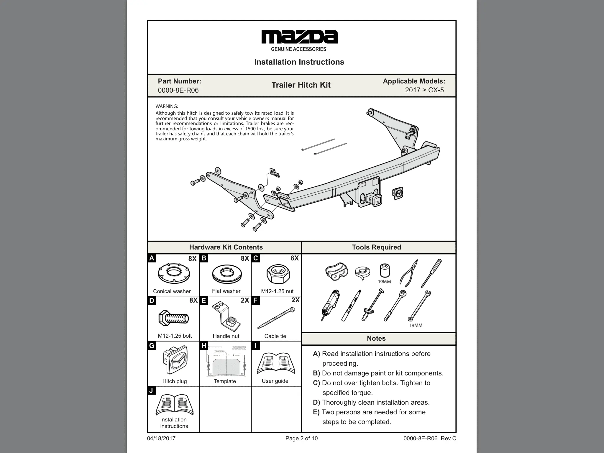

Looked everywhere for this, could not find the install manual. Dealer will be getting a copy.

Maybe that's the problem, CX-5 OEM is a class 1 not a class 2. I think the CX-9 has an OEM class 2.
I think that there is a cutout on the CX-9 Class II installation. The picture shows the hitch high up close to the crease in the bumper. I requested that a Class II be put on my CX-5, which most likely resulted in a cutout although the Mazda installation guide shows a similar installation with cutout for the Class I but with a much smaller hole than mine. See attached photo.

As far as I know, there is no OEM class 2 hitch for your car. all the aftermarket hitches i have seen for the CX-5, sit below the bumper and don't require a cutout. Even the CX-9 cutout would not be a giant hole like on yours.
Looking at the cuts made on your bumper, even if they had the wrong template, the person went way outside the lines - you have cuts outside the hole. I would give up trying to figure out what happened here.
