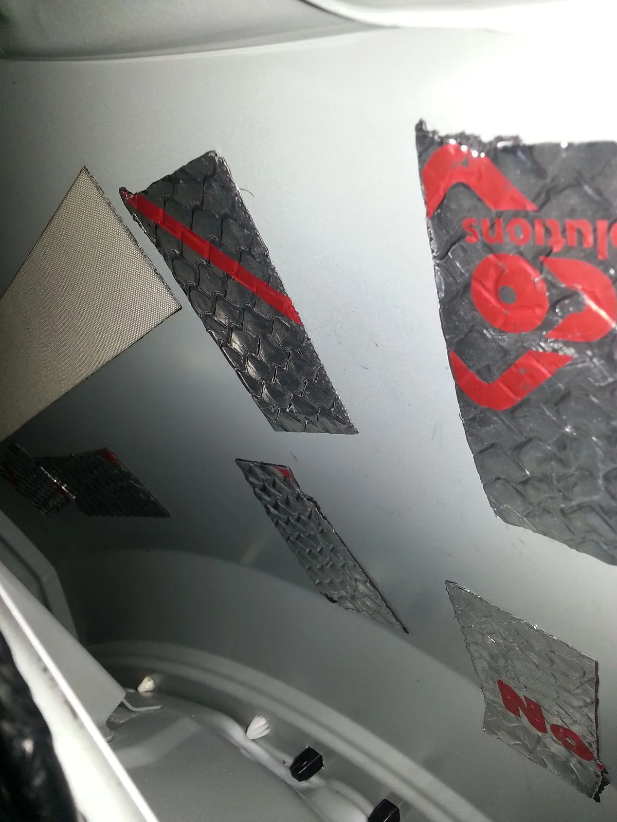

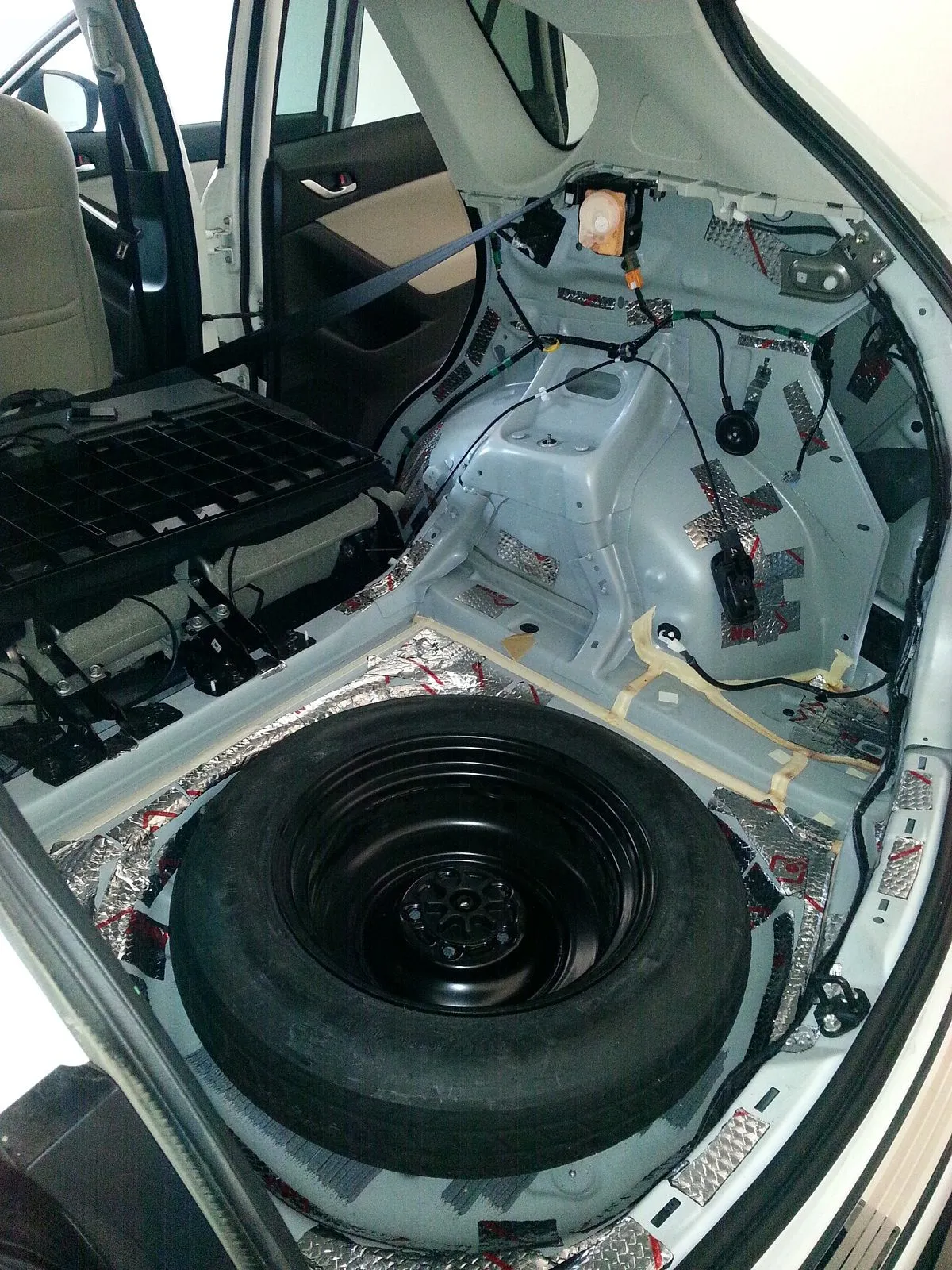

I added CLD tiles to the rear trunk area and also the rear quarter panels. There was I think one white OEM tile in each rear panel. Not surprisingly, adding additional tiles changed the tone of the panels when tapped. Waiting for my decoupling/insulation material to come in to be installed in the inner shell of the car. Crossing my fingers that this material can also lessen exterior sound allowing me to bypass having to use heavy MLV.
I did a little on the rear hatch. But I really want to add more. Also did some directly behind front door speakers with a piece of foam glued on top of the deadener. The foam is purely for acoustics. I do feel the little bit of deadener has gone a long way. But I also want to do more in the rear cargo area like this. Should have done it from the get go. Also the overhead compartment and the housing for the sensors on windshield cause some vibrations. Thinking of a cure for that

The trunk and rear hatch is the big deal in terms of effect, as are rear quarter panels.
Rear cargo weakspots are the wheel wheels and the section under the spare tire. I'm not touching the roof. Too risky and too much trouble for me lol. That said when I drove on the freeway the sunroof "cover/lid" makes a big difference in sound with it open an closed. I never use the sunroof yet it allows noise to enter the cabin if cover/lid is open. I wonder if I lay a sized piece of my denim/foil material on top of that lid if there's any difference.
