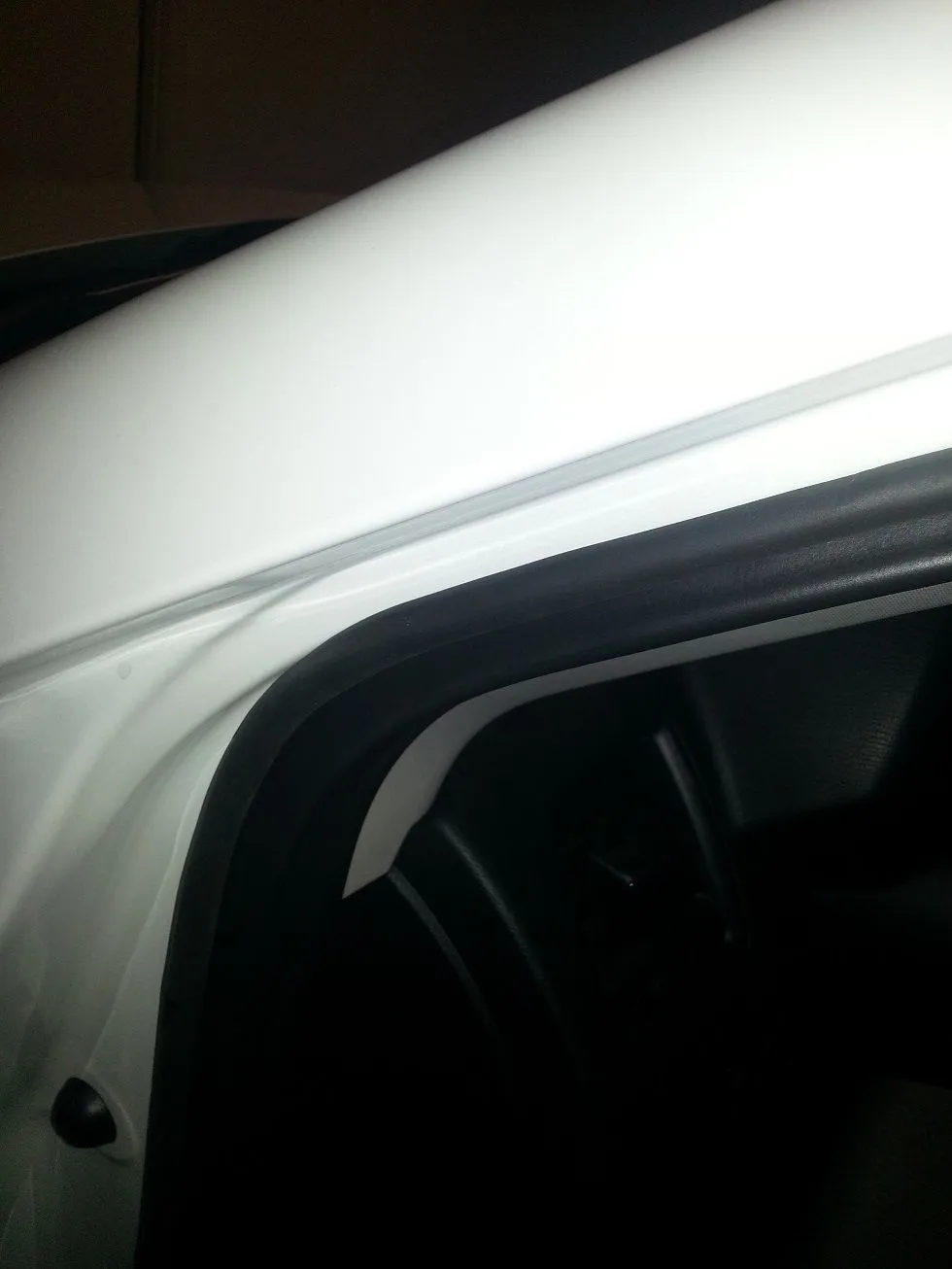

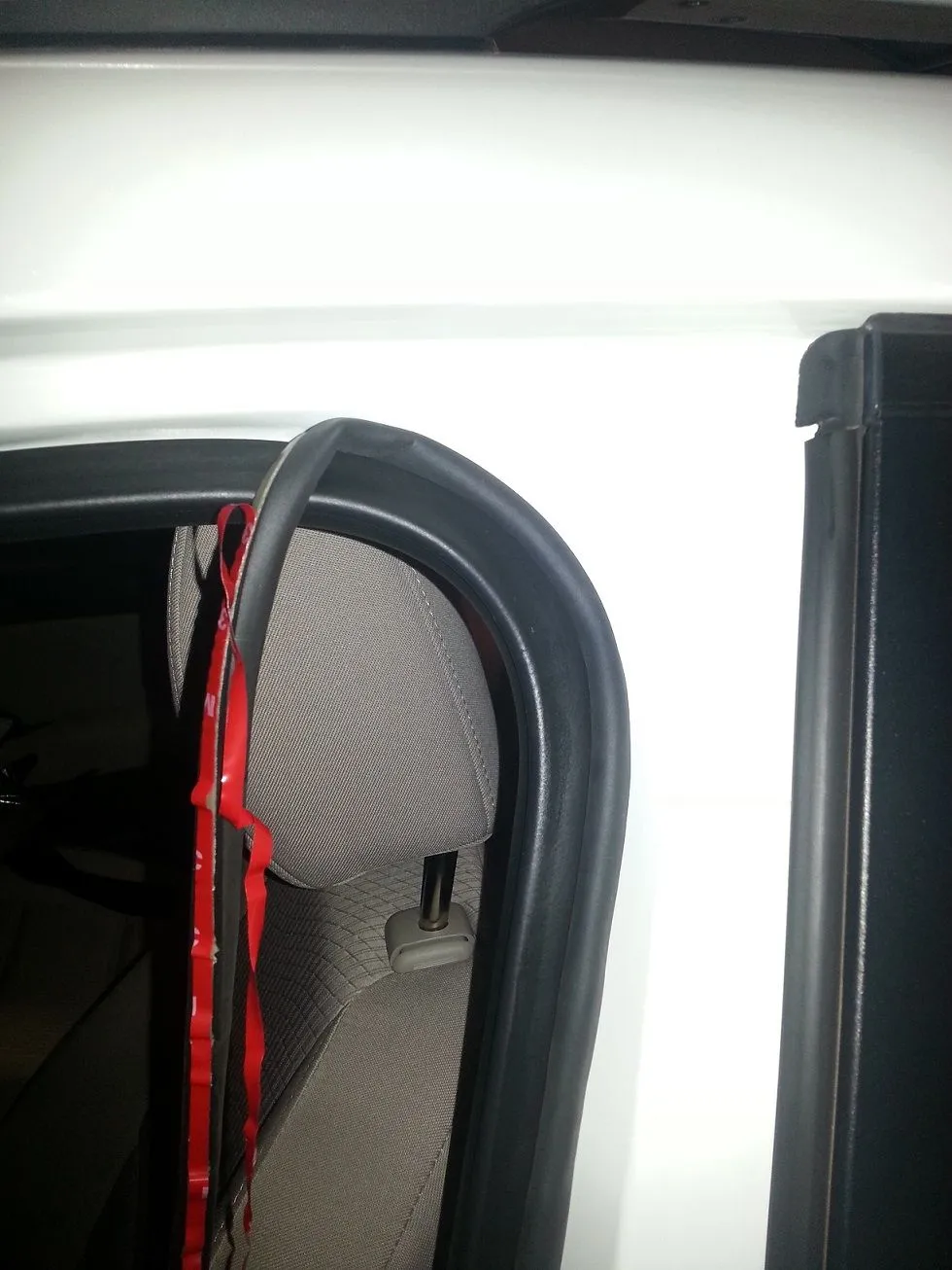

Another thing I want to target is the stock weather stripping. I highly advise you guys keep them clean and supple. As well as their respective contact points along the painted door frame surfaces as to provide a good seal. A weak spot I noticed is they are attached via rivets. I'm looking into either sealing them with weather strip sealant or maybe adding additional weather stripping in some sections. I'll post photos and my findings as I go along.

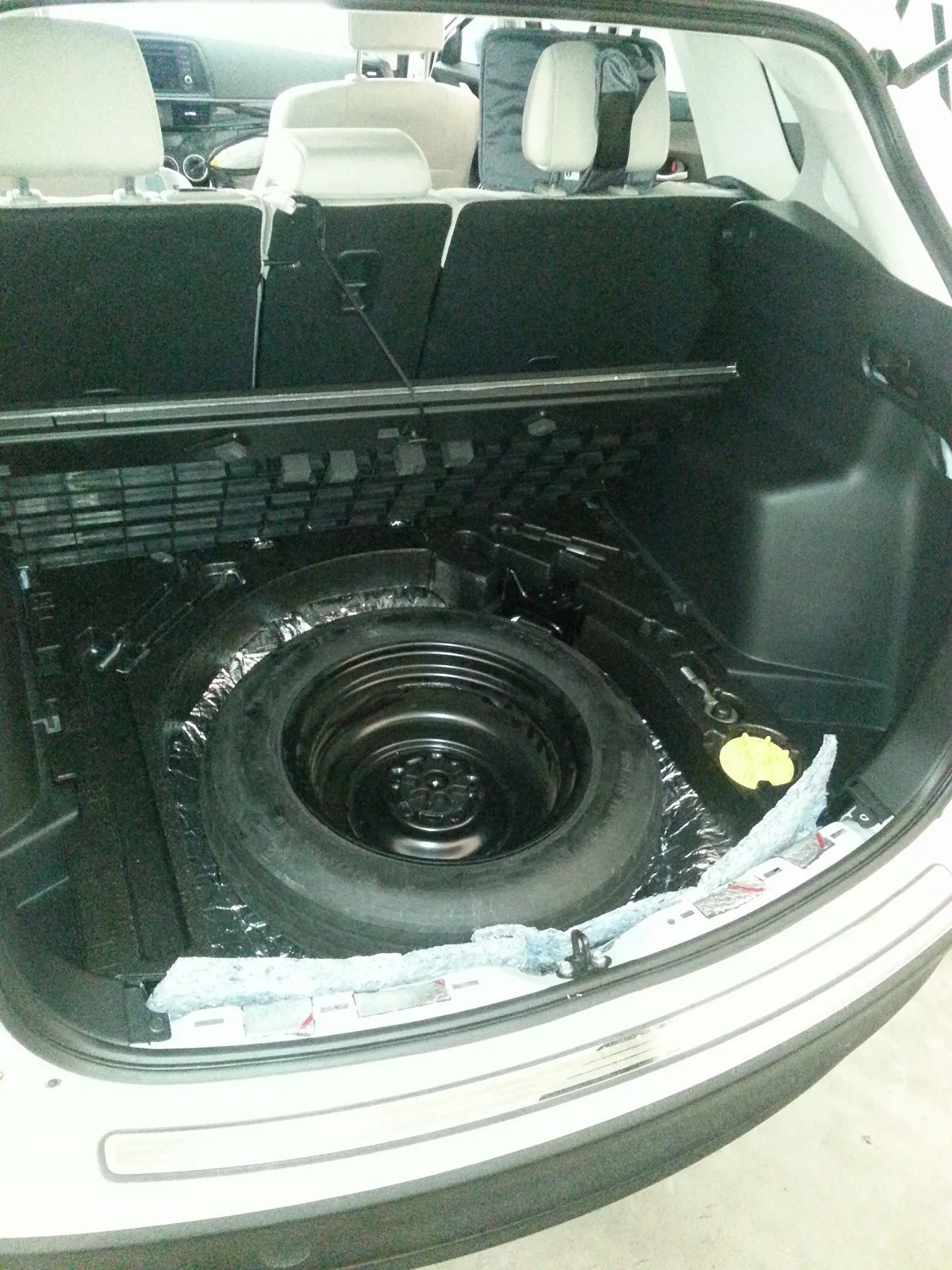

I looked at the CX-5 spare wheel well. There's lots of holes. Even if you take merely 5lbs of 50mil CLD (10 sq ft) to target those holes and solidify certain thin metal sections you could see improvements in your bass. As far as weight you can opt for a single CS exhaust for even lighter weight I think. Swapping to lighter wheels should help too but requires a higher investment.

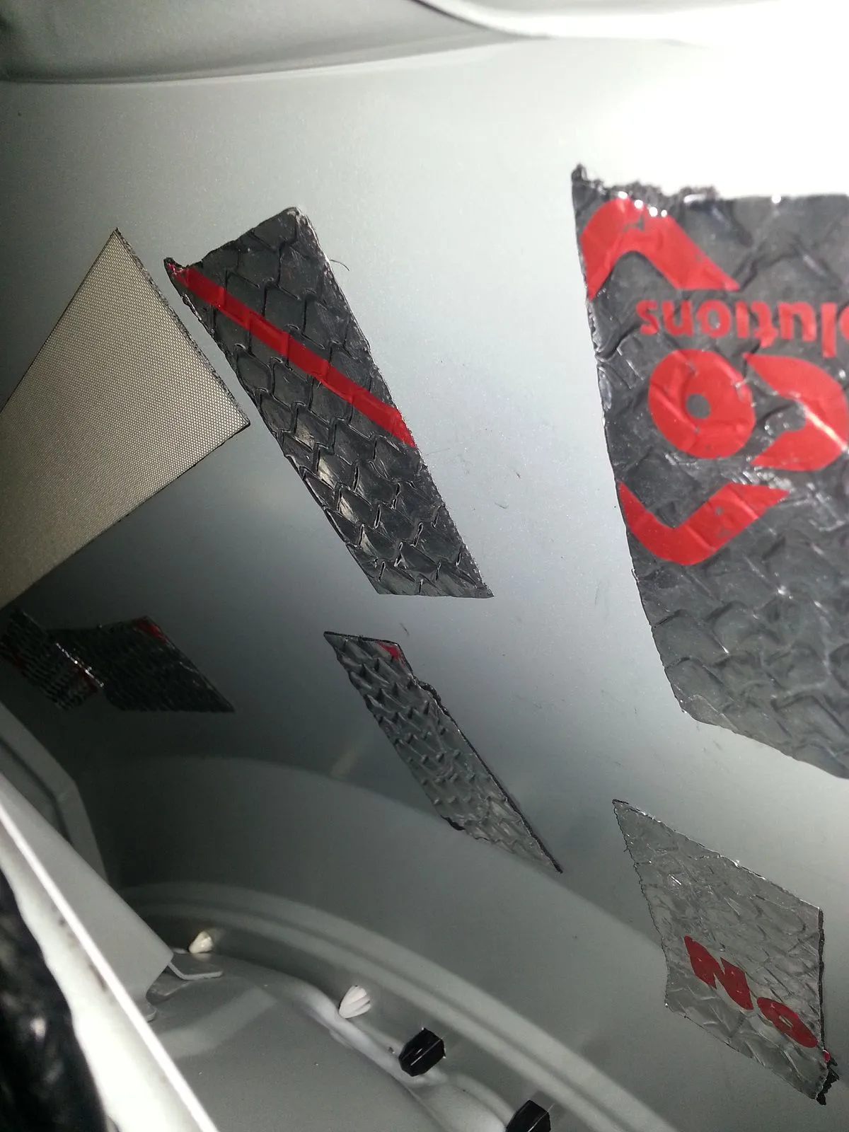

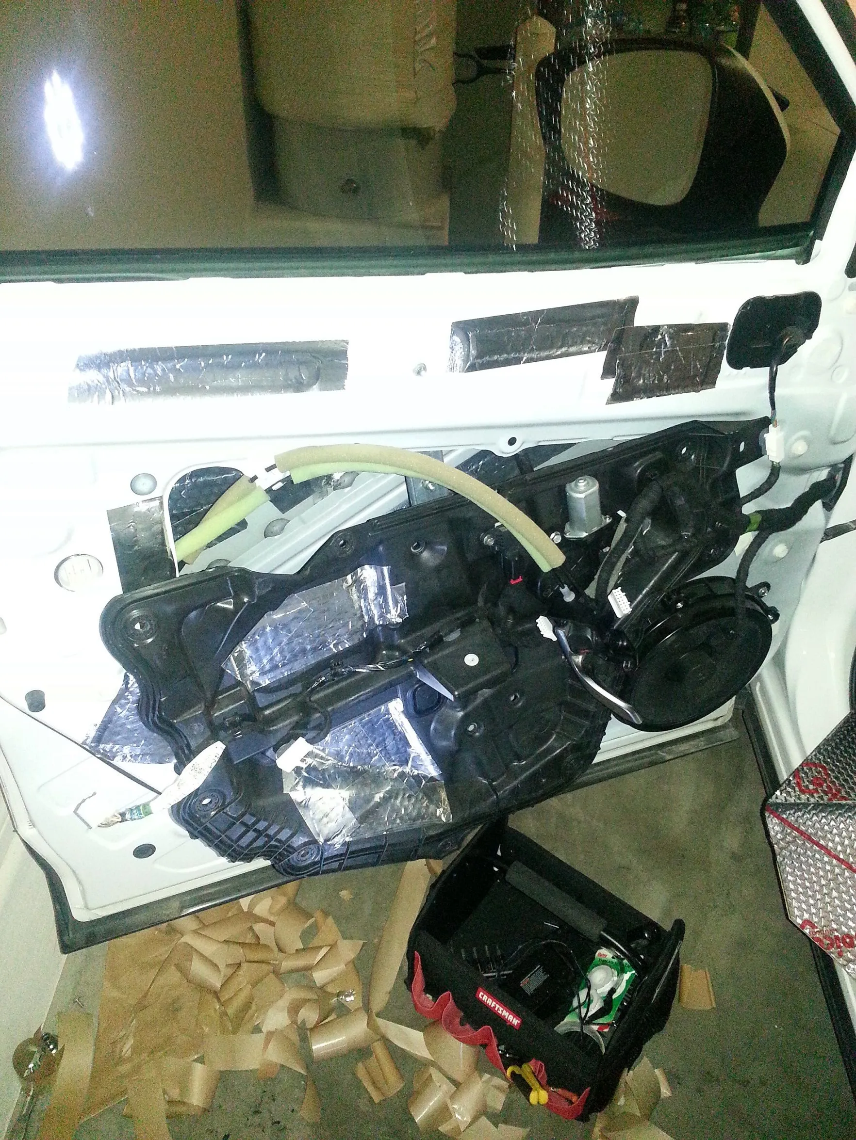

Okay so I installed Noico's 50mil (CLD) Constrained Layer Dampener unto the outer skin of the four doors. There's metal beams glued unto the door set at 40 degree angle or so in there. I mainly targeted areas of open sheet metal. I created templates consisting of shapes (ex. 9 x 6 triangles and 2 x 10 rectangles) to fill surfaces I could get to. I covered edges with 4mil HVAC foil tape as to prevent any smell from leaking butyl plus it added a little thickness to the 50 mil sheet. I did not want to disconnect the power window/locks from the weather seal so they were connected the whole time which delayed my install being that they were in my way. Eventually of available flat surfaces I had access to, I covered roughly 35% with CLD in strategic locations. When I completed the driver door and closed it there's a considerably difference in tone when tapping it all through out its various sections. I added some CLD/Foil to some sections of the inner door which felt weak. Tapping the other three doors produced more of a higher pitch tink tink sound. I felt there was difference in traffic sound when driving near a motorcycle or large truck due to different frequency vibration on the doors. Road noise from tires and wind are still there of course and will be addressed later. Aprox. weight added to each door was 3-3.5 lbs. Weather was 110 degrees at 20% humidity and no smell in the CX-5.
When I have the funds and time I'll add foam and MLV unto the inner door which will provide the real sound stopping power. I will also attempt to install extra weather strips which I've ordered through Ebay.

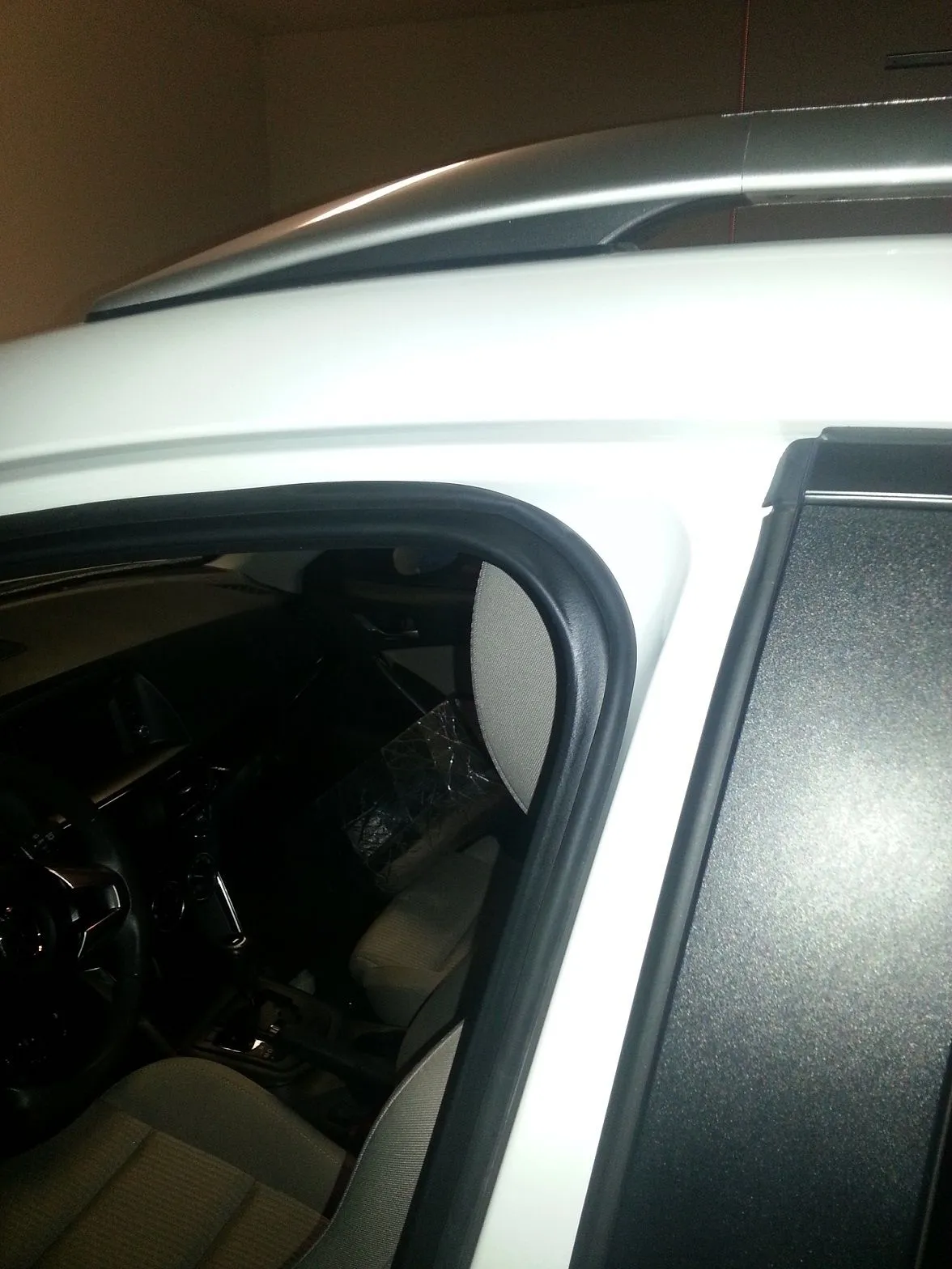

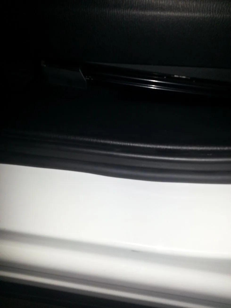

The stock door weather strip (on this 2013 model) allows for the door to move ever so slightly which helps to contribute towards vibration. Noticeable mirror vibration. Adding an additional door weather strip meant more force is applied to closed the door now. The additional seal provides more surface contact to help stabilize the door from movement caused by wind and/or the car's structural vibration (engine, bumpy road, ect). The additional contact surface also creates a greater barrier for sound to pass through.

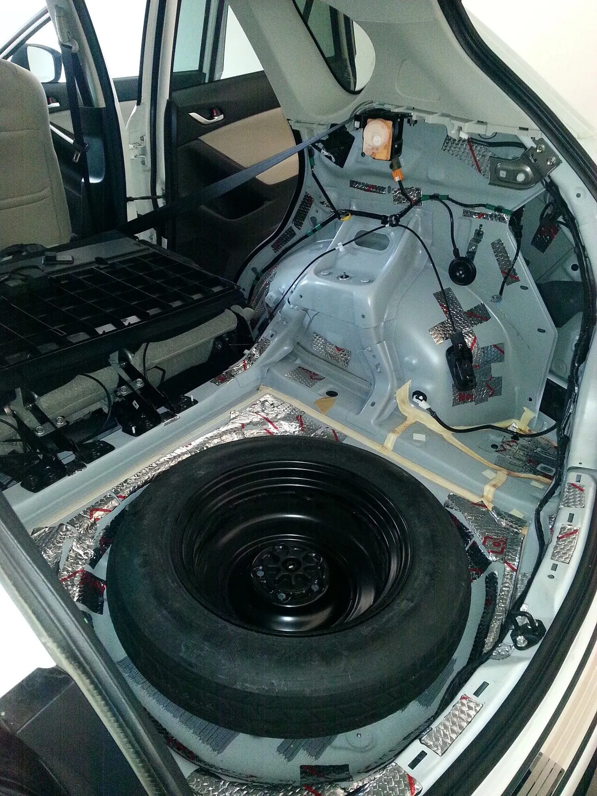

I added CLD tiles to the rear trunk area and also the rear quarter panels. There was I think one white OEM tile in each rear panel. Not surprisingly, adding additional tiles changed the tone of the panels when tapped. Waiting for my decoupling/insulation material to come in to be installed in the inner shell of the car. Crossing my fingers that this material can also lessen exterior sound allowing me to bypass having to use heavy MLV.

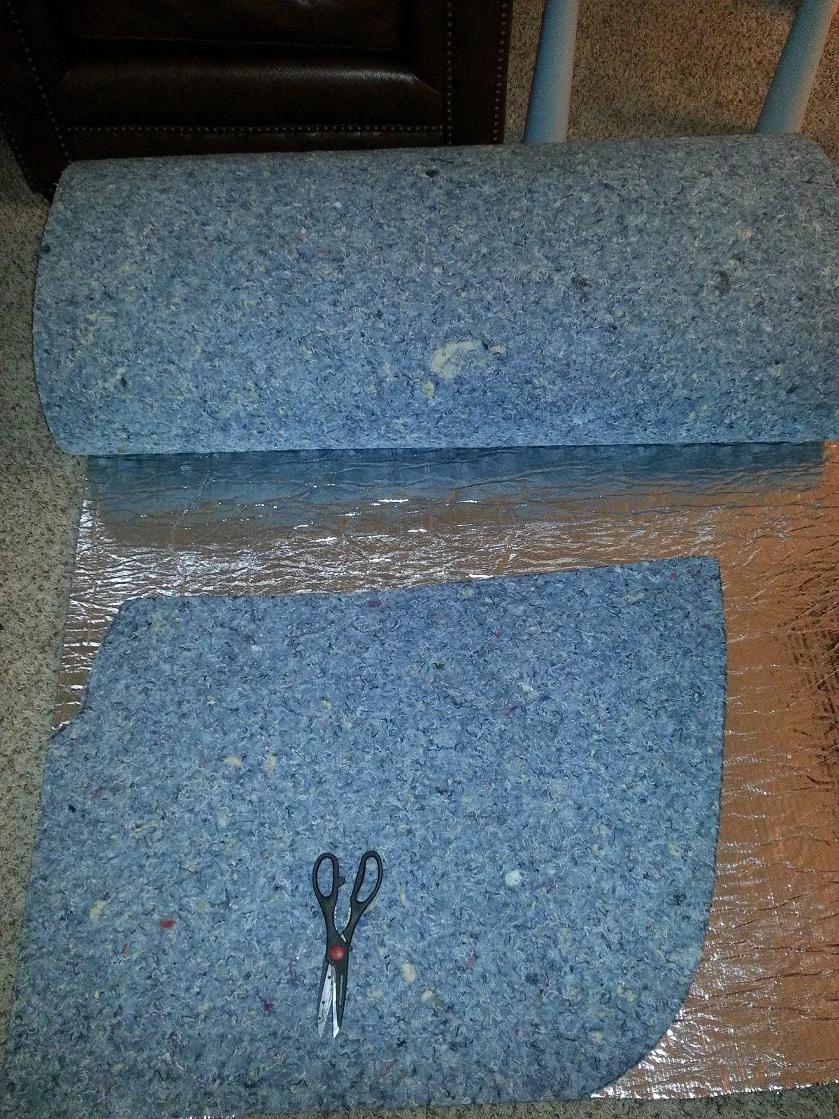

I added the decouple material unto the doors.
Edmunds.com did a test on a 2.0l 2013 CX-5 model which measured 67db at 70mph. I'll use that as a rough baseline. (note: they measured lower dbs in later models. I guess Mazda added more deadening in later years).
Driving on a windy day through rough and smooth freeways and with the AC fan set (at 75%) going 70mph and using a simple app to measure dbs I got 70 dbs most of the way. I did however got down to 65 dbs when the road was smooth. The meter would spike like 5-8 dbs each time I hit a bump or drive over irregularities on the freeway.
My findings at this point suggest the best bang for buck in sound deadening is the floor and specifically the wheel wells. The particular decouple material I used is fire retardant treated cotton denim backed with foil. Its rated at NRC (Noise Reduction Coefficient) of 0.45 which means it absorbs up to 45% of sound. Pretty sure it does little for lower frequencies however. At home I placed a sheet to cover a dish washing machine and it was effective in minimizing the sounds from the spoons, plates, and glasses. Not much on the low freq's of the machine's motor. Placed a patch on top of my phone while playing music and it lowered the sound in about half.

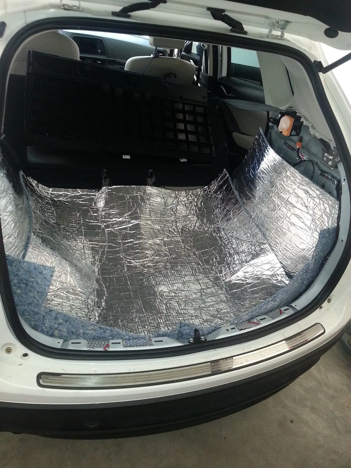

When I had time I placed some of this material unto the rear hatch up to the wheel wells where this was little to no insulation. Just bare metal. I did not have time to test db's on the freeway post hatch install. I only have like an hour block of time on the weekends for this project in my busy schedule. Next up is to cover up the firewall and kick panels with this material.

Fortunately I really think the majority of the noise problem is in the floor/wheel wells. The rear hatch has zero heat/sound insulation. This material's thickness and foil backing helped back there. Oh and I had to add more CLD tiles underneath the spare tire. Wow the sheet metal back there was hot after a 40 mile trip. There's clearance to fit a layer of MLV. I now do see how a 1/8 foam | MLV | 1/8 foam sandwhich similar to what you did provides better fitment underneath all plastic panels. That's probably the ideal route.
On a side note the 4 doors are double weather sealed now. I also added some weather stripping above the headlights and the grill to help seal the hood from incoming air. I'm just copying measures other car manufacturers do to minimize wind noise. TBH the wind noise has gone down to where I can have conversations with people in back while driving 80 in the freeway without having the talk really loud. I've just about met my goal in reducing wind noise. I think the MLV stuff is icing on the cake. I just have to be careful with its weight as this cx-5 only has 155 HP. The majority of exterior sound is through the tires per the db app I used. I think MLV used on the wheel wells on floor will make the car quiet enough for us. Not sure if I'll use it on the doors for the CX-5. I may use it on the Mazda6 though.
