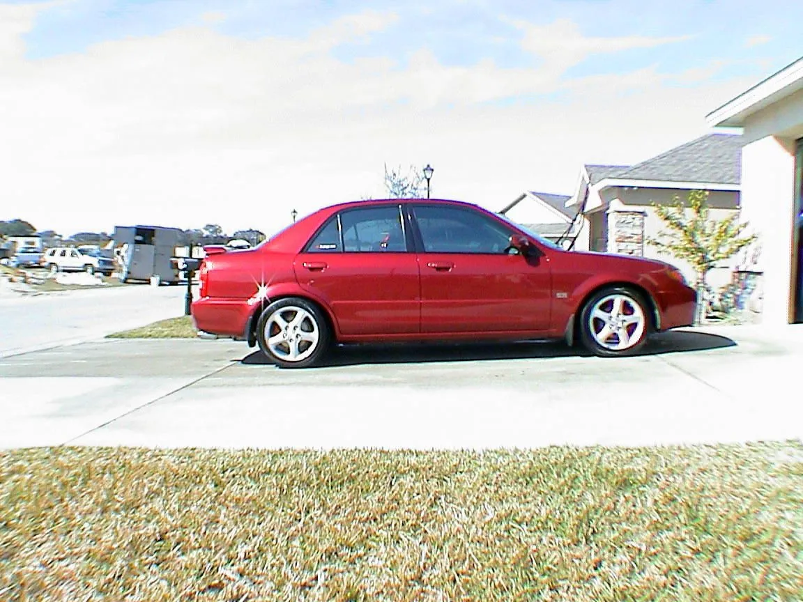

Ya know I forgot to do that, ( set dampner ). I new my car could not be that stiff. Well I took your suggestion and set them to 5 and 7 this morning and the car ride is alot softer and even more agile. It is a little weird when you are braking and the car no longer dives at all. This makes a big difference in stopping power. Or maybe it is just me. Thanks again for the question I was going to call you about it today. Where is your ride height set Rishie? Hear is the picture of my car slammed. Did not drive it this way just pulled it out of the garage, washed it and took a picture. Then raised it up and went for a ride.

I have my damping set at 3 front and 5 rear. My ride height is set floor to fender about 24".
