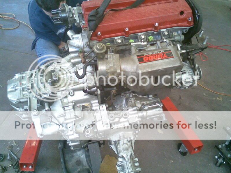

I think he is just saying he has a built MSP transmission for now and in the future will convert to awd using one of his 3 gtx or gtr transmissions, not that he is using the msp trans for awd.
too bad he has an fs and not a bp if he is going awd as the awd toyota drivetrain is prettydamn tuff. dont see how a gtx or gtr trans could survive much abuse from a built FSDET.
If I go nuts of something after getting the FWD sorted I think I will be looking into AWD eventually myself using the toyota awd setup from the celica as it fits the adaptor i have. here is a pic from a guy in the lower hemisphere doing the toyota drivetrain swap into a gtx or gtr cant remember which.
