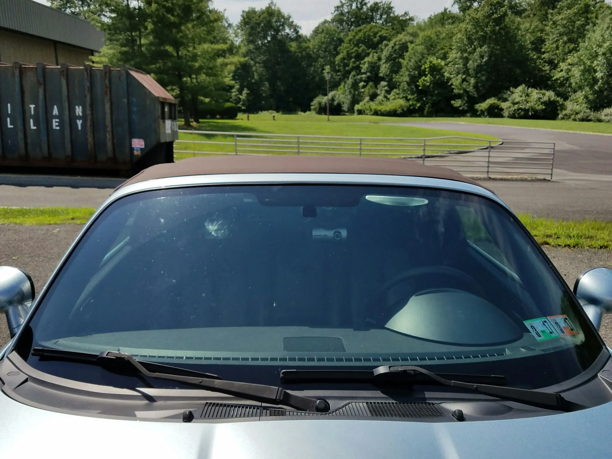

Hard wired a Cobra CBR840 dash cam in today using this 12V outlet from Best Buy. http://www.bestbuy.com/site/peripheral-12v-dc-adapter-black/8294179.p?id=1172880155160&skuId=8294179
Ran the dash cam wire under the windshield header, down the A-pillar and connected it to the outlet behind the area where the fog light switch is located. Used an add-a-fuse to hook it up and had a helluva time finding a fuse that didn't have power on all of the time. Finally found one, the 20A fuse for the wipers under the hood.

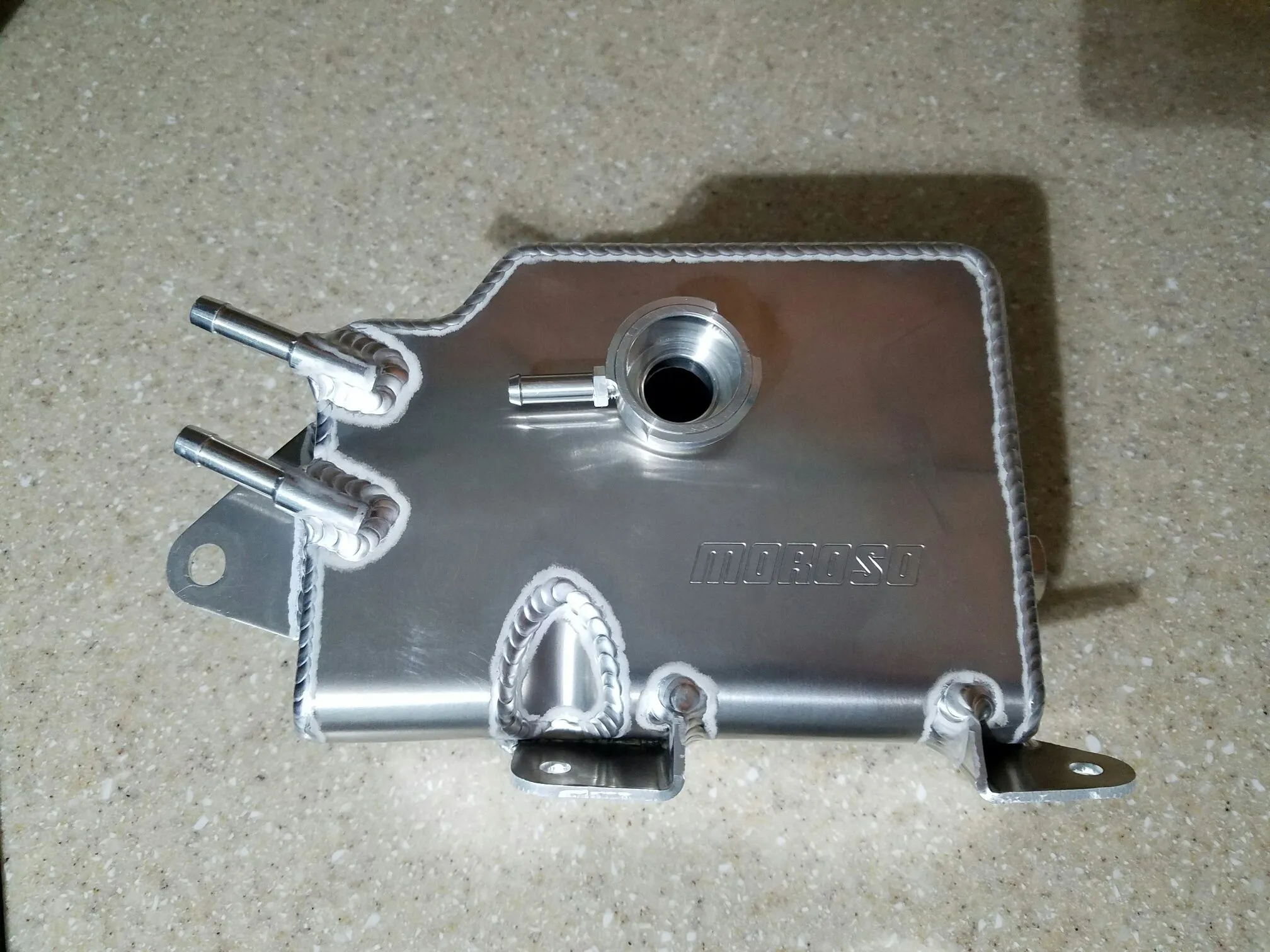

This beauty was delivered today! New rad cap should be arriving at the dealer tomorrow and want to source some new hose clamps. Looking for black worm drive clamps, I despise spring clamps.

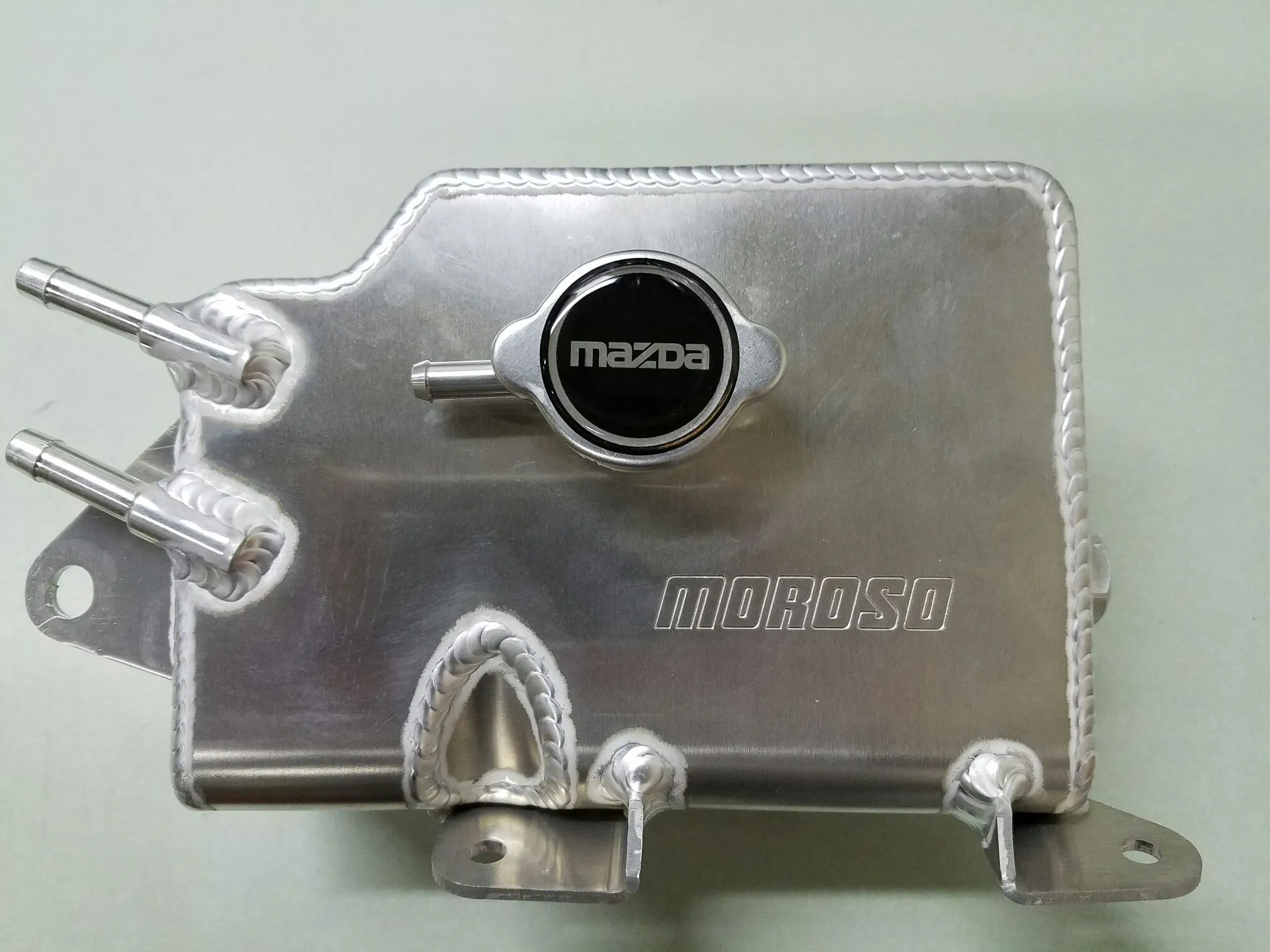

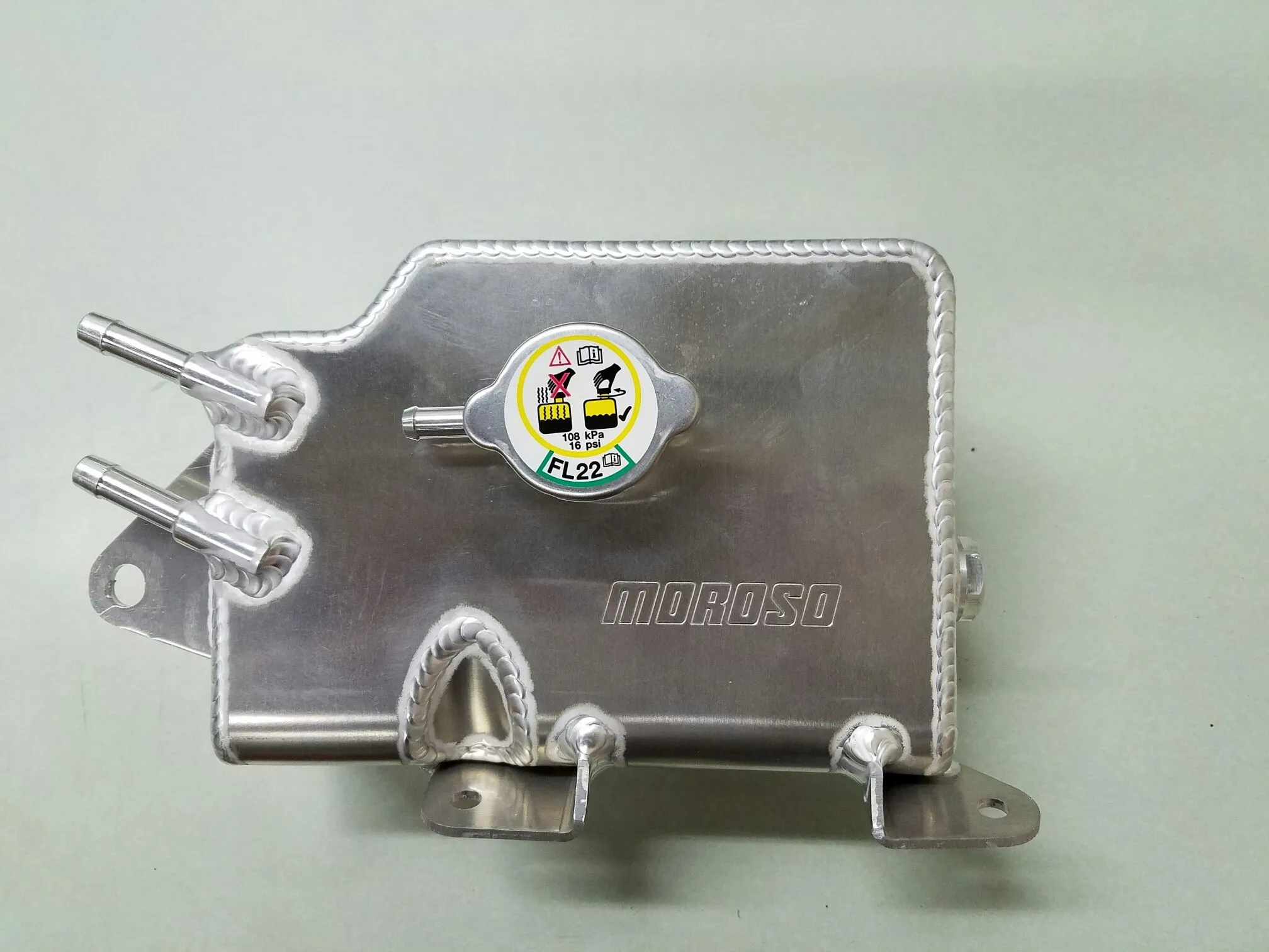

Shortly after ordering the GWR coolant tank, I realized that it was just too darn pretty for an OEM cap.
attachment.php
So I started searching for an aftermarket cap. That's when I realized there isn't much out there, that appealed to me anyway. I liked the Apexi but wish it didn't come in gold, couldn't find the Arc in an NC fitment and wasn't crazy about the color (red) of the HKS. That's when I remembered Adam over at http://revlimiter.net/ who makes custom inserts for oil caps. After a few emails, he made a Model80 insert for me in a custom size. I promptly ordered an OEM cap knowing it would be transformed into something I felt was worthy of the GWR tank.
attachment.php

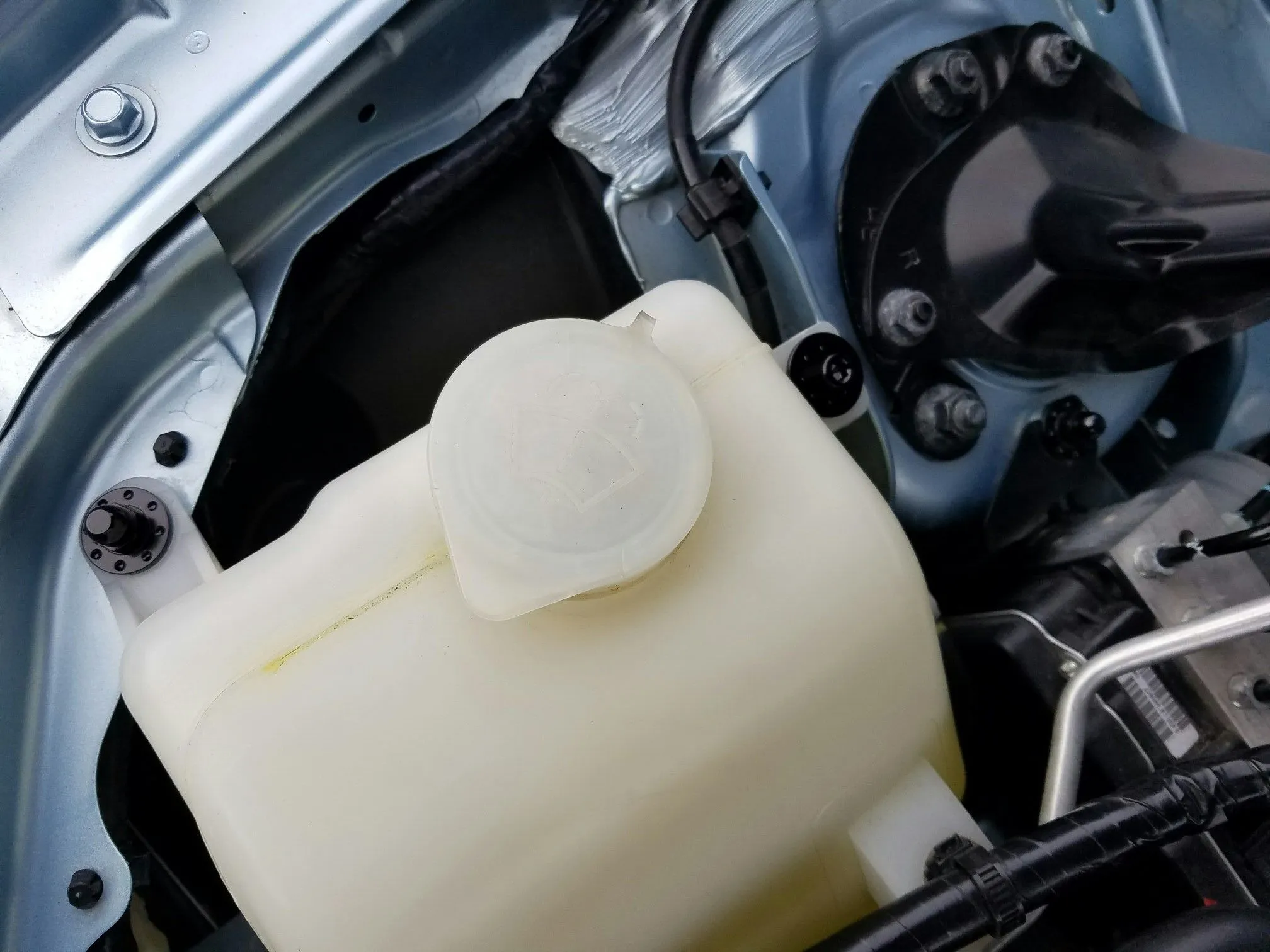

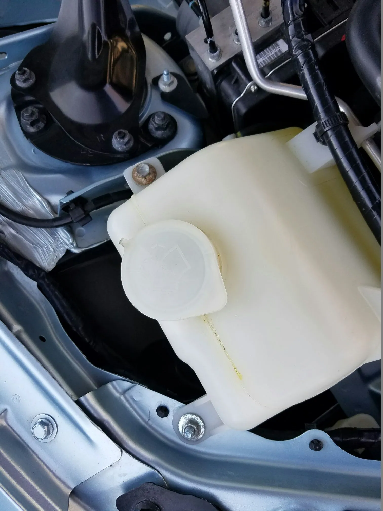

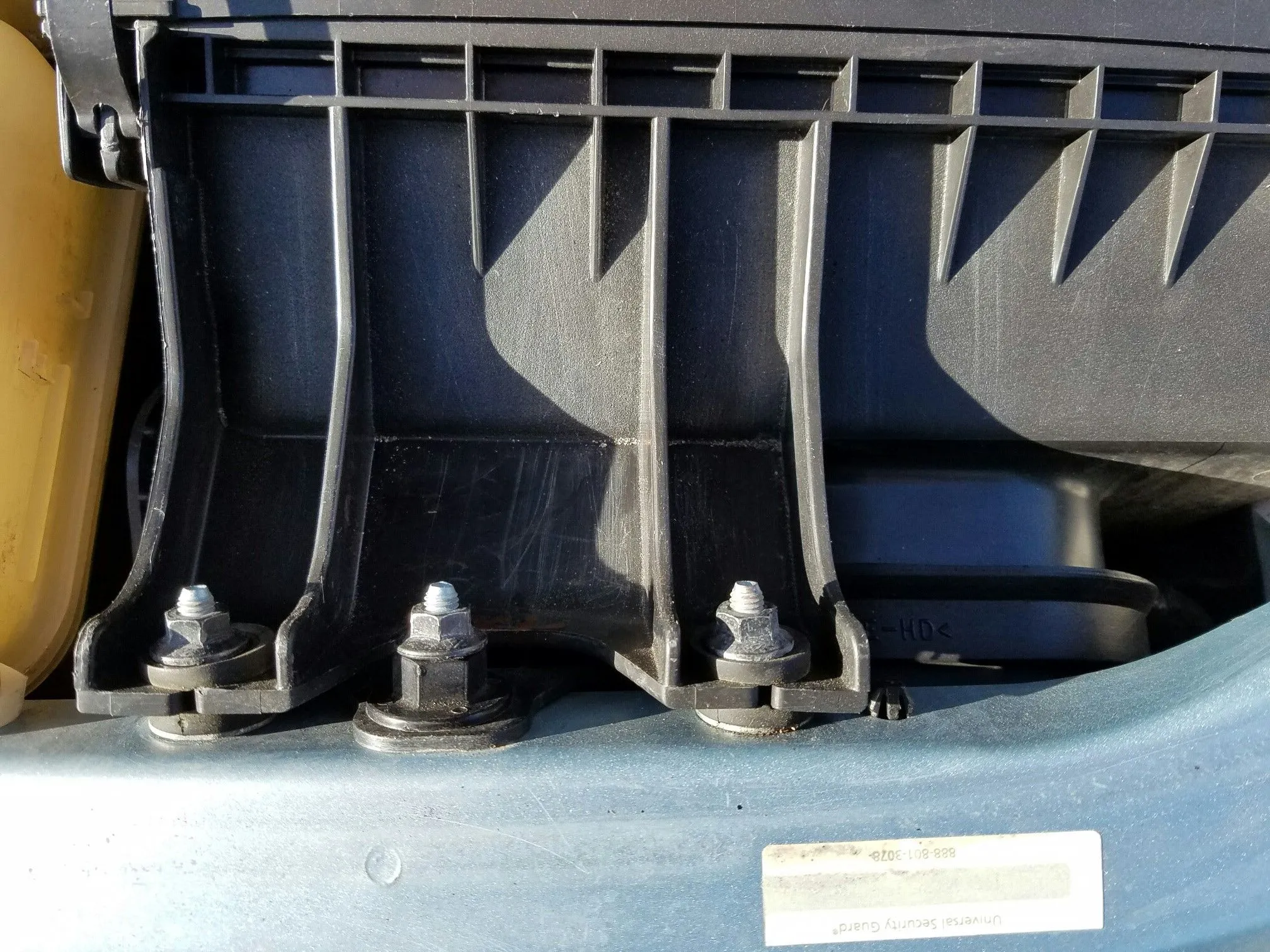

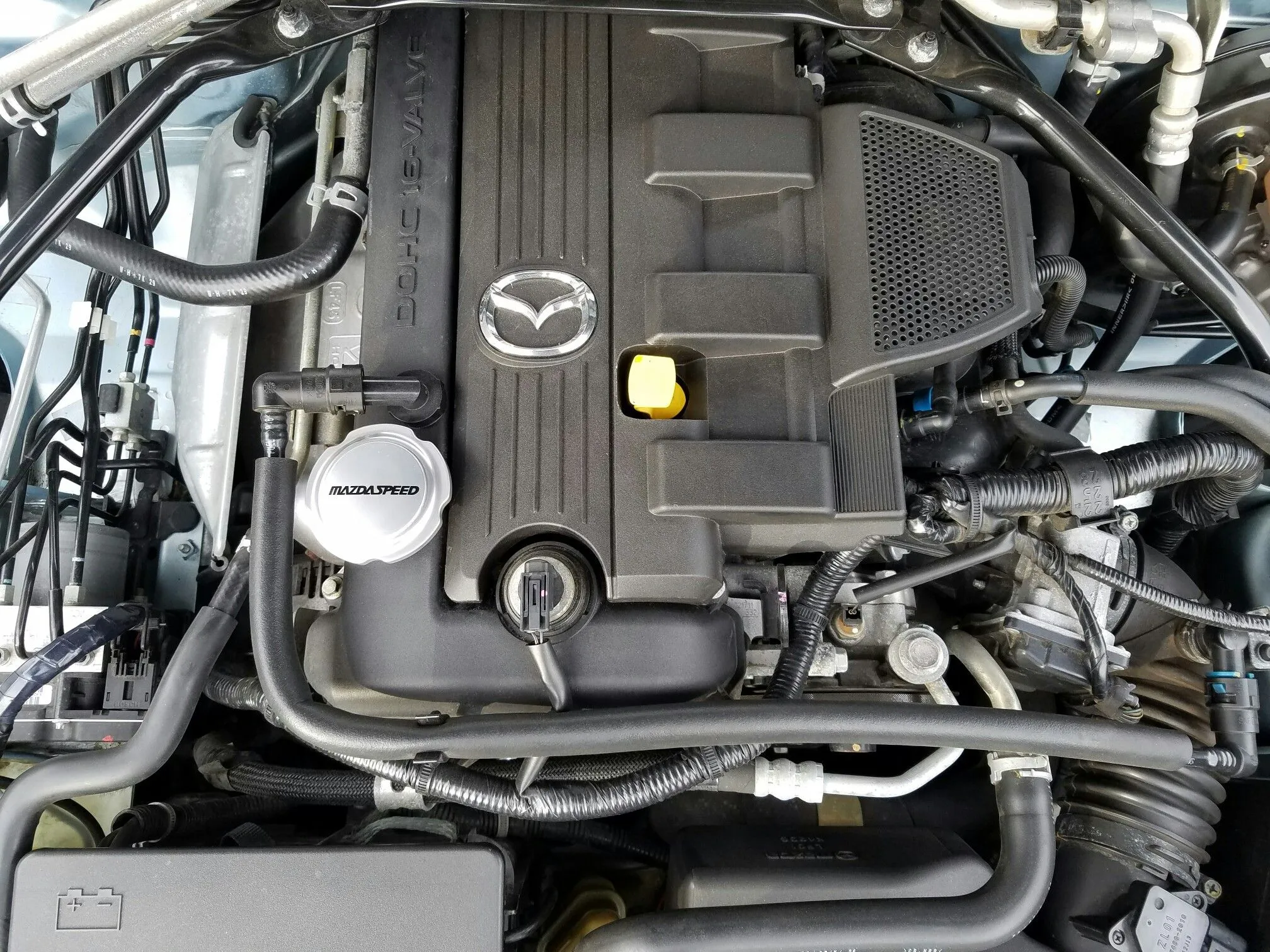

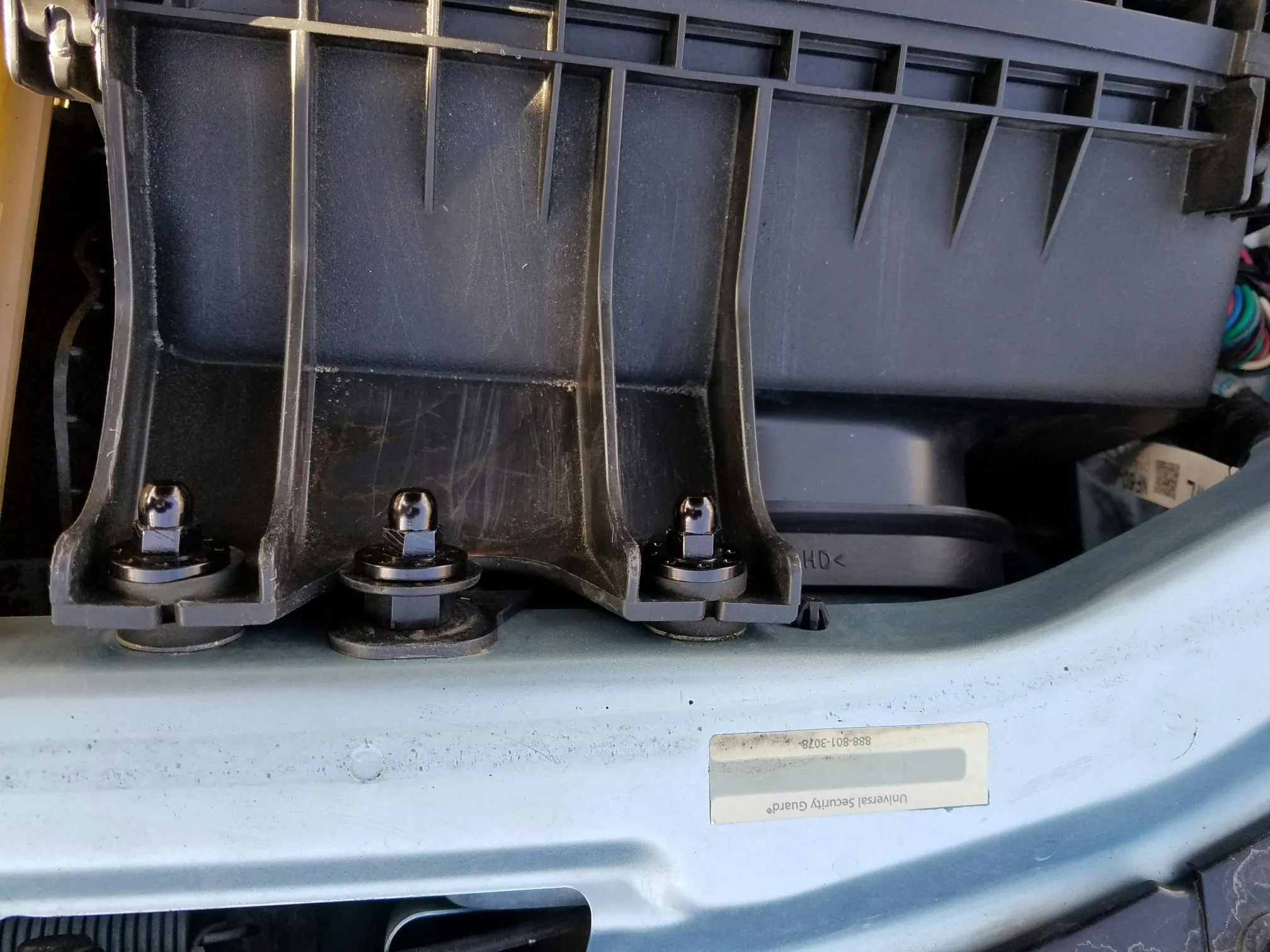

In the meantime, I've made some subtle changes in the engine bay to dress it up. First up and maybe not so subtle is a custom oil cap I bought from a member over on miata.net. I thought about buying the MS3 oil cap but they only come in red. In addition I replaced the stock nuts for the air box, coolant tank, A/C bracket, windshield washer tank and ABS bracket with aluminum flanged dome nuts from ProBolt-USA.com.
Oil Cap
attachment.php
Air Box Before and After
attachment.php
attachment.php
Coolant Tank and A/C Bracket Before and After
attachment.php
attachment.php

Windshield Washer Tank and ABS Bracket Before and After (For the windshield washer tank, I replaced the bolt with a 6mm socket cap bolt and 23mm drilled washer)
attachment.php
attachment.php

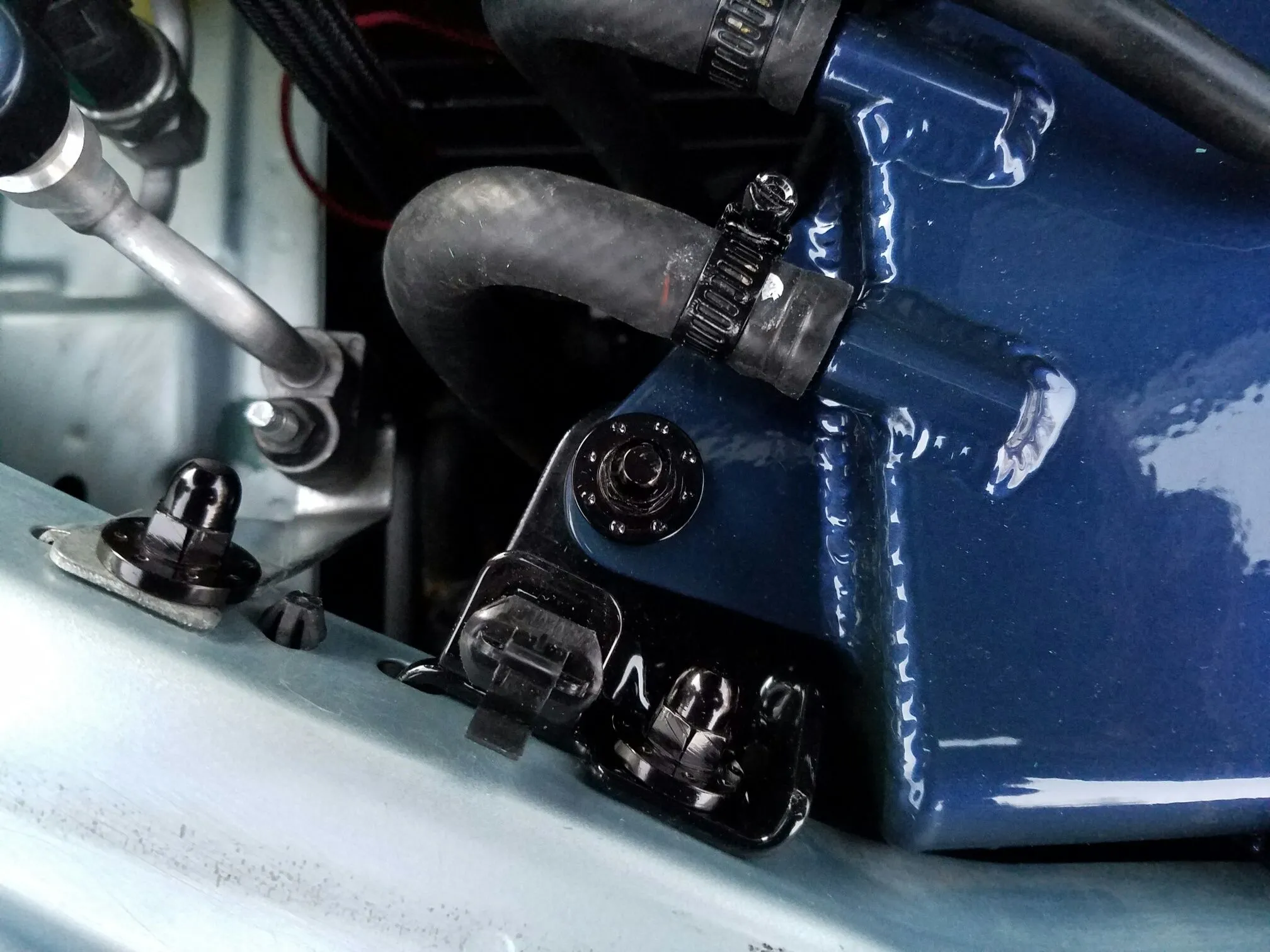

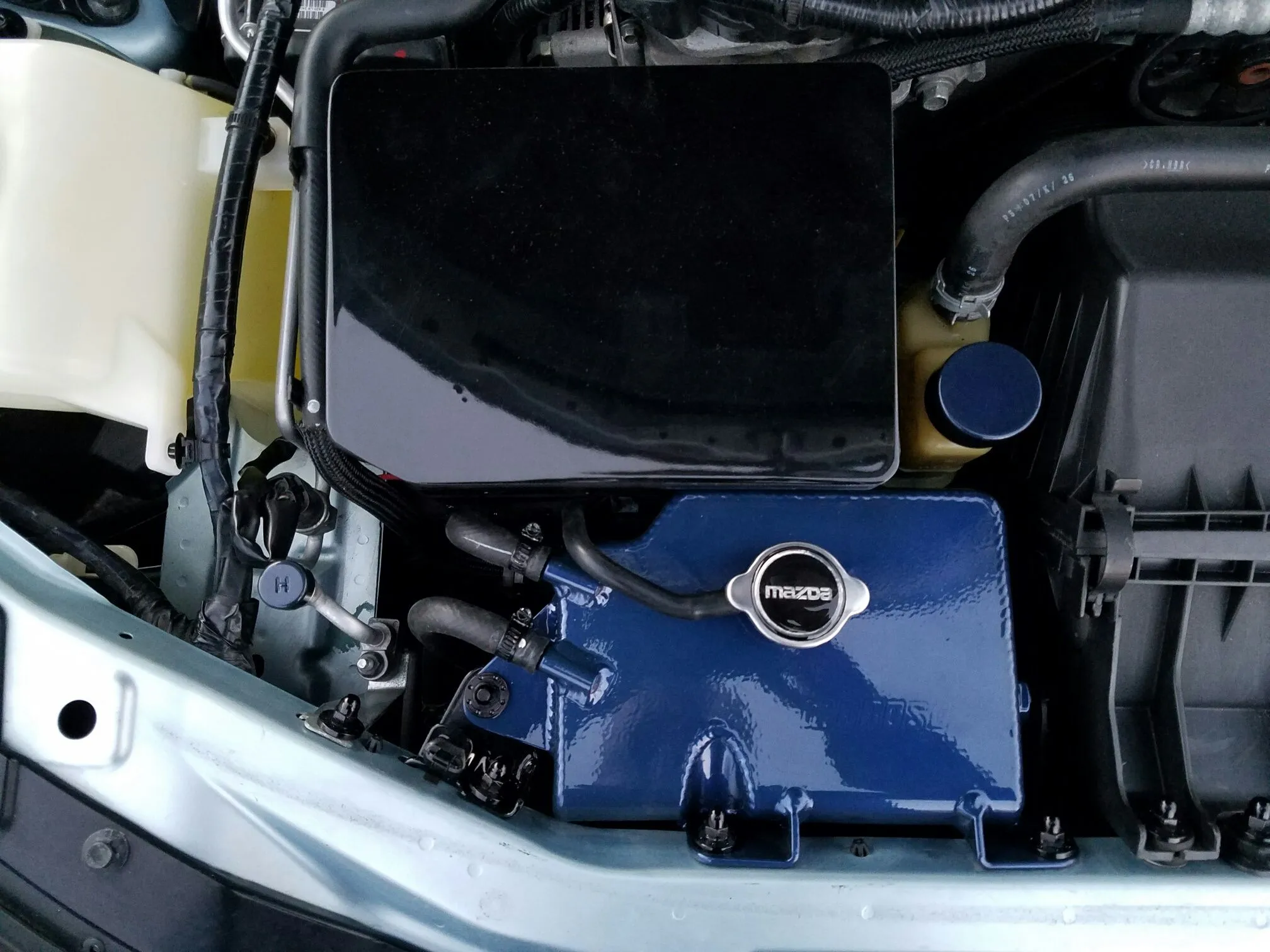

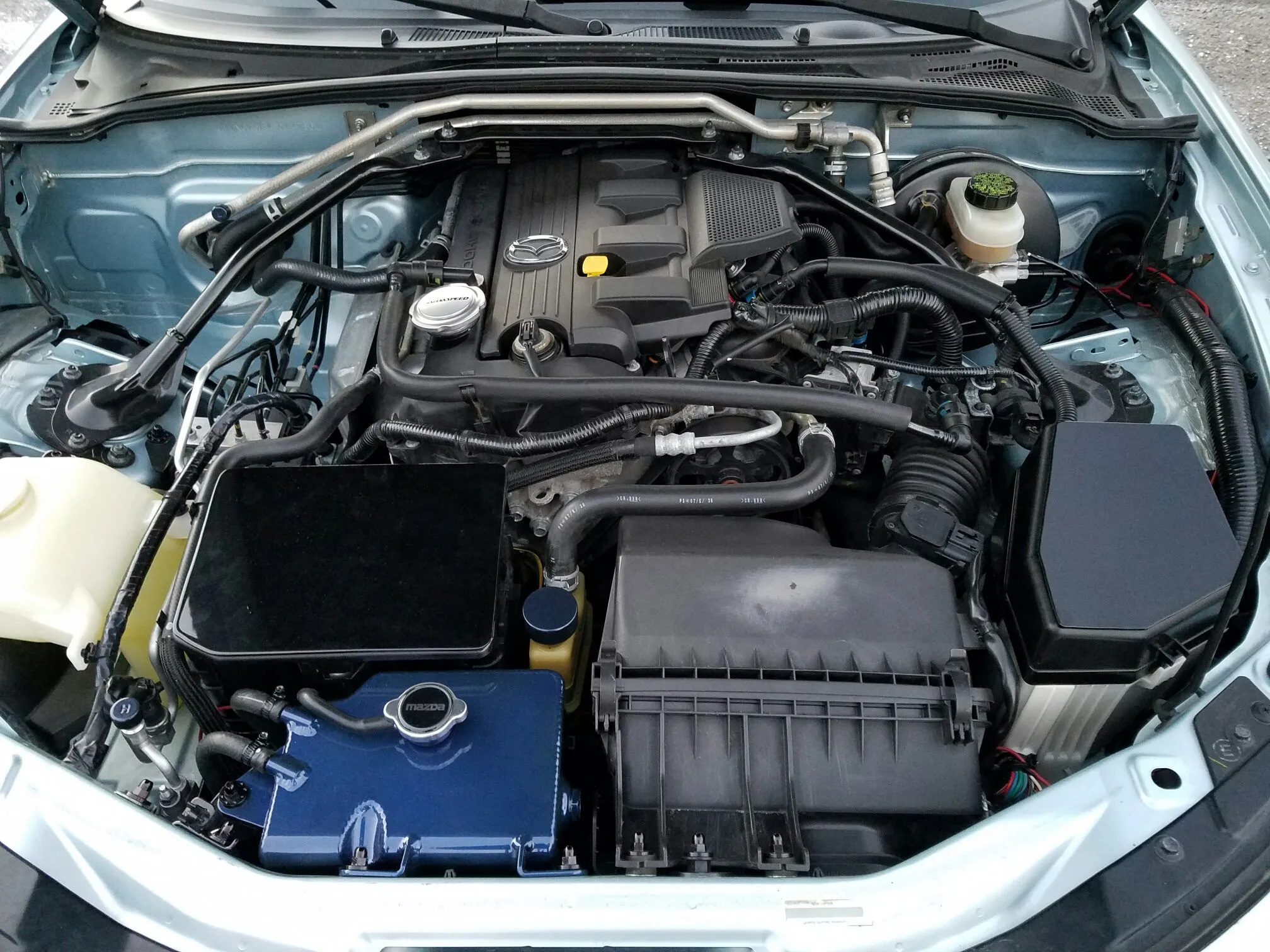

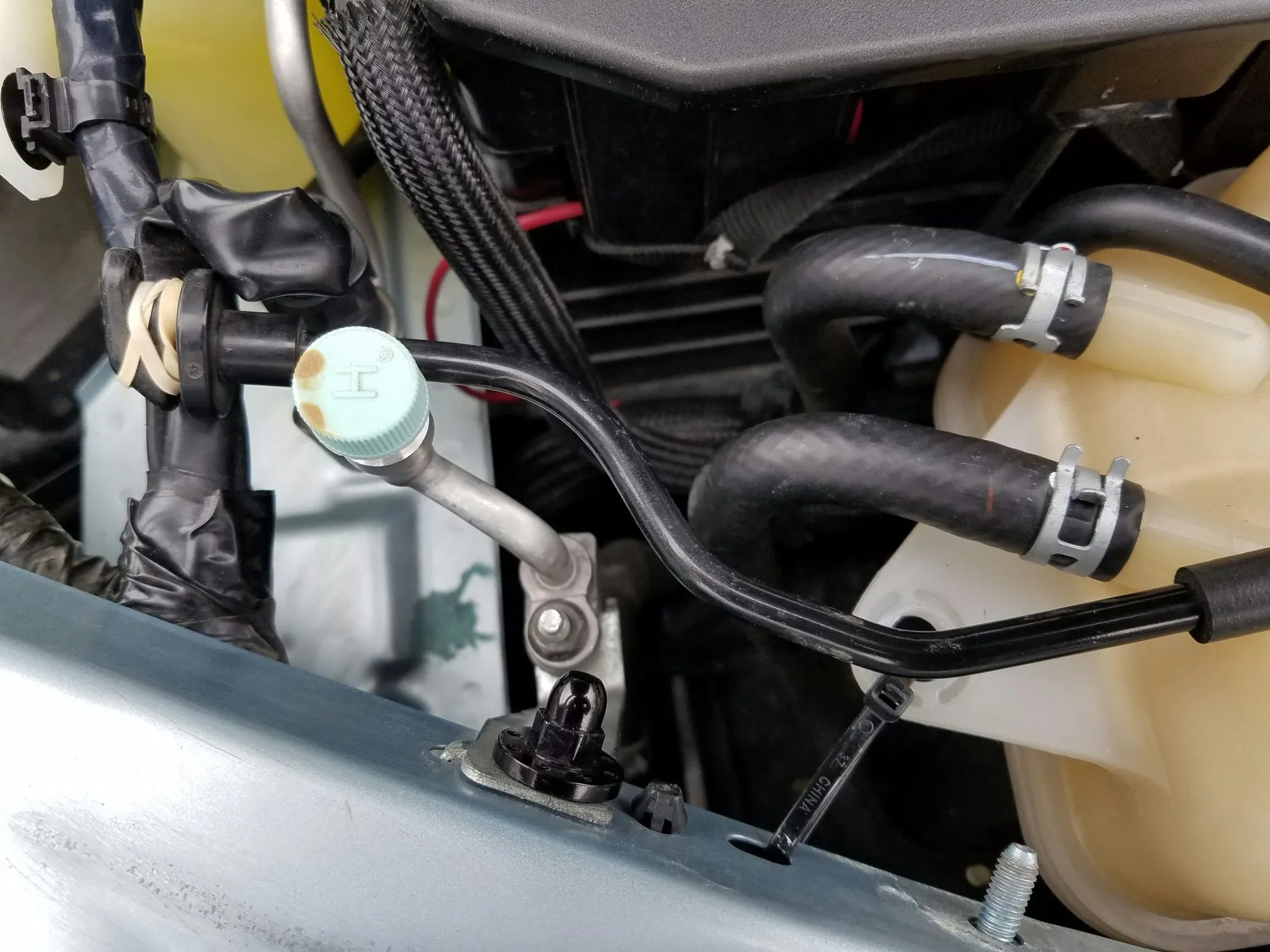

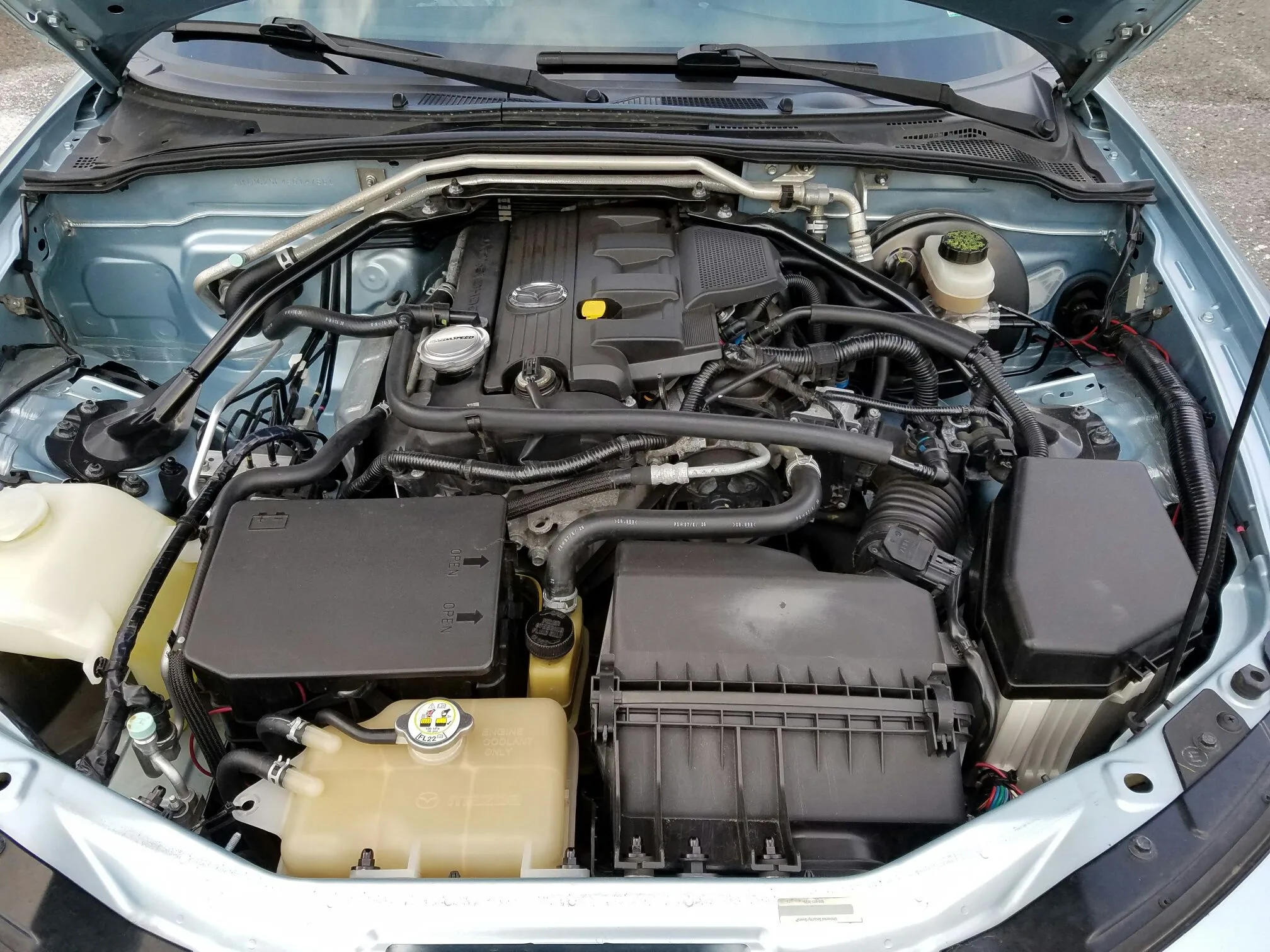

Installed the GWR tank today! It took about 20 minutes, having a siphon pump was great for extracting the coolant out of the OEM tank. Also used a torch to heat up the hoses, after about 15 seconds, they slipped right off. I used some 5/8 worm gear clamps for the small hoses and painted them gloss black. Sitting atop it, is an OEM rad cap with custom revlimiter.net M80 insert. I had the OEM coolant tank bracket powdercoated gloss black to flow with the newly installed hardware and tank. Upon pulling it off, I realized that white hood rod clip had to go. Found a black one at a local Nissan dealer. :) Next up, I ordered the IL Motorsports power steering cap cover and A/C check valve caps from Moss. I had these powdercoated Volk Mag Blue along with the coolant tank. The guys in the machine shop at work made some stainless steel covers for the plastic battery and fuse box covers and I had them powdercoated gloss black. Used some silicone to affix them. I know the stock intake is well designed, but that stock air box is killing me. lol
Engine Bay - Before
attachment.php
Engine Bay - After
attachment.php
GWR Tank / revlimiter M80 Insert / Battery Cover / IL Motorsports PS Cap Cover and H A/C Check Valve Cap
attachment.php
Zip Ties and Rubber Bands came in handy while the bracket was MIA
attachment.php
OEM Coolant Tank Bracket / Nissan Hood Rod Clip
attachment.php

  • Emilia - OEM Coolant Tank Bracket - Powdercoated Gloss Black with Nissan Hood Rod Clip.webp
