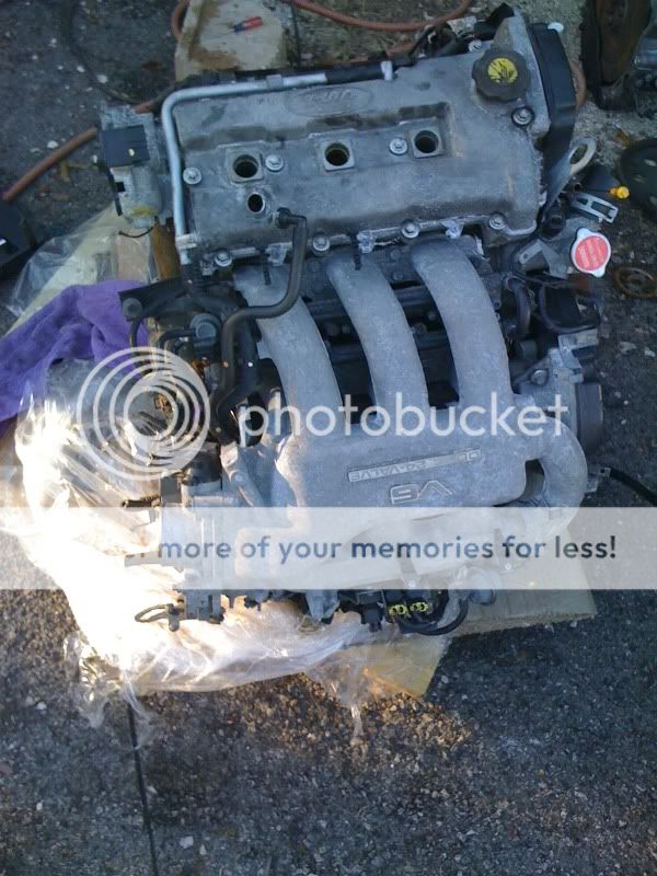

That's my engine its from 93 Probe ATX for 750 shipped with liftgate service

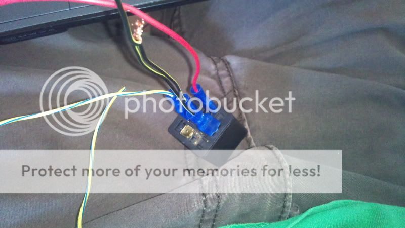

battery light fix!!!!!!
part i used about 14 bucks after tax
wired up
the explanation
i stole from
http://www.mp3car.com/the-faq-emporium/117895-faq-relays-how-they-work-and-how-to-wire-it-up.html
86 needs to be connected for a power source from the alt or a power source thats only now when the car is idling
85 ground
87a grounded to 85
87 battery
30 need to go to the battery light wire yellow/black wire and your battery light will work

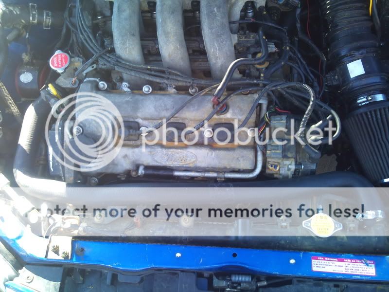

as it sits today
want to work on a ram air set up
I'm getting about 30 MPGs

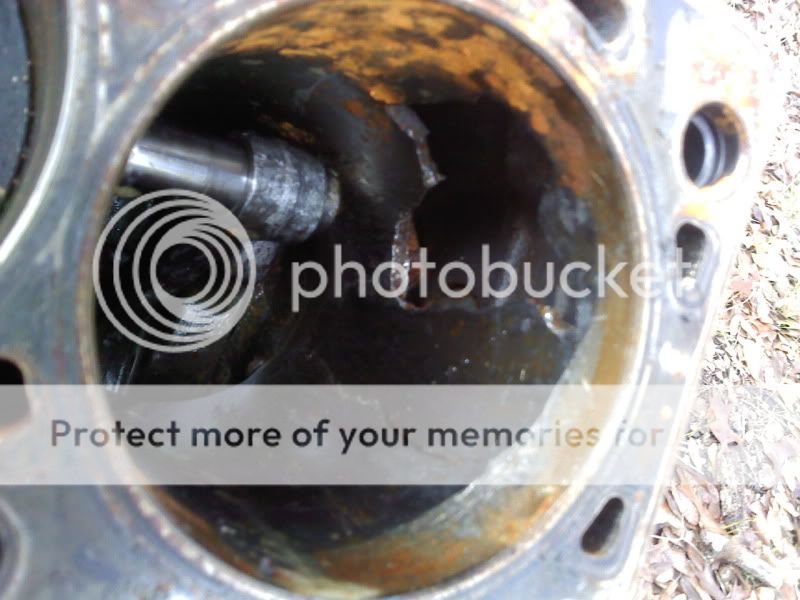

my old fsde FTL
dropped a valve which got stuck in the exhuast port and when the piston came up it cracked my block and destroyed the piston head
