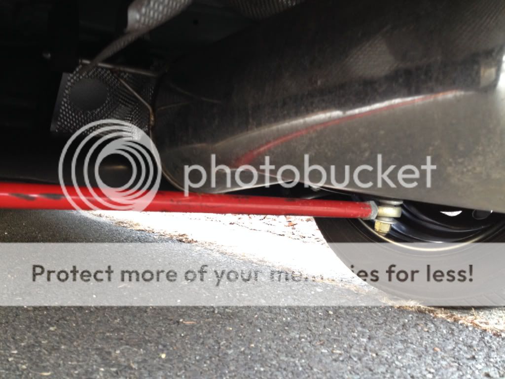

not my car, but you can see the Tripoint bar attachment points and the "clearance" issues with the muffler and the evap(black box). If you look closely you can see the impact marks on the stock muffler in this pic.
Here's the clearancing needed to get the RB muffler to clear the Tripoint bar. Does not affect sound of the muffler, whether it affects performance is unknow at this time. Dyno to come in the Spring.

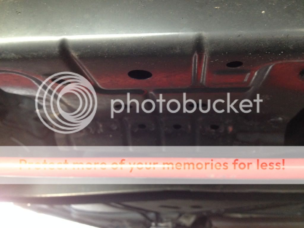

Here's the kink in the evap box. It's just the cage and does not alter the locations or damage any of the components in the cage.
