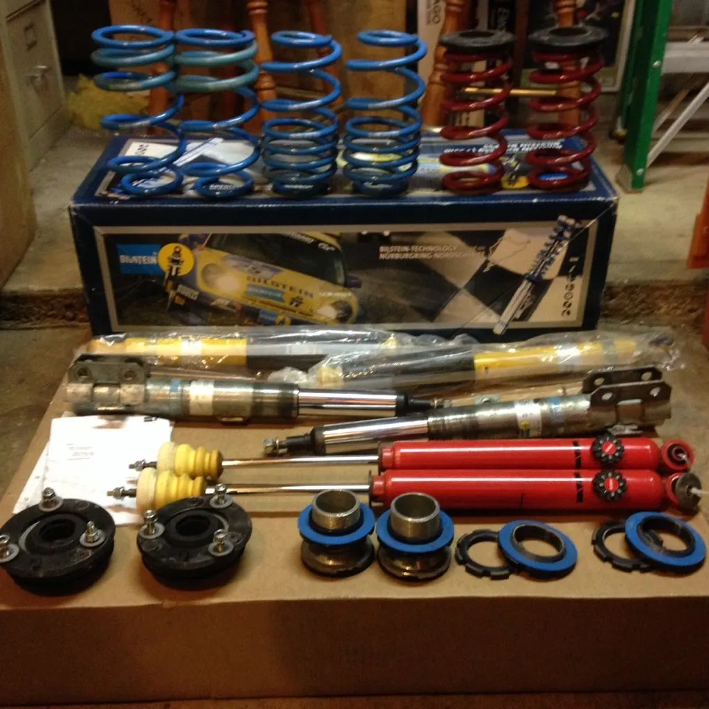

A complete Bilstein Autocross coilover kit that is 20 months old. The kit has never seen a winter on the car, but the finish on the aluminum front struts is dull. Needs a polish to brighten it up. The stickers on the front struts have been rubbed off (tire clearance issues) but otherwise in great condition. Rears were on the car for only 6 months, and then swapped out for the KYB AGX which performed much better at controlling the rear of the car.
I'm looking to get $400 shipped in the Lower 48 for everything..Here's the included parts:
Front Bilsteins with stock dust boots and Bilstein Blue springs (285#) with modified stock struts hats installed (The modified hats have a camber correction kit installed which give a fixed -1.0 gain to front camber) No slipping of bolts here. You can add a set of Ingalls Bolts to get the front camber near -3.5, but I ran the stock bolts in the bottom and a 14mm in the top to max camber at -2.5. Spring perches have been machined to accept 2.25" linear rate coilover springs which can be added by you (or I can source them and install them for you with tenders and spacers) Springs and tenders are additional $120( for Used 6" long 2.25" linear rate springs). You can pick the rate, but I wouldn't go over 400# or you'll exceed the Bilstein valving specs.
Rear Bilstein shocks with dust boots and bump stops, I don't have an extra set of rear upper mounts, but can get a pair for you for an extra $50. so they'll be a complete easy bolt in job.
also included A pair of KYB AGX Focus rear shocks. these share dust boots and bump stops with the Bilsteins, but THESE are the shocks I'd use on the rear of the car with the Bilstein fronts. I used these with the Bilstein stock springs (230#) with the rear height adjusters and the linear rate Ground Control Eibach springs (380#). I honestly preferred the 380 in the rear with the KYBs. You can choose either setup or try them both to see what you like because BOTH sets of rear shocks and rear springs are included for the $400 ... Rear springs are the perfect height and require 3 zip ties to hold them in. No adjusters needed. I had these installed all summer (before trying the 600s in the rear) and no issues what so ever.
The front dust boots are currently NOT installed and would have to be sourced before shipping.. If you want to assemble the front struts yourself, or prefer not having strut boots (the boots do NOT fit with the linear 2.25# springs), I can take off $25. Other than that, you are getting $1200 worth of stuff (all bought brand new so I'm factoring in a ton of depreciation here) for 30% of its original value.
Sure I'm taking a loss on this setup, but it was worth it. I'm passing it on to someone who will install it and appreciate it. It's a great "bit of kit" as my buddy Michael says, and hopefully you'll enjoy it and have the same success with it as I did.
