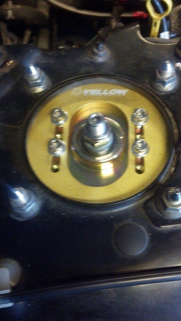

Coilovers installed...correctly this time. (headbang)

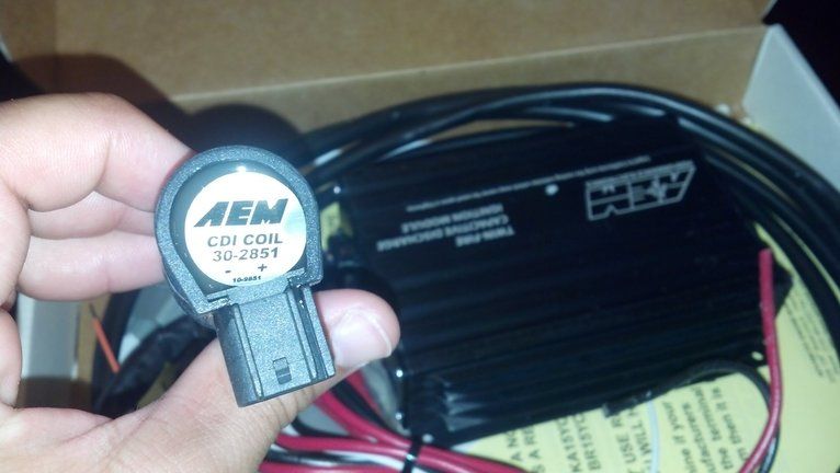

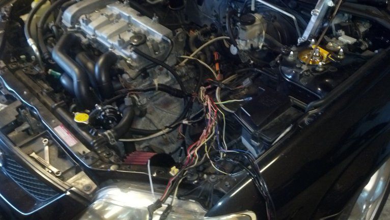

Started to redo the wiring harness and wiring the AEM ignition amp
coilovers aren't installed correctly. they need to be turned 90*. currently your adjustments are set for caster.
Yeah, I realized this after initial install. Installed them correctly this morning. I'll snap a pic in a second of the corrected version. I was getting impatient last night with all the rusted bolts and the endlinks being a pain.
Sorry for the lack of updates, been doing a lot of work and spending time with the family. But there is a slight update, I'm continuing the wiring slowly and hopefully I can have that done in the next week. But while I had the intake manifold out I decided I was going to smooth out all the post and ended up punching through a runner. I'll snap a pick in the morning. I had an extra laying around so I just finished repainting it after porting it.
