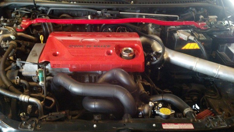

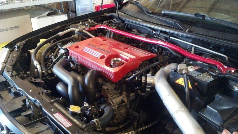

Sorry for the lack of updates but have been busy with the family. Have a 2 month old and 3 1/2 year old so car has limited time to get worked on. But to satisfy here are some pictures. Plastic cover is there until I can get the valve cover powder coated and the IC piping painted. Then I'll be going gold and white.
Them lights look good
I love them, but right now I've been admiring them on the book shelf. Have all the bulbs and all to install but trying to finish the engine bay.
Looks pretty good. How soon till its on the street?
Working on the map right now but I'm waiting on an AEM ignition amplifier and CDI C.O.P's in order to fire. Hopefully within the next couple of weeks.
Love that mani... Sick! You're gonna want to wrap that upper radiator hose...The heat even got to be too much for my samco unwrapped.
I plan on doing that once I replace the radiator with the Mishimoto. I honestly didn't think about it possibly melting.
