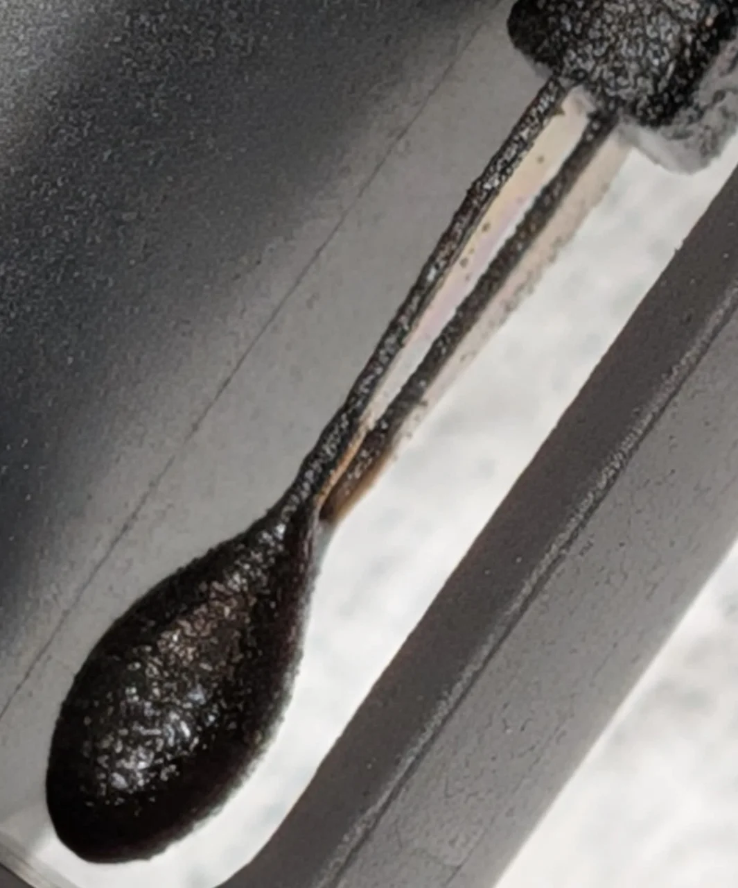

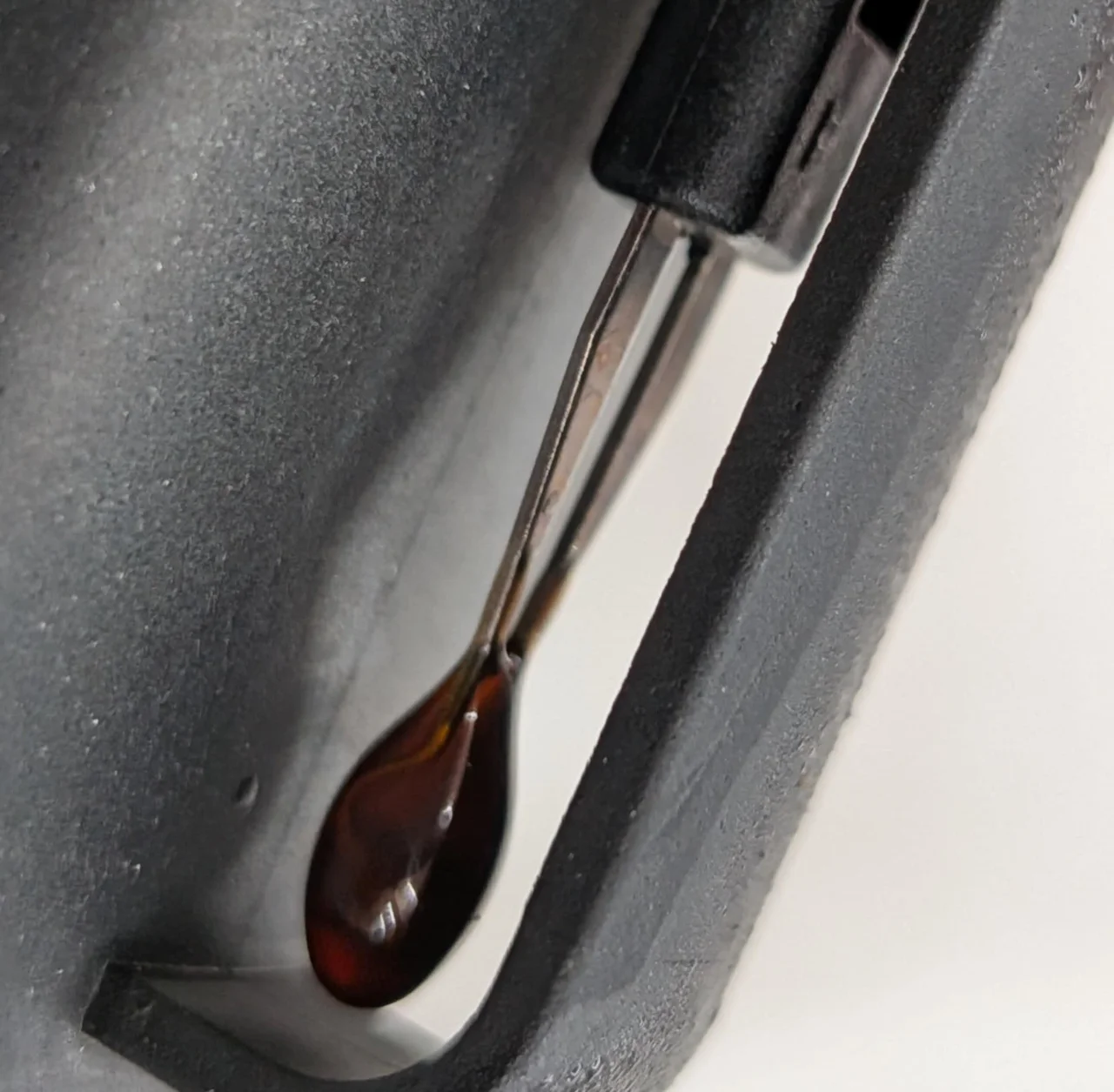

Sounds like worth cleaning the MAF (mass airflow sensor). You can do it easy, with a screwdriver and a spray can of MAF cleaner. YouTube has clips for how-to.
Ran to the auto parts store over lunch. Picked up some MAF cleaner.
Before:
After:
Also put in a new air filter.
Took it around the block afterwards.
Massive difference in drivability. Thanks so much for the tip @dlarkin_dc
