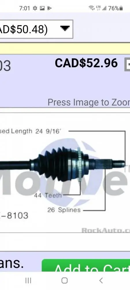

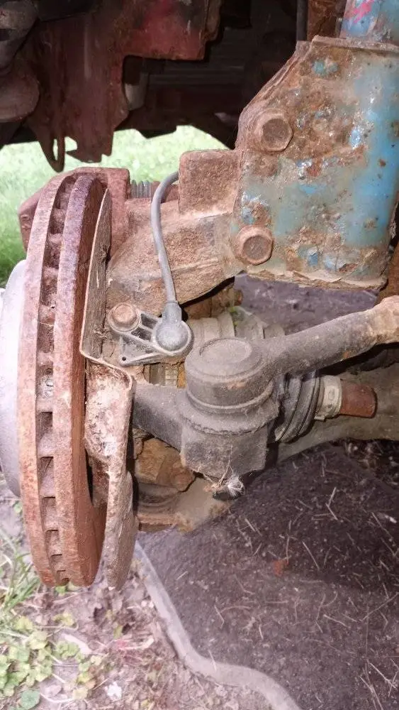

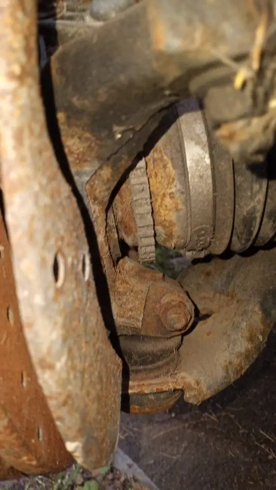

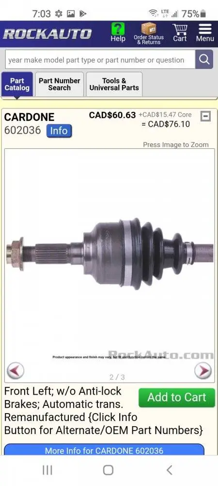

My parts car has a toothed ring and sensor on the CV joint...
It has ABS.
Cars that have ABS, have a toothed ring on the CV joint.
Cars that don't have ABS, don't have a toothed ring or sensor on the axle...
Upvote 0
Cars with ABS have 44 pulses of info for every rotation of every tire.
Cars without ABS get just a few pulses of speed info from the rotation of the axle...
That's why they use ABS info over axle info when available.
It's way more accurate.
Upvote 0
