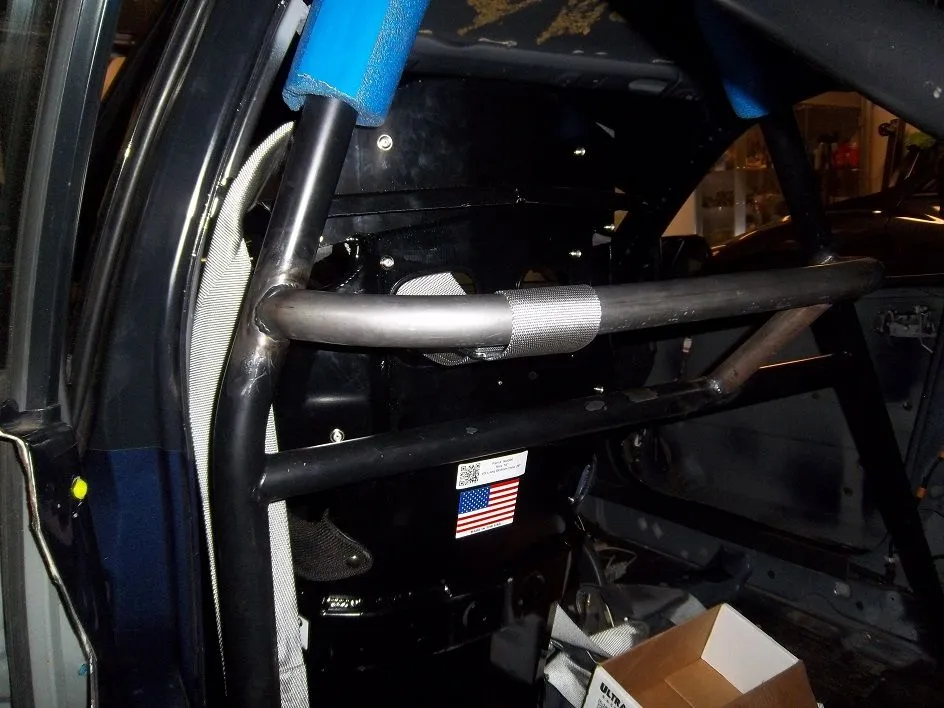

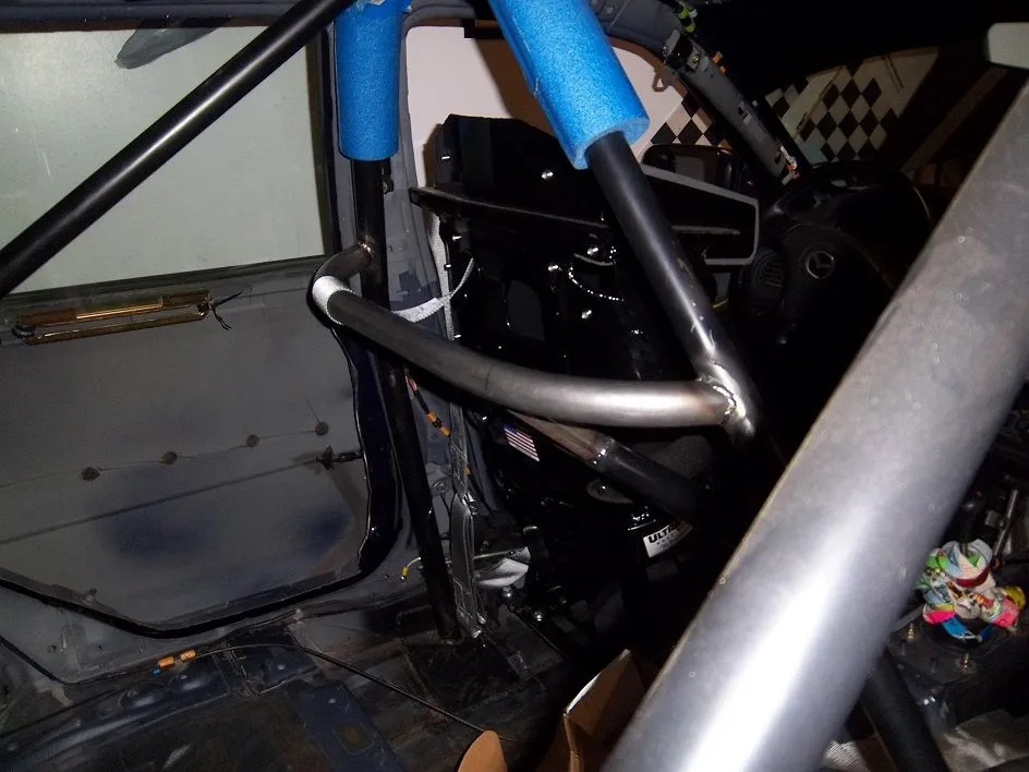

With all the stock brake components being replaced and a couple heavy seat brackets removed its now about 2156 completely empty. So add 1/2 tank of gas and my fat ass of 180lbs. Oh and add some new roll bar.....
attachment.php
attachment.php
So that and a bit of paint I just might be back up over 2170 empty again. Witch reminds me I will need to get corner balanced again.

Is that weight with you in it?
That is without me. It is probably around 2,600 with me in it and I usually autoX with a little over a 1/4 tank of gas.
Nice! Are you usuing a fuel cell then or the stock gas tank?

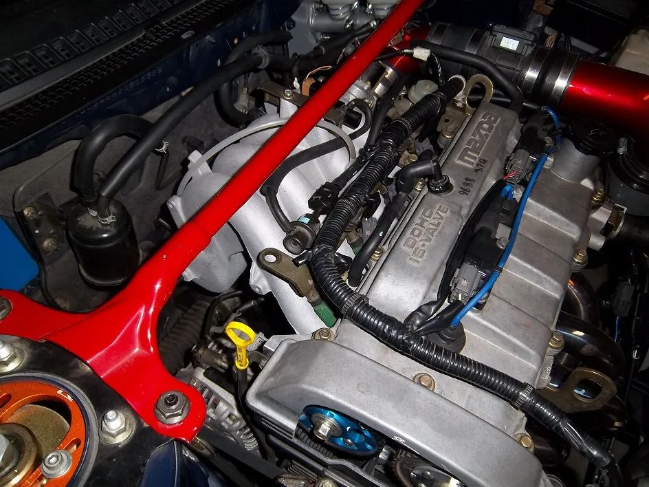

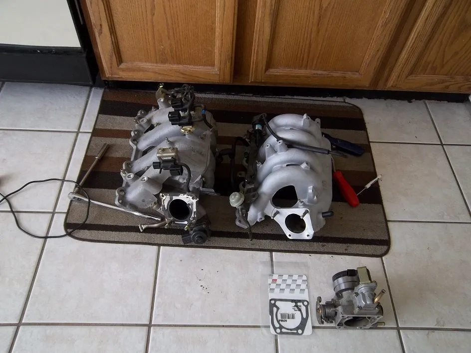

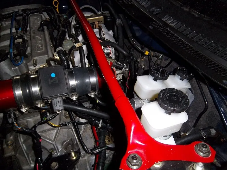

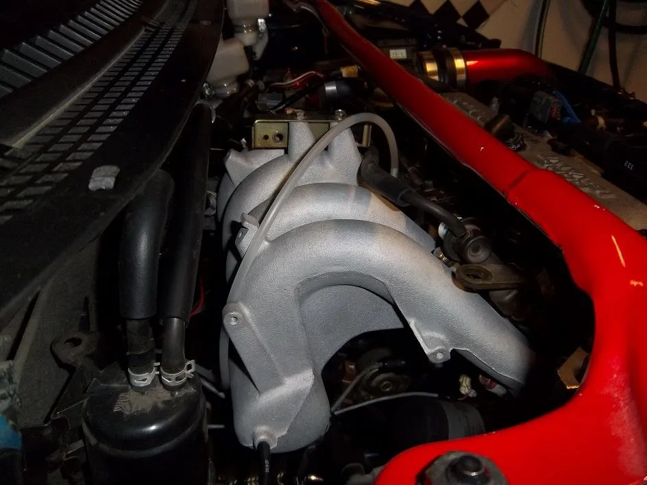

So great news... Car wont start. Tuner says its the microtech. All I did was swap out the mani and cut off the vtcs and vics and the stock knock sensors. I dont think that has anything to do with the starting functions. And the file name was wrong. So I uploaded the forth slot (my tune) and the name came back wrong. Also the water temp value is not showing up. I run the test and the injectors are not firing. They have power to them and the coils are good. Cant figure it out. Thinking of getting a block heater, but it seems like a band-aid to a real problem. Not sure if I want to send this microtech back to au or if I should just buy a haltech.

Just wanted to get this last tune and be done with it. Was looking forward to a full year of nothing but racing. Now I am not sure what the **** to do. I feel like lewis7789. This just became not fun anymore. Should have bought the VanDemen.
