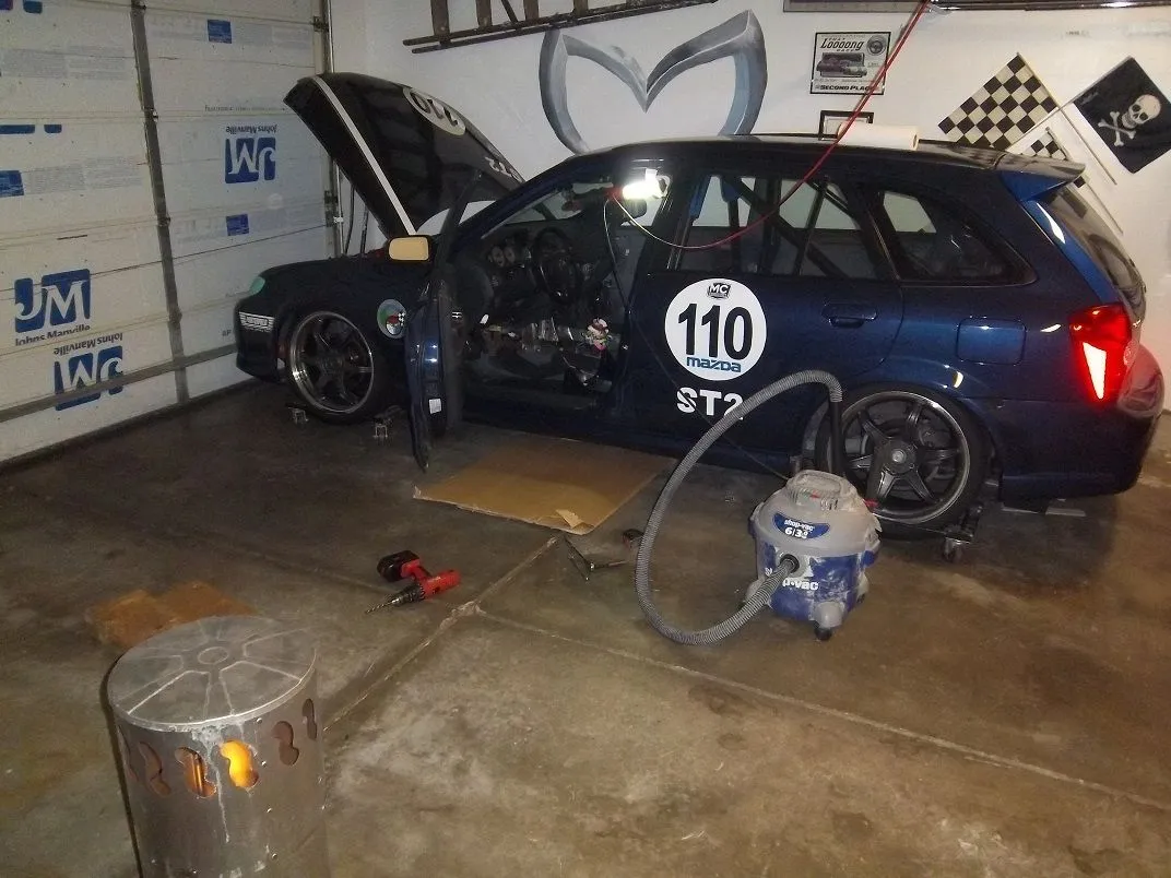

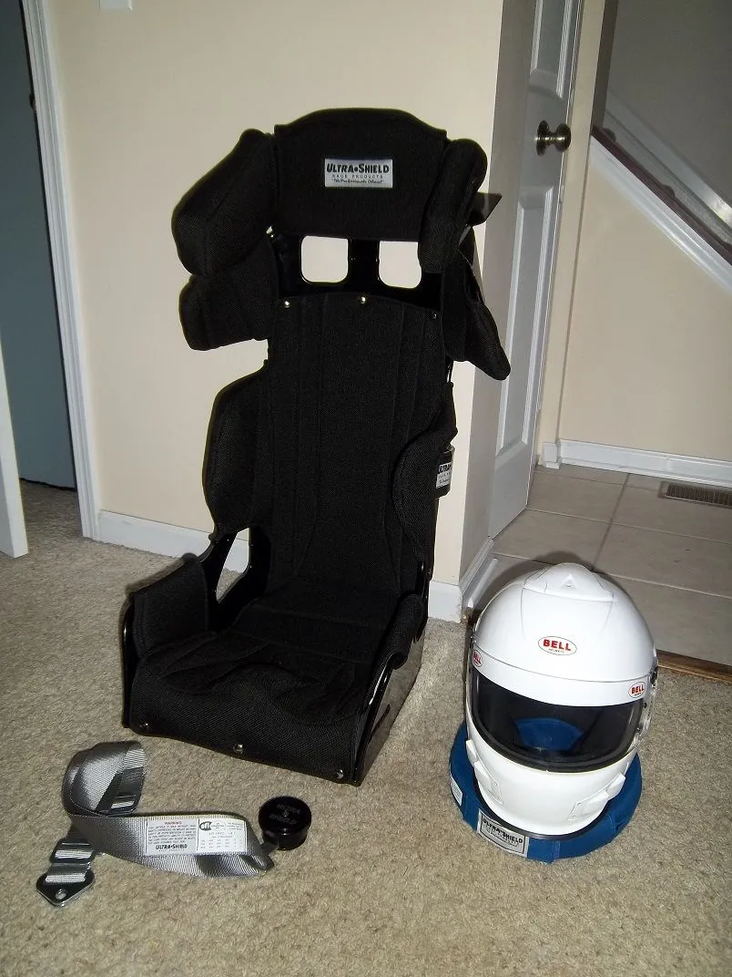

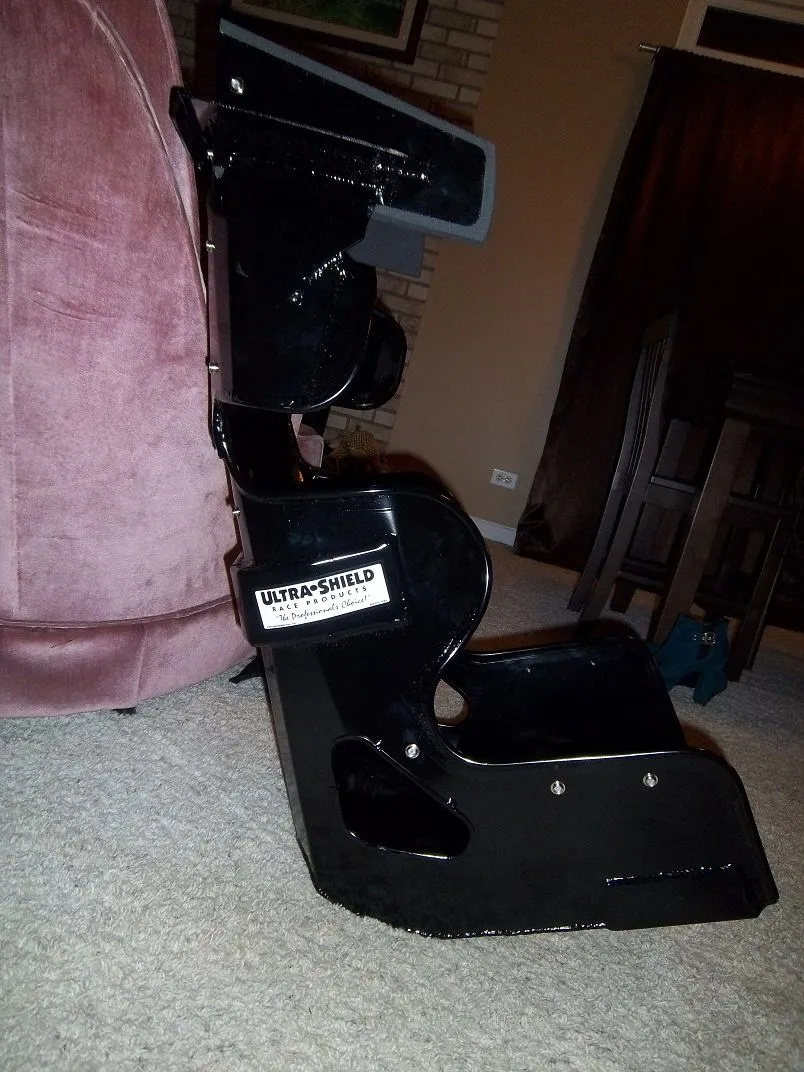

Got a lot going on now. Car is at the chassis shop getting a new harness bar installed for the new seat. I just wish I new 9 years ago before I bought that sparco seat that the harness holes where way to low for me. Guess that is the last straw to make me never go back to northstar motorsports amongst a few other things they have or not have done before.

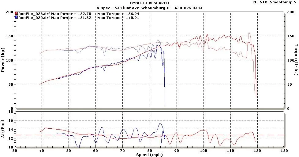

Like I said before I got the vics working perfectly. Some good and some bad came from that. Tuner showed me this.
attachment.php
The bad.... now the bottom end is doing the same fluctuation as the top end. Unplug it and it went away. So to test it one more step I retarded the intake cam back to 5* and found that the mid range came up about 5hp and lost the top end about 10hp. So I don't think its the cams doing this. They are responding and in there right. The good.... It is showing me that the motor might be getting choked out by the intake manifold. Its the only stock thing left (besides the throttle body). So I ordered a 2000 626 mani and will be putting that in before the weekend. I am hoping to get rid of this crazy vacuum pulsing and be done with this. Dyno time is extremely expensive.

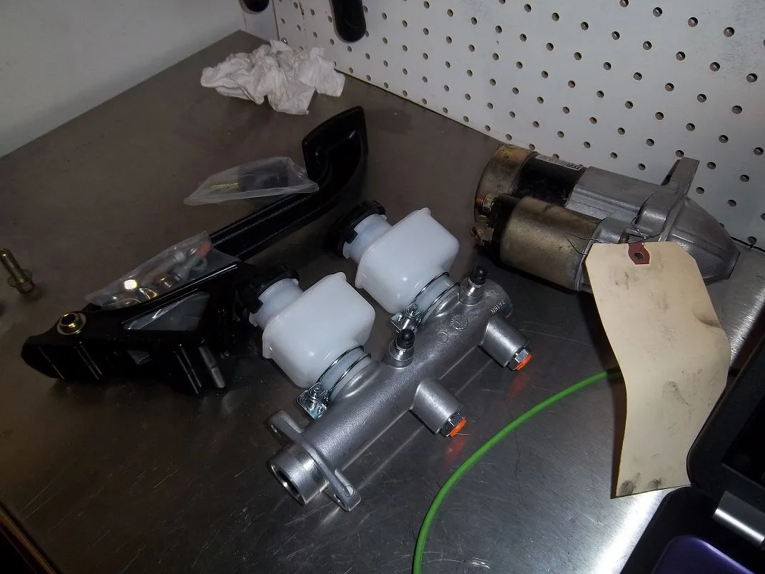

Also I am on my third starter (stock rebuilt twice). I have a feeling that this little motorcycle battery is not up to the job when its cold out side. When warm... the CCA is just fine. But never the less another parasite on my wallet.

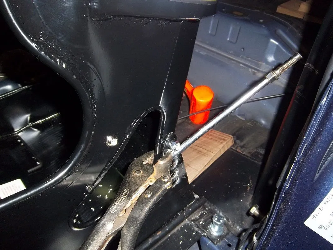

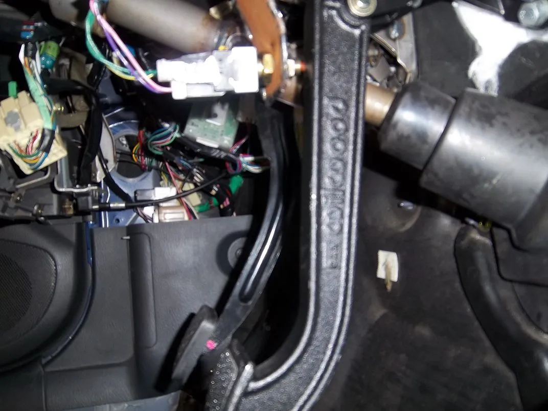

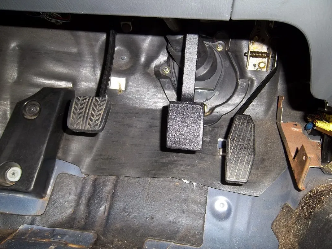

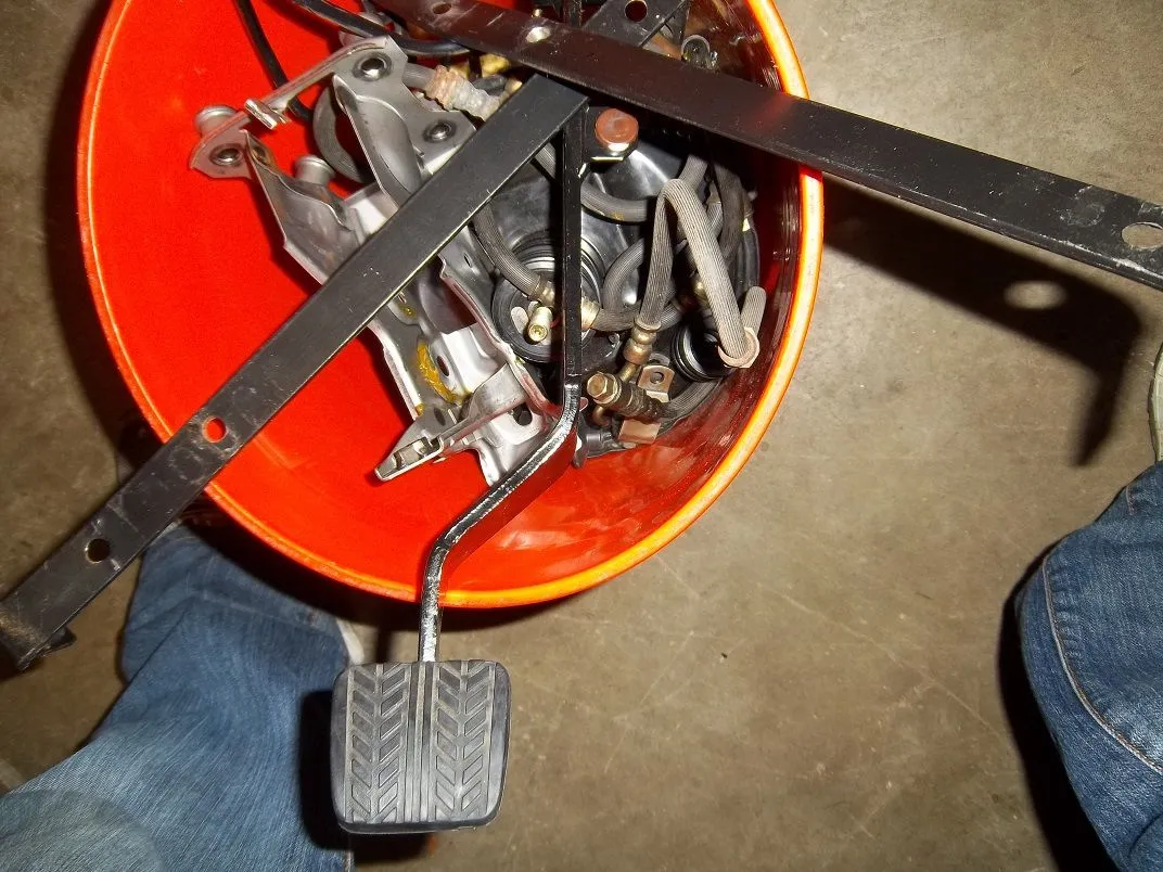

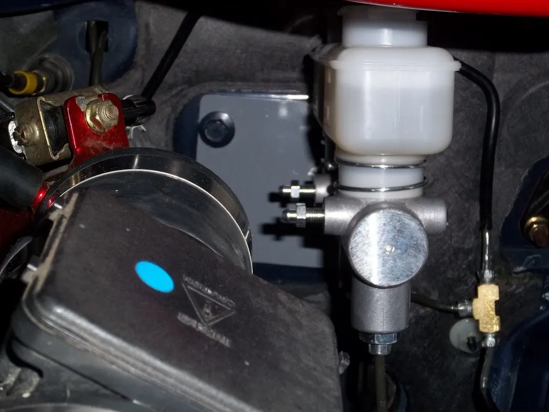

I have a good feeling about the brakes. With the new pedal installed and the larger bore MC the pedal feels almost stock! No need to have the car running to make them work is a huge comfort to me. As I have been towed in a few times and with out power to the brakes its not a nice thing to deal with. On top of that I am also eager to have the same braking response in every corner time after time.
attachment.php
Forgot about the bend in the pedal. And yes that bucket of parts removed is getting quite heavy!

Asking if the cams were measured at the same lift. Stock cams were measured at .003".
To compare the cams they both need to have been measured at the same lift :)
