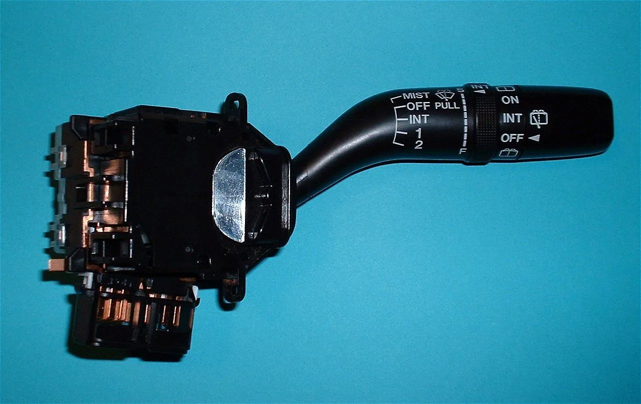

I bought one off Mazda recycling or something like that. Its basically an online Mazda junk yard. When it came it felt like there was sand in it when I turned it, so I took it all apart (took some time and patience) and regreased it. It works and looks perfect now. I dont remember how much I pair, but I saved a few bucks not getting it new.
I got one at the local junkyard for $30.
Not bad huh :D
I got mine from Mazdastuff.com over a year ago....in vact until I contacted them they didn't even know it would work and they didn't even list it on their site.....but after "THE MAN'S" post about them that long ago and the how to he once had up I got mine....in fact I did the mod on both our P5's ( mine and my wifes). you can use any year from 99 up....as they are all the same. and it litterly a 15 minute job....just a few screws to take the column cover off...and two screws that hold the stalk on....just unplug it, plug in the new one and reinstall the screws...
works like a champ.

just got my new stalk today and threw it in....so happy to actually have real wipers now.....i got mine from my brother-in-law. he works at a local junk yard and scored me the stalk free of charge...it is nice having hook-ups.
also i am thinking of throwing together a little how to just for anyone who is scared to do this....i know there is a topic for a how to but there are no pics....what do y'all think?
