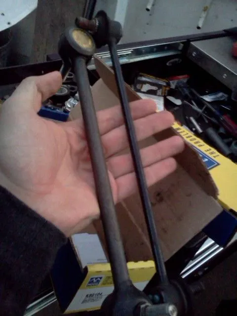

You can use a V6 oil filter on an FS, for more oil capacity. All the others are mostly covered. The MSP/MP3 upgrades to normal proteges should be a given. Escape endlinks are a good one, I have them. I believe for a rear wiper delete for the P5 you can use a plug from an Integra. 90s Accord lip fits the P5/MSP bumper.
I haven't done the end links yet, but is there a noticeable difference in handling? And what year escape, I can't remember.

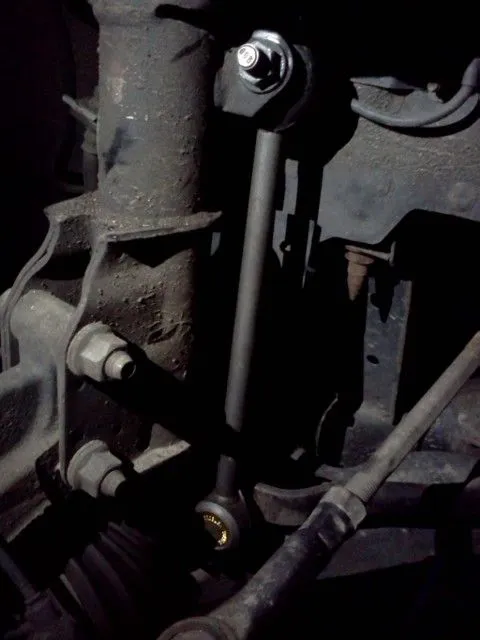

endlinks totally worth it. got rid of my terrible clunk as the front left stock was busted. much beefier.. as pictured..
photo.php
moog. rockauto.com for a decent price. 2002 ford escape.
