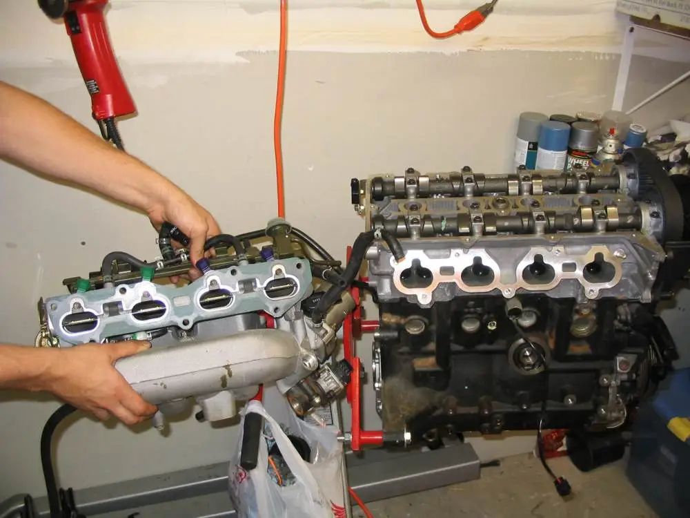

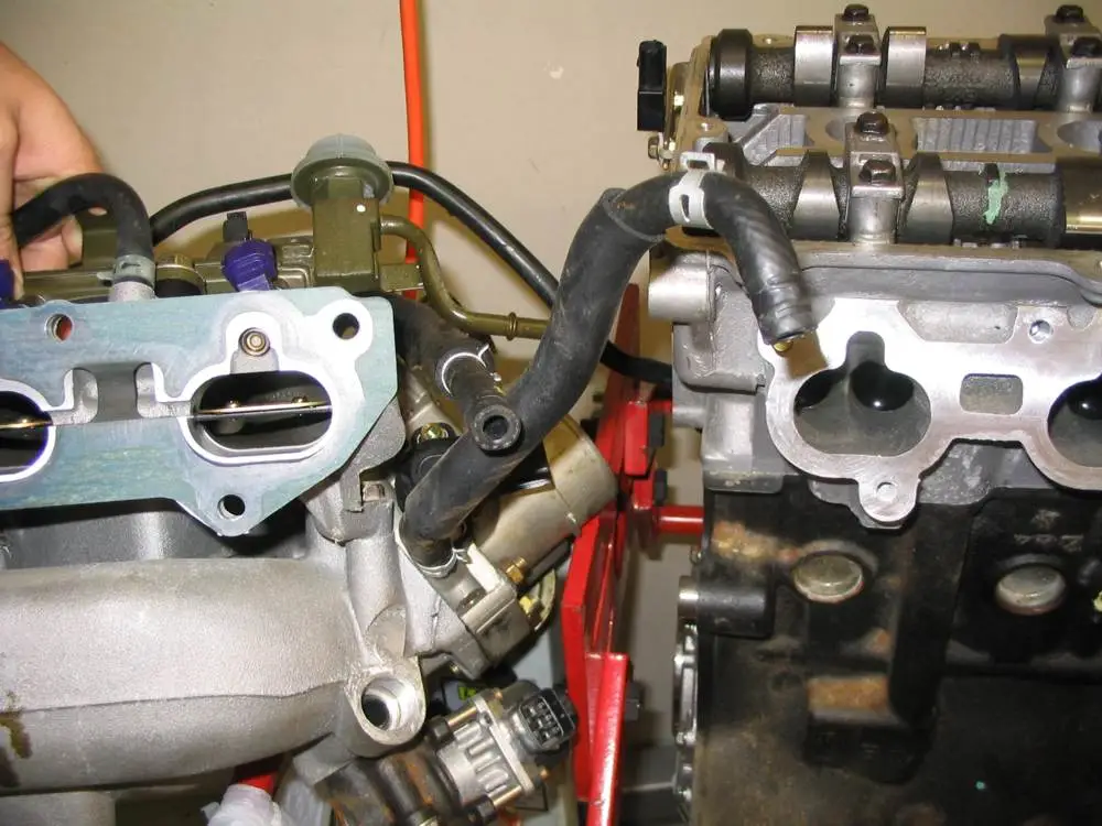

Here is a comparison of the head and intake ports side by side... definitely some discrepancy :)
I will take pictures tomorrow of my head , when I go to the shop. We did knife edge inside and we ported so that there is no hump left.
Really Sweet!!!!!!
What portion got knife-edged?
BTW.. the pics up top are of both completely unmodified head and IM.
I know, I was gonna show what a ported head is like. The walls between runners in the head have been knife-edged.
Gotchya... that will be interesting to see... I'm still debating if I'll do mine myself or have someone do it... I need the best I can get... so I lean toward paying the 75-100 to have it done and know that it is done the best it can be. But don't know yet!
Look forward to those pics!
