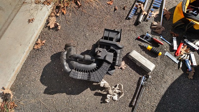

if you didnt do it already, remove the intake resonator chamber that runs under the airbox over in front of the drivers side wheel. its held in by 3 bolts and you'll have to drop the fender liner on that corner to get it out. I dont think the van really feels any quicker with it removed (the chamber acutally does not seem very choked up), but that chamber cancels out a lot of noise. Sounds a lot better without it.
Im going to cut the bottom of my airbox to open it up some more and go with a k&n drop in and it should sound even better.
Probably 90% of the performance of a short ram intake kit for a fraction of the cost.
I wrote about this a while back so it's somewhere in here but at any rate in a nutshell. I tested a K&N cold air, short ram, drop-in with resonator, drop-in without resonator and my findings were that the best option was a drop-in without the resonator based on my butt dyno. I actually went with an AEM dry flow drop in because the oily K&N filters eventually gunk up your throttle body so much that you will start having a rough idle until you get in there and clean it up. The cold air and short ram intakes are way to free flowing for everyday use of our 5s and kill the back pressure these things need to get going.
