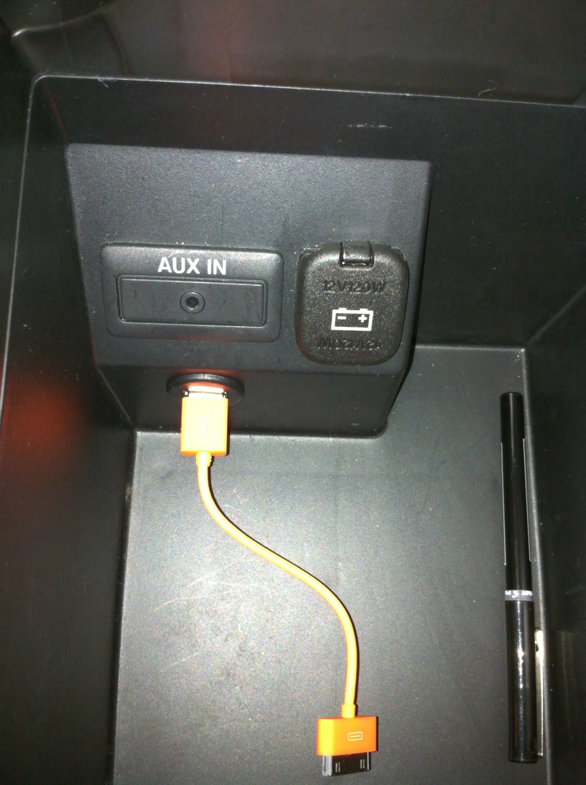

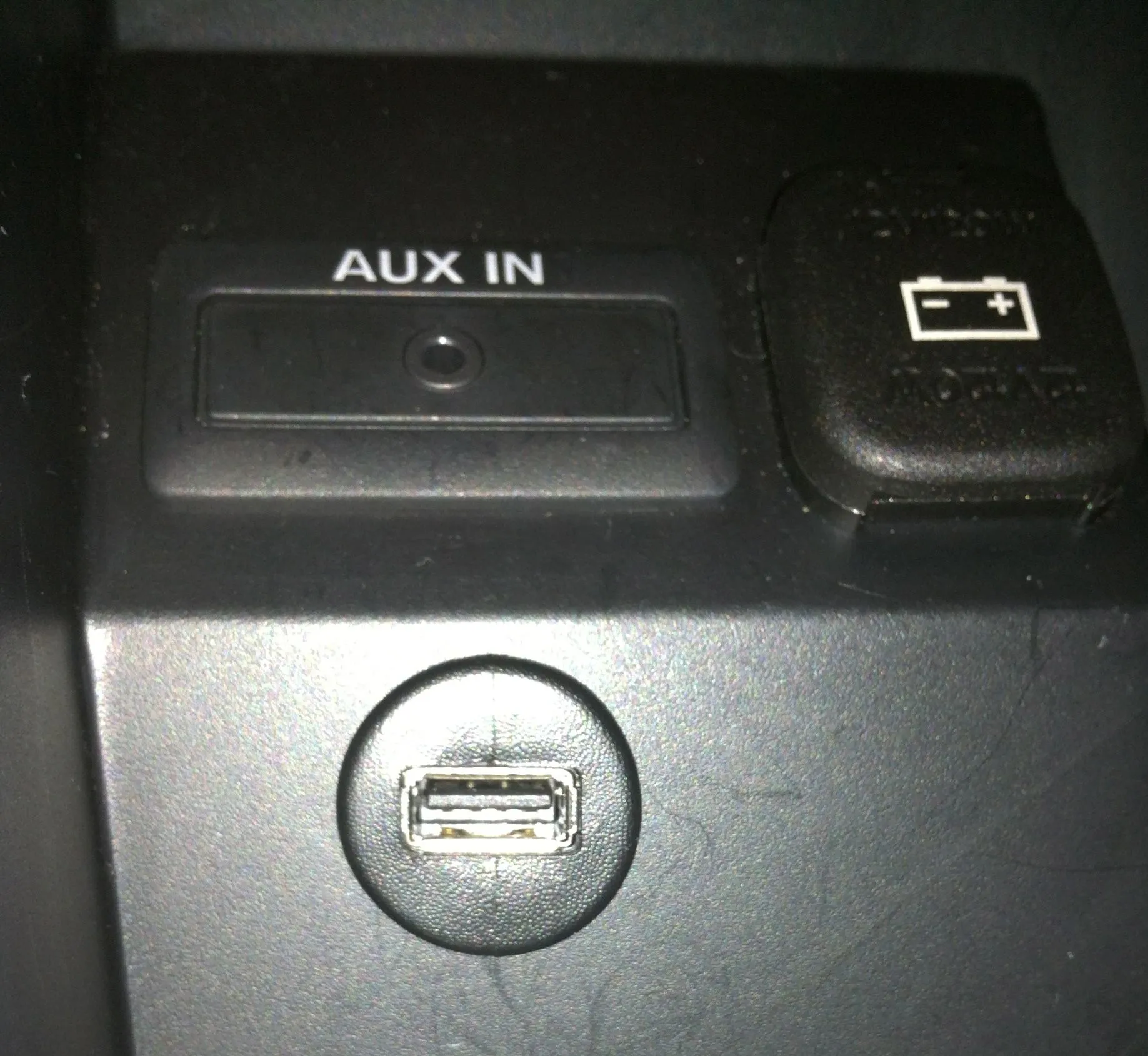

Thanks for the advice, saved a longer install. If you want to go one step further, I headed to BB and picked up a usb port from the auto installers (you have to remove the inline resistor). One hole later and my center console now has a usb port.
