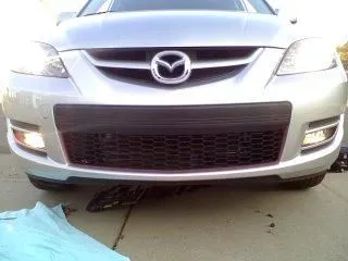

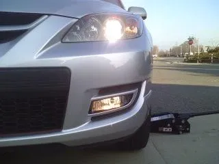

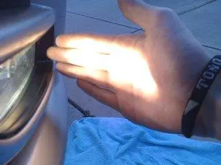

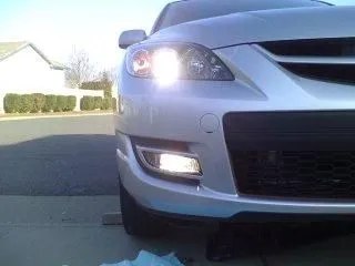

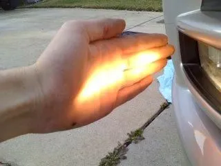

Installed! These are the DDm tuning lights. Apexcone. They are 35w 3000k hid kit. EAAAAAAAASY install. No need to take off the bumper. Had plenty of room if you just take off the entire mud/water guard from underneath. The middle part. It gives alot of acces to those fog lights area.
The pics are comparos of the HID vs stock. You cant tell THAT much cuz its day. but tonight i will get some more pics...the one on the left (lookin at it but its really the right fog) is the HId and the other is a stock comparison. At night they are very yellow, kinda like the OP. Will get pics.
pic 1 hid
pic 2 stock
pic 3 stock
pic 4 hid

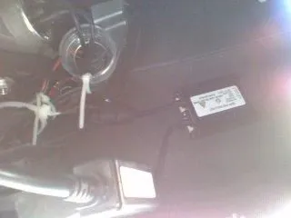

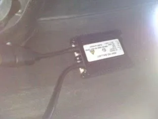

more pics...this is where i mounted the ballasts. I doublie sticky taped it to the inner plastic area which i dont think will harm by melting/etc. I touched it and it didnt get too hot so i think it will all be ok.

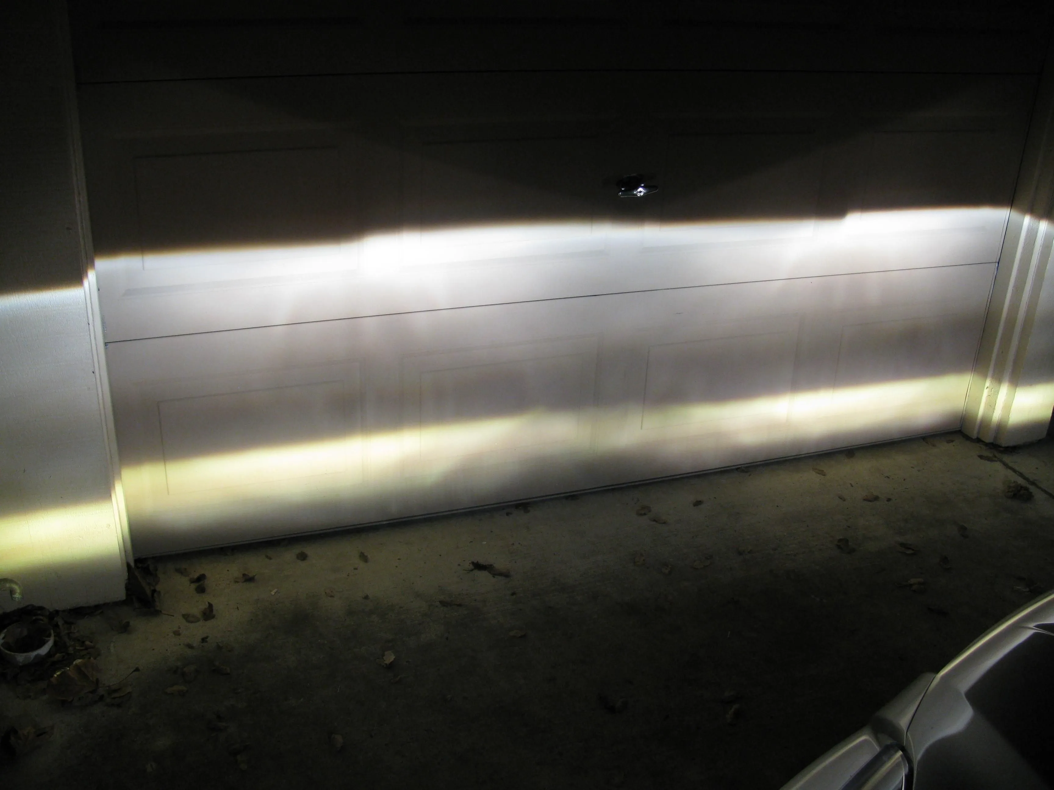

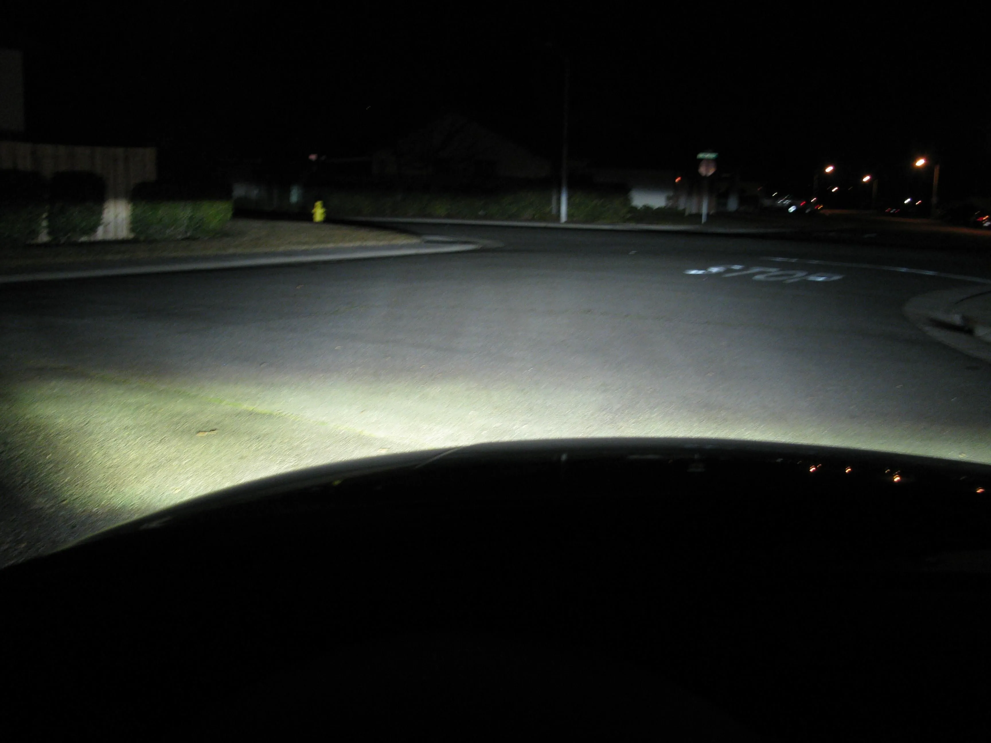

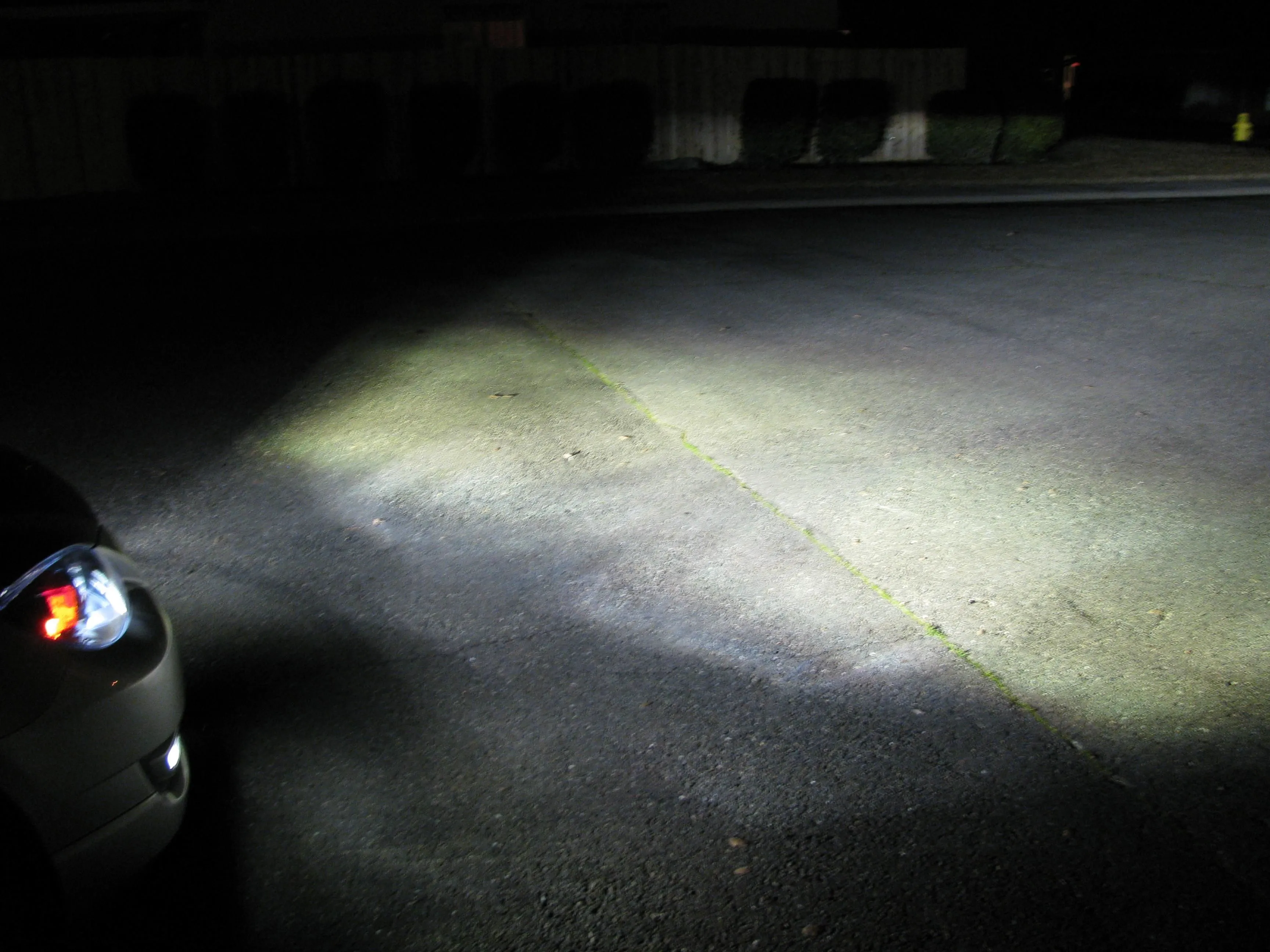

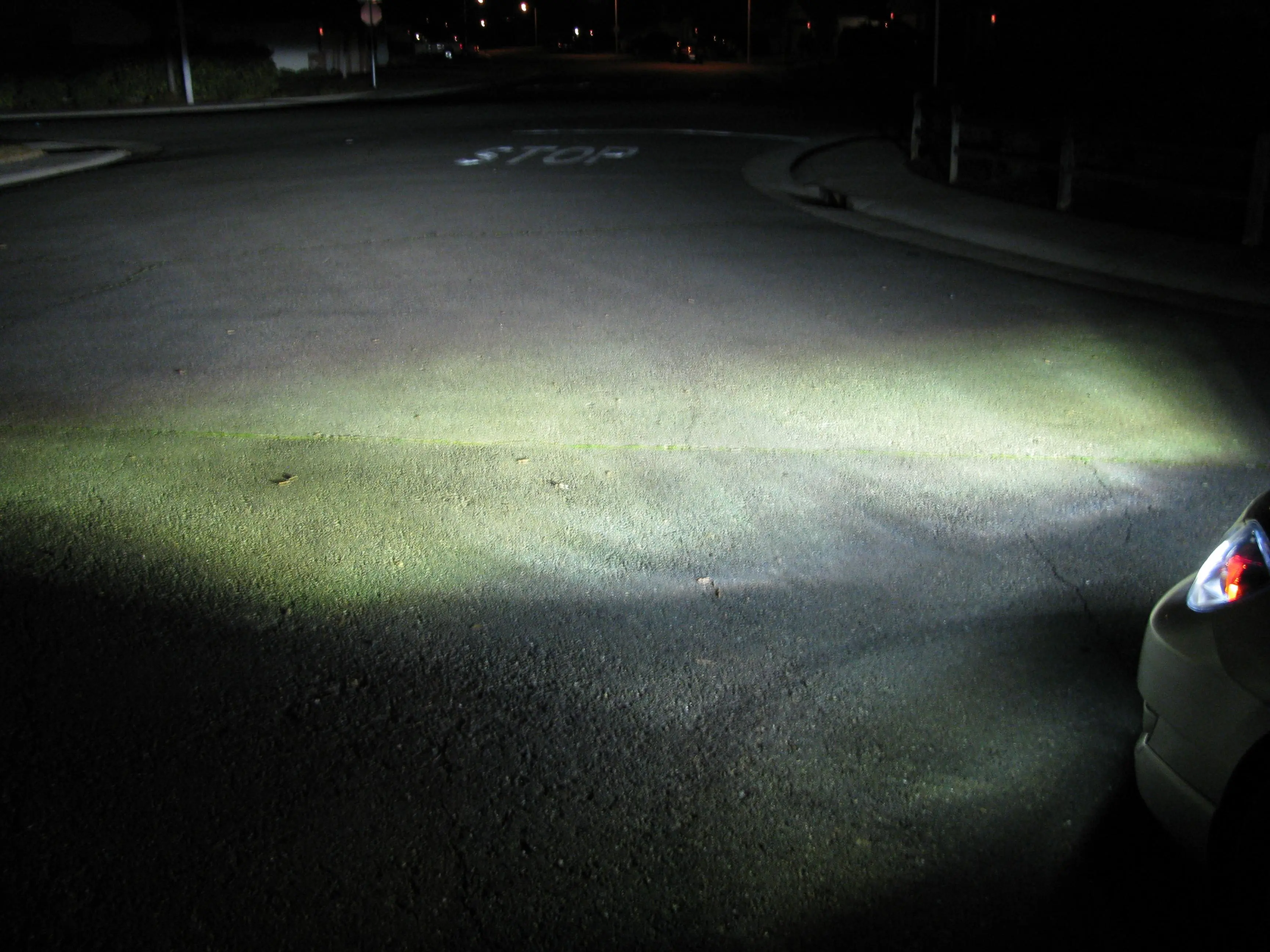

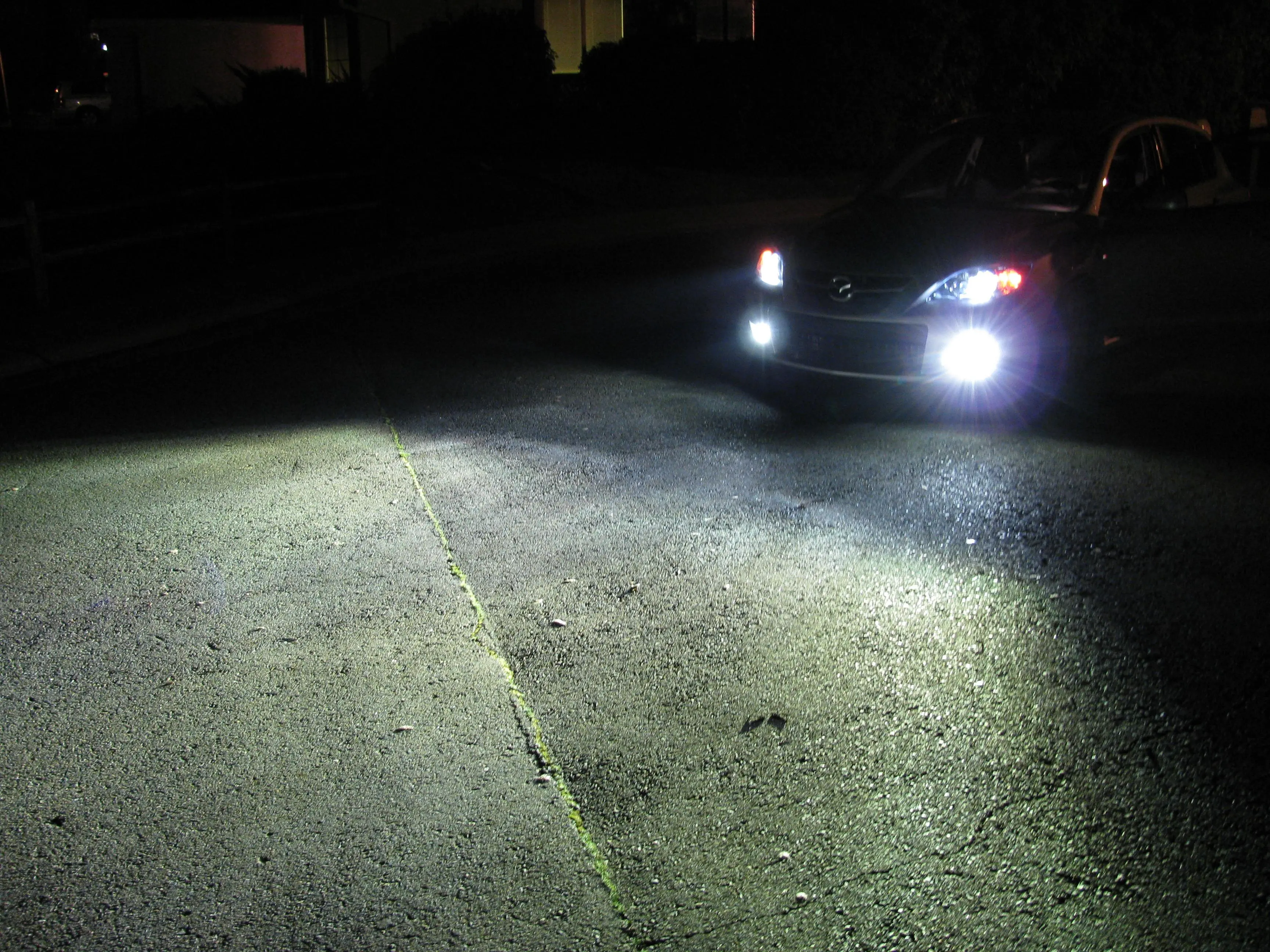

here ya go....
still need to raise the fogs...it seems they have a bright glare....sexy none the less...and i went with 3000k for usability over looks. I do wish the lights themselves were orangish...like lexus type...i thought this would be the correct temp but i suppose not.
