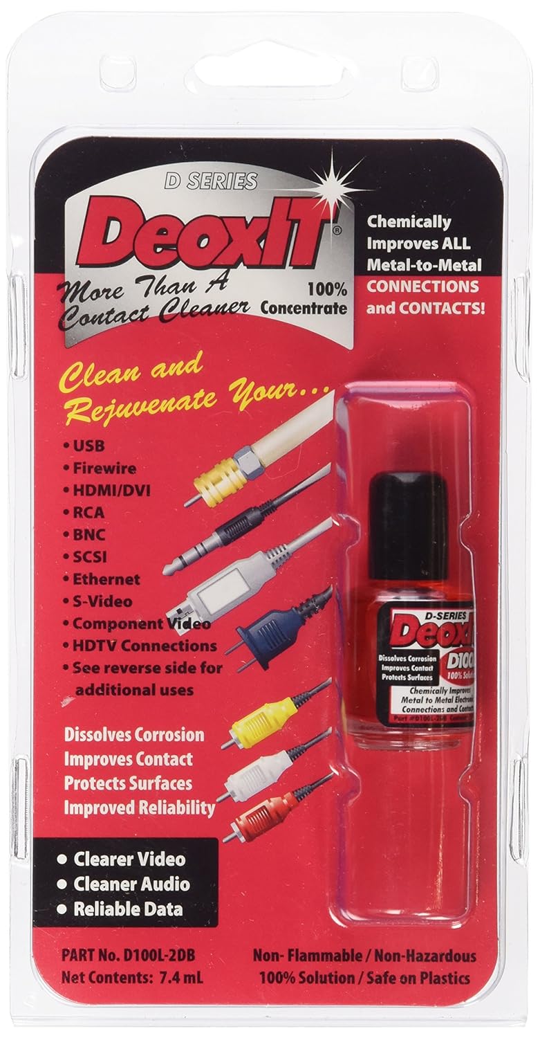

Yes i cleaned them a few times (installing and uninstalling), but it didn't help.
Cleaned with what? Did you use some contact cleaner or 'cleaned it' just by removing and reinserting the card? If you don't have any plastic safe contact cleaner and for what ever reason don't want to buy some, a clean pencil eraser can remove oxidation and contaminates from the contacts on the card (won't help for the contacts inside of the reader for obvious reasons). This won't prevent the contacts from oxidizing again but it will clean them temporarily. Give that a try and see what happens.
Here's what you need, there's also a spray version.
https://www.amazon.com/dp/ (commissions earned)
