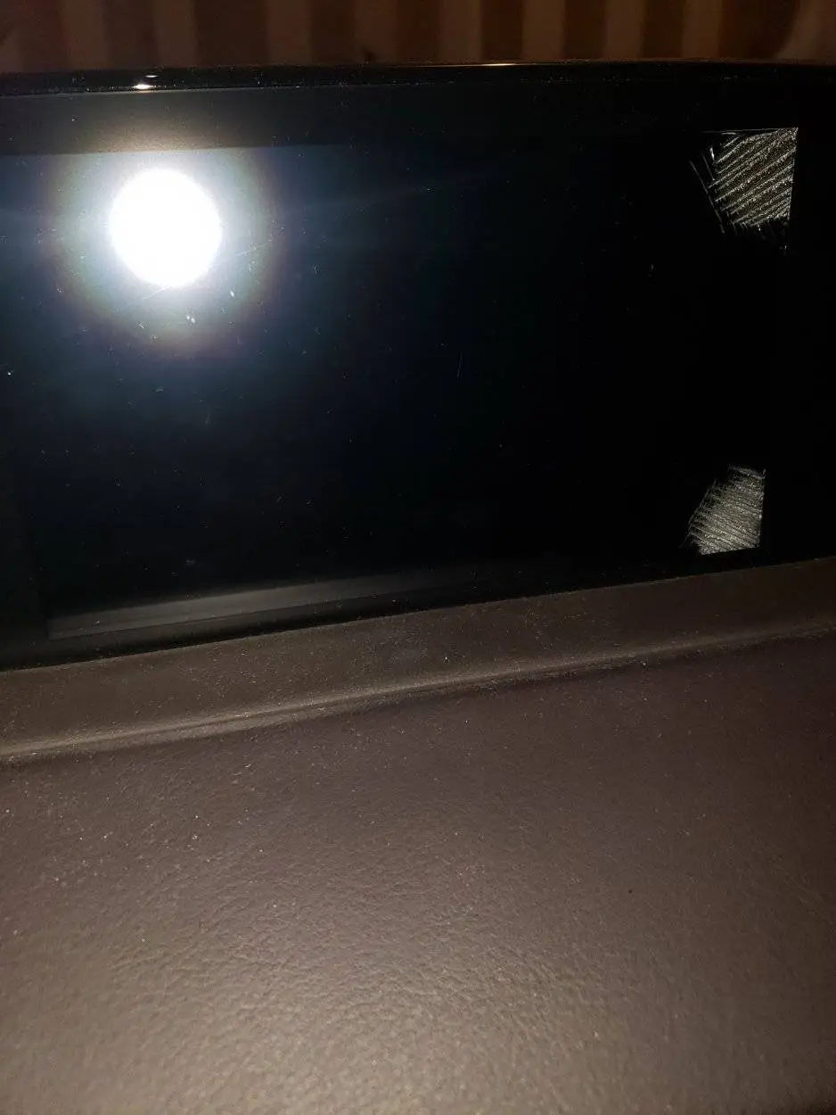

This JUST happened on my 2019 CX-9 with 40k miles (outside of 36k bumper to bumper warranty). Over the course of 2 weeks 3 corners developed internal cracks/delamination. I just called the local Mazda dealer and was told it would be over $1k to fix. I'm shocked this is covered for 2016s but not a 2019...
This JUST happened on my 2019 CX-9 with 40k miles (outside of 36k bumper to bumper warranty). Over the course of 2 weeks 3 corners developed internal cracks/delamination. I just called the local Mazda dealer and was told it would be over $1k to fix. I'm shocked this is covered for 2016s but not a 2019...View attachment 298477
Contact Mazda corporate asap.

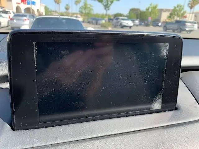

Thank you for posting this. I have a 2017 CX-9. Bought it used and declined the ext warranty. Thought i was SOL until i saw this. I noticed the first crack on my screen back in February when we hit a cold spell while it was parked outside. I thought it was trapped moisture/condensation since i couldnt feel the crack. A few weeks ago i noticed the second one forming on the bottom right corner and recently it started to get bigger and lines started to form. I called the Mazda dealership today, gave my Vin#, sent a pic of the screen by email, service got back to me saying that they have ordered the part and will be replaced at no charge. Someone posted this letter which helped.

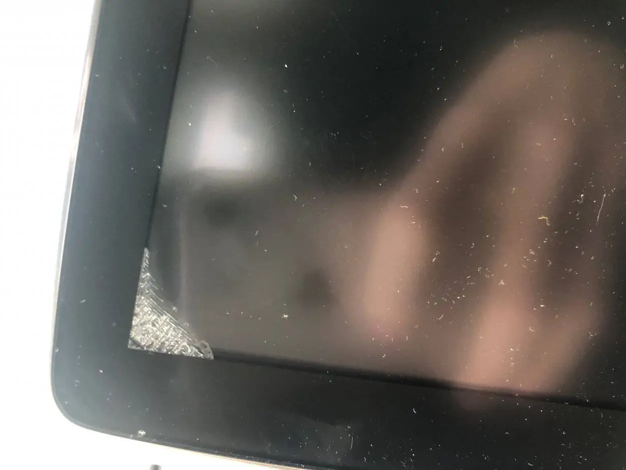

Welp finally happened on my 2016, casualty of the BC/west coast heat wave.

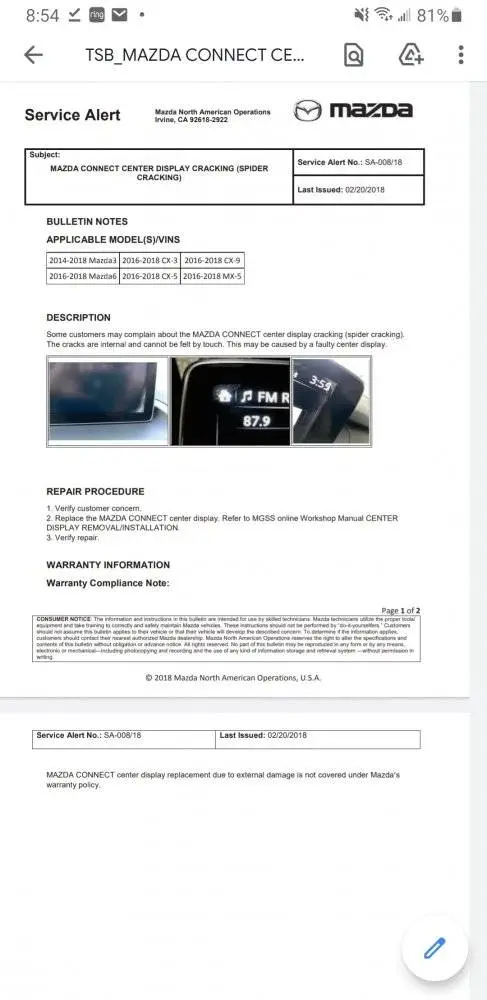

Is there a TSB or letter from Mazda Canada? I've mostly seen the Mazda North America (US) one.

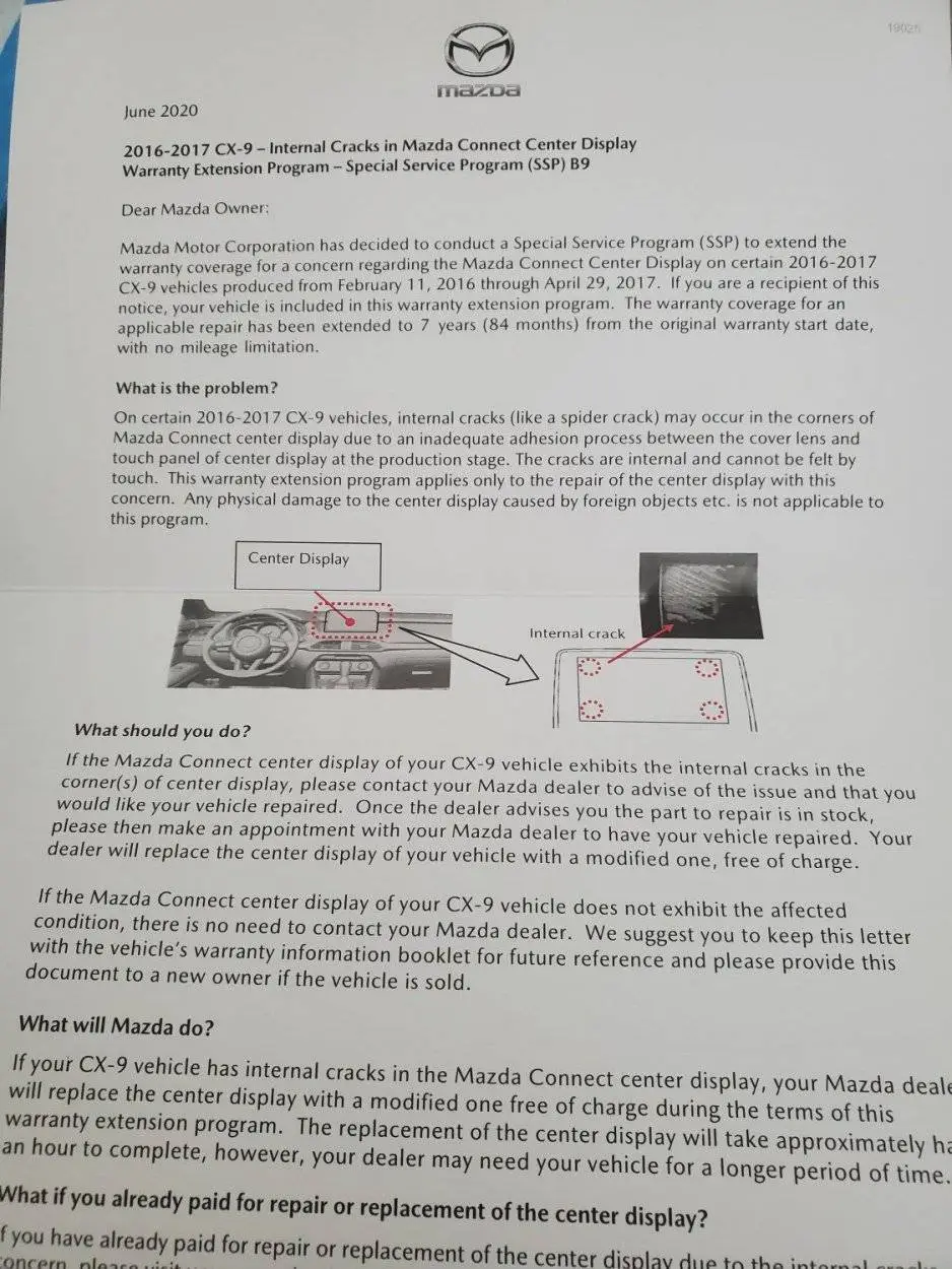

Had the same issue here in MB when we hit a cold spell in January. I would call the Mazda dealership and give your Vin#. They are aware that Mazda extended the warranty on the screen for 7 years for certain CX-9 built from 2016-17. I Had no issue with the dealership, sent a pic of the screen by email, they ordered the parts and got confirmation the same day. Just in case, here's the letter that i found on here. Didnt have to use it but it was good to have. Hope you have the same result as i did. Good luck!
Thanks. Just scheduled an appointment with my local dealership for inspection.

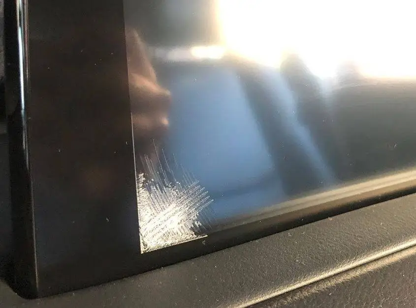

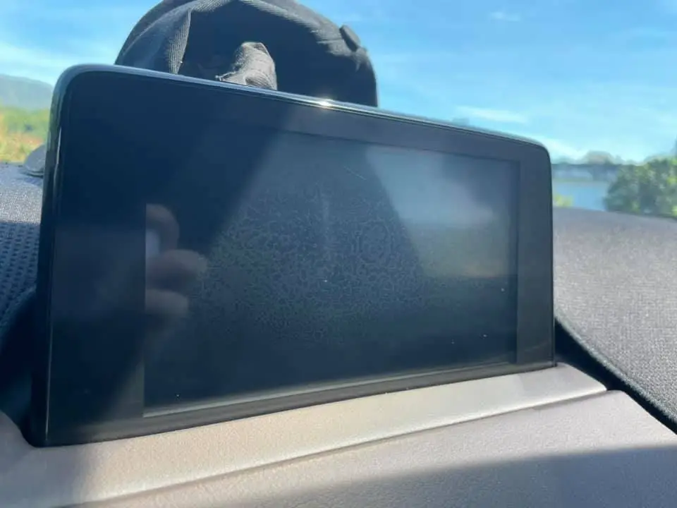

Hi~ everybody, I come from Taiwan, my car is 2018 CX9, this is my problem below.
When the MZD display turn off, I can see some water marks IN the screen, I usually clean the screen by dry cloth or lens paper. so I'm sure that problem is not anti-glare or coating damage.
MAZDA say that problem is my fault, but they have no evidence to show me why the screen become like that.
I guess this is same problem like the "SPIDER CRACKING".
My cx9 did this. I called Mazda directly and there is an extended 7 year warranty on the screen because they know there are problems with some of them. My car has 90,000 miles and they replaced it for free!
