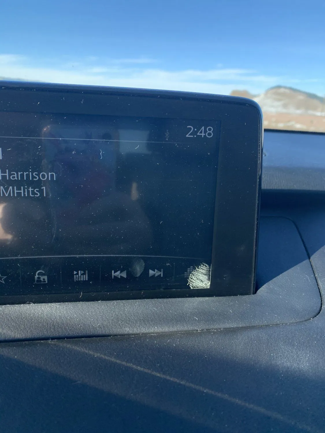

Has anyone run into a similar problem on their 2nd gen CX-9's screen micro-cracking? It seems like this is a known issue on other Mazda models and appears to be exacerbated by temperature swings. Unfortunately, I am just out of the warranty period, so I am wondering if it's even something that Mazda would cover
Mine just did this literally looks like the exact same picture.. mine is out of warranty.. I bought mine used but it’s still under 36k miles but over 3 years old so I’m screwed. I have been a loyal Mazda driver too... I had the 2011 cx-9 now I have the 2016 cx-9 grand touring.. so disappointed
It’s covered by Mazda based on your VIN number. My warranty expired too but I got a recall card in the mail and they fixed it for free.
Funny...or not...I have a 2016 cx9 and noticed this on mine just yesterday . mine looks exactly like your posted my picture. Needless to say I'm not happy this can even happen...mine won't be covered.
Your car doesn't need to be in warranty to have a recall performed.
