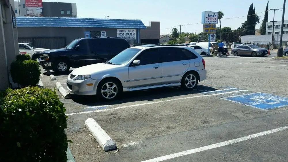

My father bought this car in 2011 w/ 120,000 and finally handed it to me in 2017 with 303,000 miles. It wasn't in the best shape, but after 4 years and 343,000 miles later the motor gave out. (Picture below from when I first got it)

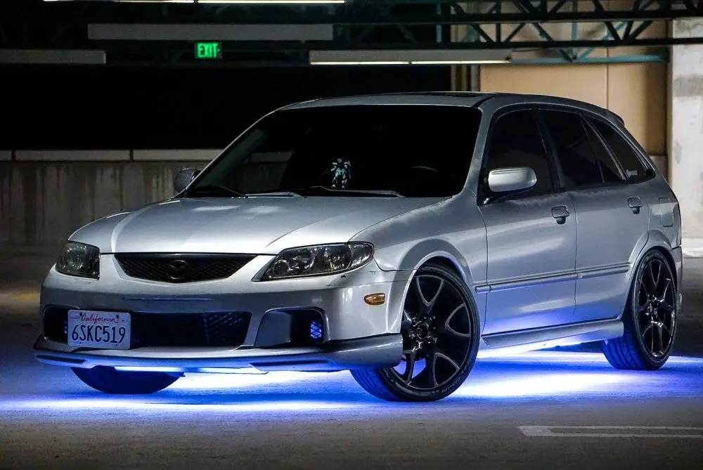

A lot of work has been done to it in the past four years until the motor finally gave out. (Most recent pic below)

Hey, welcome to the forum! Great to see another Silver P5 on here, it looks fantastic, especially for that mileage.
From the second picture, it looks to me like your clearcoat is peeling at the tops of your doors. My silver P5 is doing the exact same thing, and it's especially obvious on the door handles. I also have half the mileage though, which makes your P5 all the more amazing at it's current mileage.

Thank you bro! The clearcoat has been peeling for a few years now, but after I complete the motor and transmission I'm going to send the vehicle to get painted.
