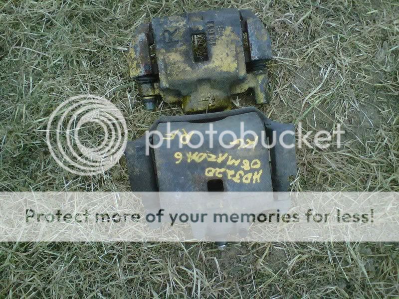

wait are those mazda6 brakes?
DingDingDing! Calipers/Rotors from a 2008 Mazda6 S (V6). Much larger than the stockers, barely fits inside the wheel, can't believe you guys missed that :p I really like the way it fills up the 16" wheel, I may sell off the 17's and just put new tires on the stockers. No motor in yet, those are just the skunk2 coilovers, set to as high as possible ;)

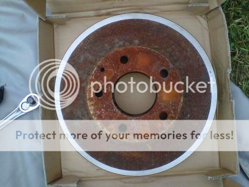

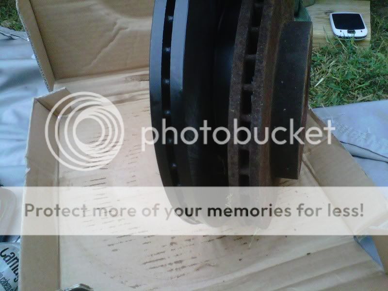

Here's a few more pics that compare the 2008 MZ6 setup to the 2002 P5 (sorry for the crappy phone pics):
Old vs New:
