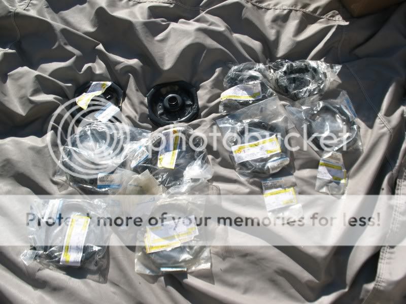

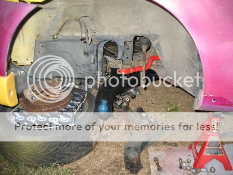

So I haven't updated this in a while, been working on it here in there. I tried putting on my new suspension only to find that the previous owner tossed all of the spring mounts in order to achieve that Hellaslammed snowplow stance. I had to place an order through Online Mazda Parts for all new top hats, spring mounts, bearings and upper and lower rubber seats; kind of tedious, but I wanted to do it right. I did manage to mount my MSP sway bars and Energy Suspension bushings using the brackets that came with the bushings, no need for the MSP brackets. I also installed new LCA's on both sides and need to make time for the inner/outer tie rod ends before reassembling the suspension.

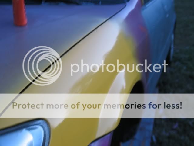

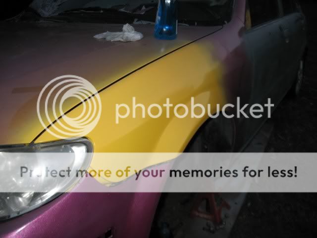

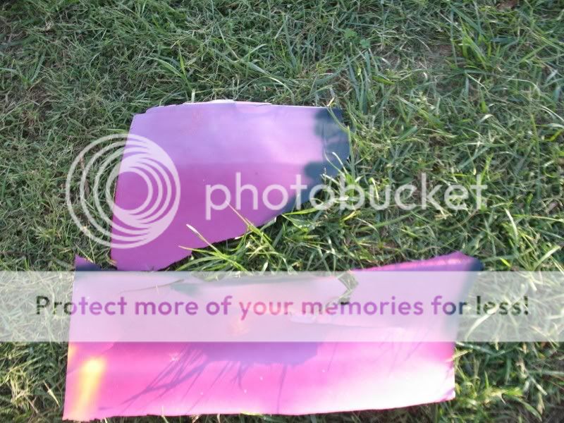

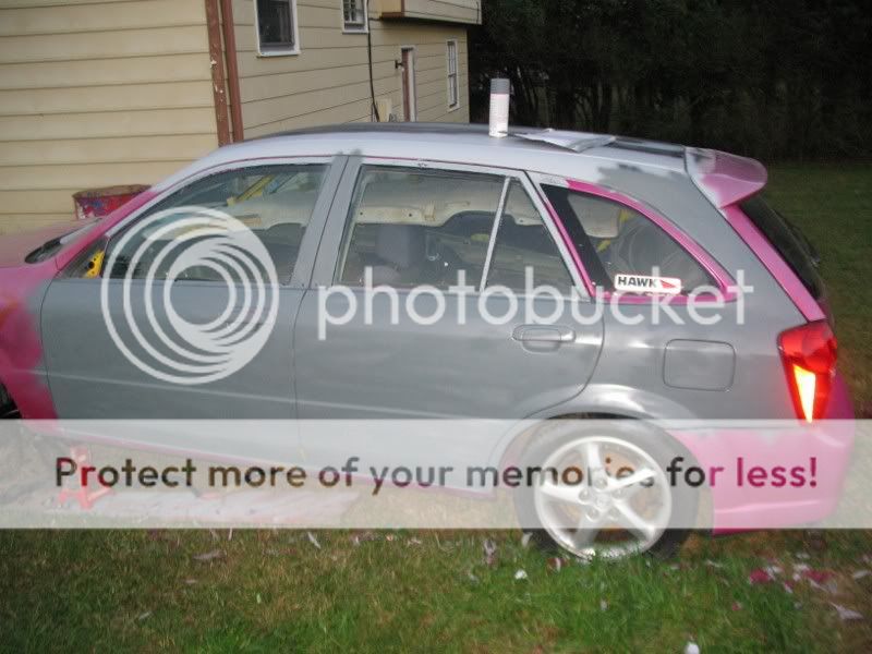

I asked Brian to give me a hand with the sway bars and he ended up chipping away at the pink paint, literally. It turns out that I was going about this the wrong way thinking I would just sand it all off; turns out that all I need was a razor blade to get it going. Brian started with the mirrors and it eventually spread to the rear quarter panel and the roof. We were pulling off huge chunks of paint at a time as if we were removing a vinyl decal, kinda scary and I'm glad that I didn't try to paint over it. I also threw some TLC at that one fender I painted yellow (without any prep) by washing it with windex and throwing on a coat of NuFinish wax, lol. Much to my surprise it has endured the weather pretty well, I'm confident that if done right and maintained that it could make for a decent 10-20 footer. You'll see in the pictures below that it has a similar sheen as the rest of the paint.

lookin good. what headers did you go with? and that paint is scary y did it come off so easily? just a crappy job?
I went with the generic ebay headers, for $130 shipped, I expected something to not fit. Not sure why the paint would pull off that way, poor prep I suppose but maybe one of our paint professionals can chime in. It was pulling most of the primer off with it in spots, which was interesting. I did find out that it was originally painted a much deeper magenta and then re-primed and repainted. Oh well, we'll be getting rid of all of that junk soon.

that was some whacky paint. they must have used 10 gallons of it to get that thick.
and i like your sig pic as well.
Haha, I was wondering if anyone was going to pick up on the signature picture; I guess I need to update it again. I am pretty stoked about the paint though, that will save me a ton of time and hassle having to sand through it all.
