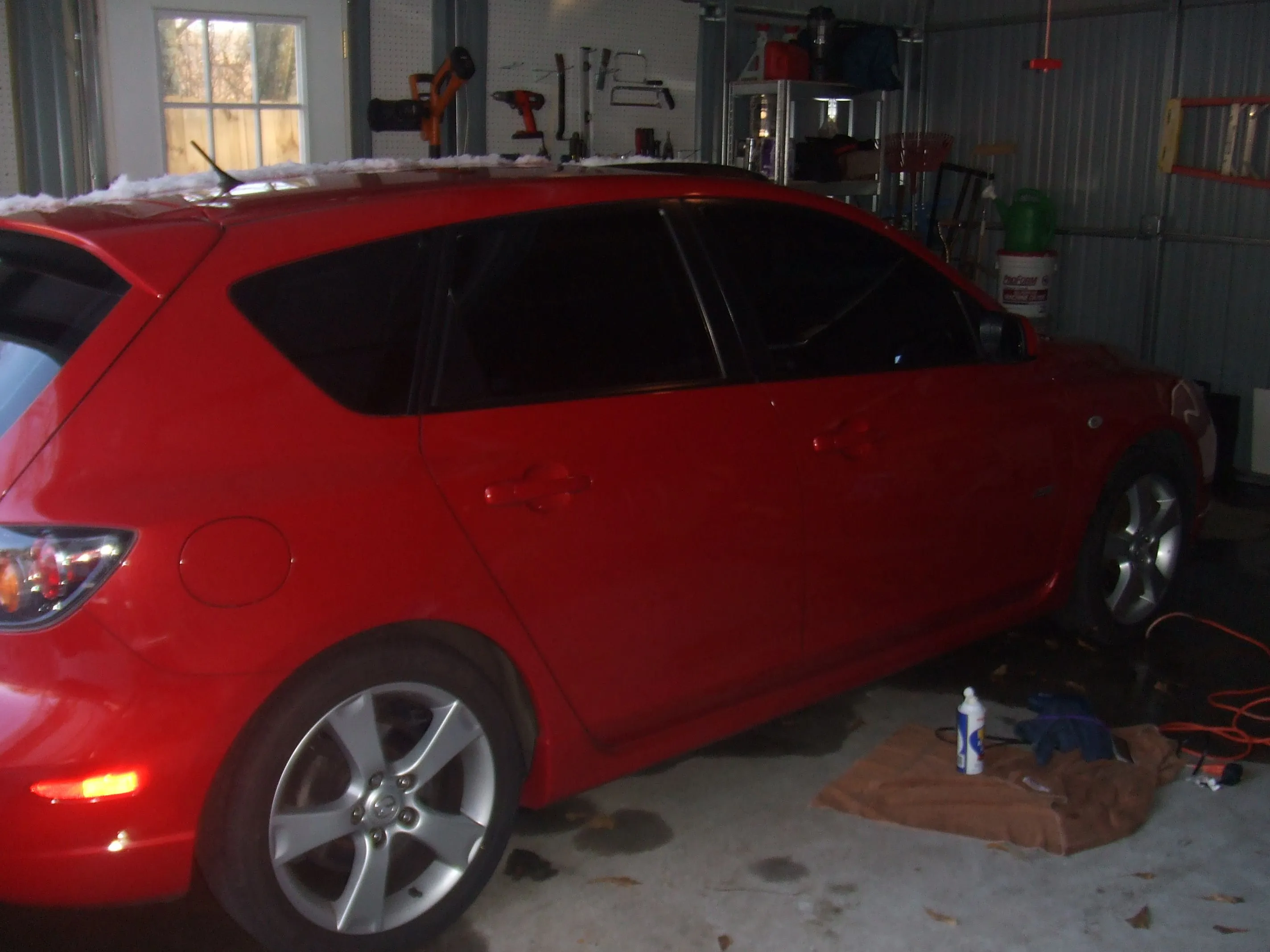

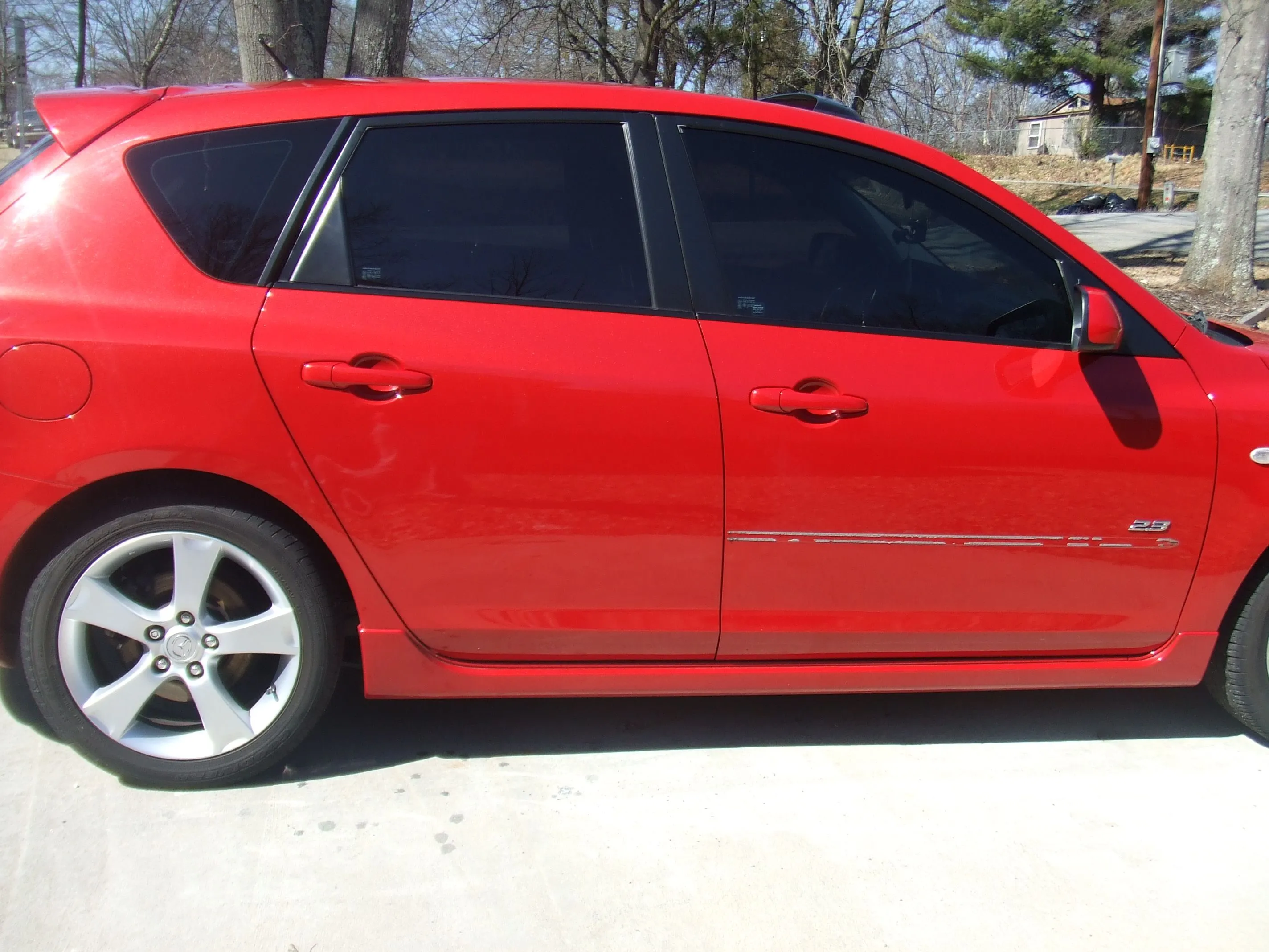

Okay! yay a question i can answer!! Okay this WILL be a TIME consuming project. Also, this is how I took off my moldings: use a old credit card and and slide it in between the door and molding enough for you to "yank it off" THEN once all the moldings are off * the easy part* you'll need bug and tar remover i tried that and goo gone and the bug and tar works better. using the credit card up and down motion works better than side to side. Its taken me 3.5 hours on one side of my mazda3 hatchback. I still have another side to do. the credit card wont damage the paint or the door!! it looks 100x better after everything is done : )

Oh my. Well, i really dont care how long it takes me as long as the end product is what I want. And I wish I would have taken moldings off ALONG time ago. : )
