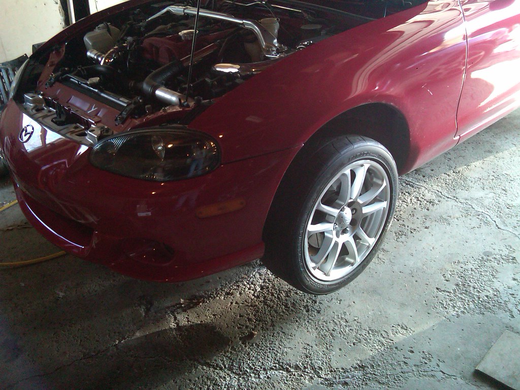

I took a pic of my MSM on jackstands with my Civic's 16's on it. Lemme upload.
It's hard to judge since it's up in the air, but I couldn't lower it down because my lugs fit just enough to not be able to be tightned with a socket. If I was to use those ever, I'd need spline shafts.
