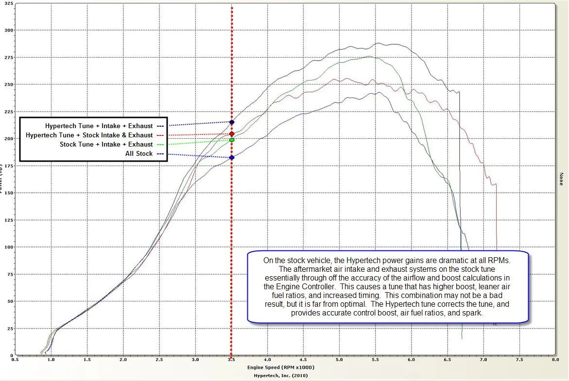

But there are a lot of reasons that a car can operate at the same boost level as stock and get better acceleration with an aftermarket tune. It's not all about boost. It's about the load maps, AFR adjustments, changes to injector pulse parameters, changes in timing advance and many other variables that enter into the tuning process.
Just because your boost pressure is the same, doesn't mean that the car isn't making more power. It is possible for you to be seeing the same boost pressure with the stock tune vs. the Hypertech tuning. The aftermarket intake is probably causing an error in the ECU calculations for the amount of air entering the engine, resulting in excessive boost, leaner AFRs, higher EGTs, and aggressive spark timing. The addition of the higher flowing exhaust, with the stock tune, just compounds the problem. What we saw on our car is that the Hypertech tuning, with the correct MAF readings, allowed the engine to make more power, at the same or even lower boost levels, and reduced the AFRs and EGTs. The attached graph shows more info.
Power is not made with boost. The turbo can only flow so much air. The higher the boost, the hotter the air. The trick is finding the optimal boost to keep the airflow efficient. This cant be done at one boost level. The boost level must be tuned differently as the engine RPM increases and the physical 2.3L of displacement pumps faster and faster and demands more and more airflow.

Did you look at the diagrams above. A standard MPS3 delivers around 280 engine hp with cbe...My car is already BMW M3 fast, but my question is if the power Hypertech promise is noticeable? I can't make my car go any faster with the tune... hrm yes I got 3 miles higher top speed than stock and 0.2 seconds better time at 1/4 mile... but that could be driver related... 50-75 on third... no improvement at all. The Sri cut a full second from stock, so I don't buy that about messed up MAF readings and all. If that would be the case, the car wouldn't react so good changing intake... It should behave as with the stock filter. The racepipe did almost nothing when it comes to performance. When I signed up for beta testing I thought that Hypertech would make my car considerable faster, but no. But I still really like the way it drives...
