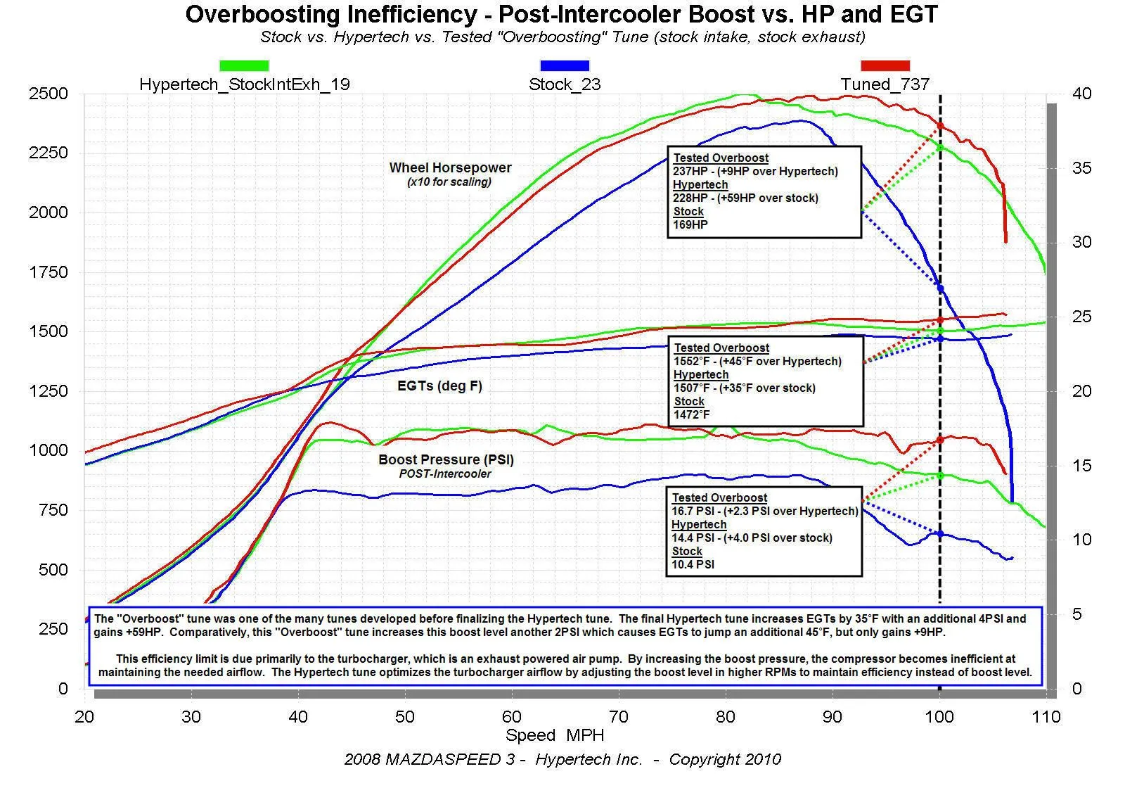

The Hypertech tune was developed using the stock heat range plug.
The reasoning for going with a colder plug is to reduce the chance of detonation. This typically happens at the higher RPM ranges, with tunes that hold the boost pressure steady out to redline. The stock turbo reaches it's peak efficiency around 6,000 RPM. Holding the boost steady beyond this point overspins the turbo, and superheats the air. This can cause detonation, and the ECU will attempt to control it by retarding the timing (knock retard). By running a colder plug, the theory is that it will help reduce combustion temps, and reduce the detonation, and subsequently the knock retard.
The Hypertech tune optimizes the turbo airflow by adjusting the boost level in the higher RPM's to maintain efficiency. Peak boost with the Hypertech tune is around 17-18 psi, but we roll it off at the higher RPM's to around 14 psi. This keeps the exhaust gas temps in a safer range, which reduces the chance for detonation.
