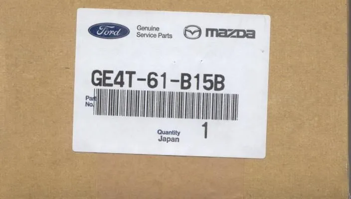

yeah but like i said before, that is the RHD model, which would mean you will have to move your indicator stalk to use that specific part number...
most part in oz can be gotten from mazda or ford, hence this box below!! (this was for my heater resistor)
