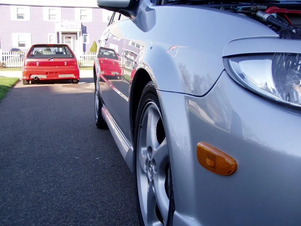

i shaved mine last night. i couldnt find any 3M anywhere, so i bought some off brand at home depot. that adhesive is no joke. the remover i bought wasnt near strong enough, so i ended up spending about 2 1/2 hours getting all that s*** off. pita, but well worth the effort. it looks so much cleaner and smoother. thanks for the tips guys.
i did this mod likethe first week i got my car but a little different. my car was hit at the parking lot so the ensurance paid for the dent and at the same time i got the moldings remover.
I got the 3m stuff in spray form from the store and spent an hour and a half on each side using my fingers. If you're not carefull you can scratch/fog your clear coat. Go easy on it :)
my car was in the body shop and i had the guys remove the side moldings for me. came out nice...i like the smooth look!(thumb)
