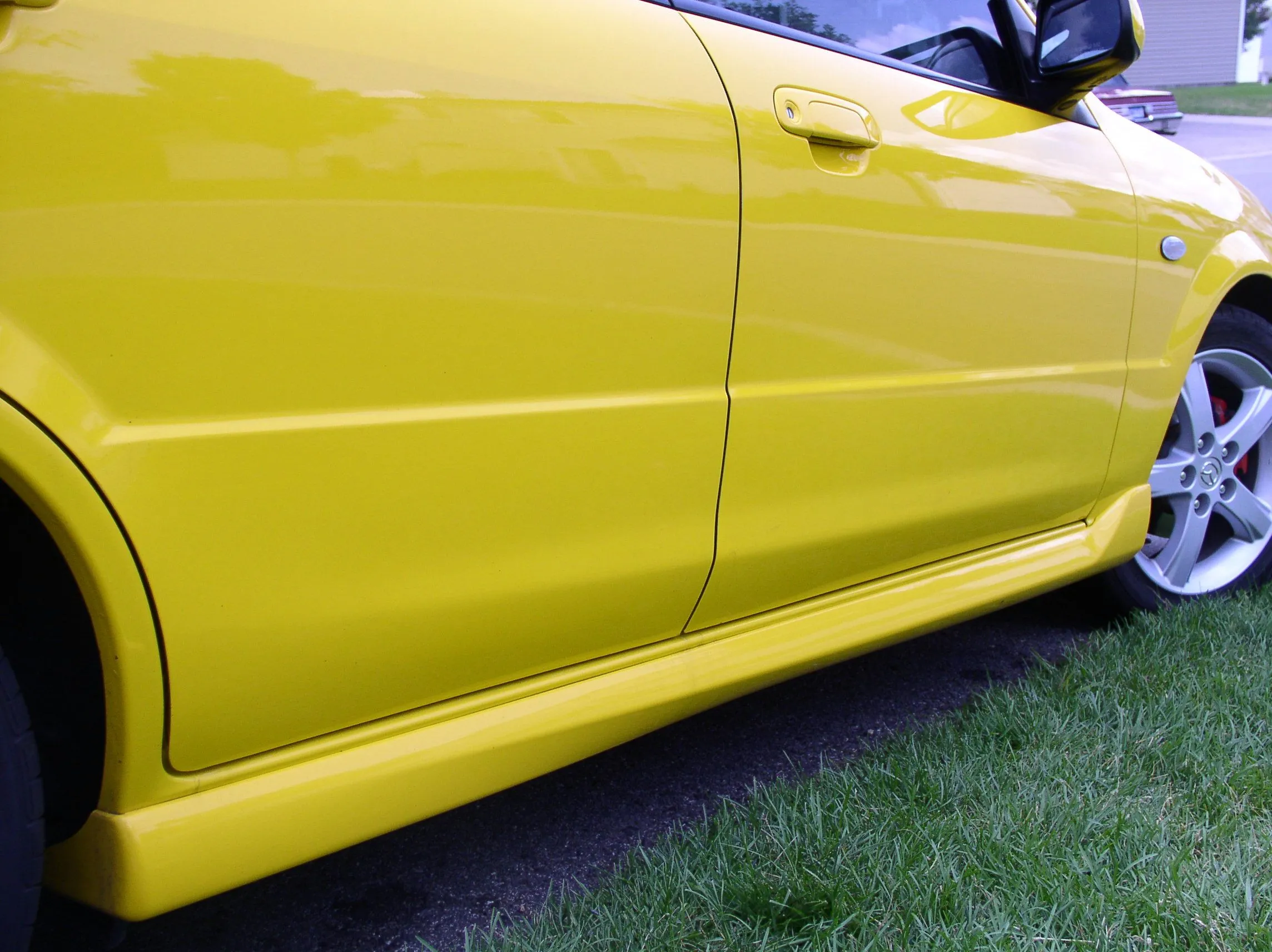

my friend mike and i accomplished shaving the moulding yesterday. thanks for all of your help mike. (thumb)
Looks cool huh? I really like it without my mouldings!

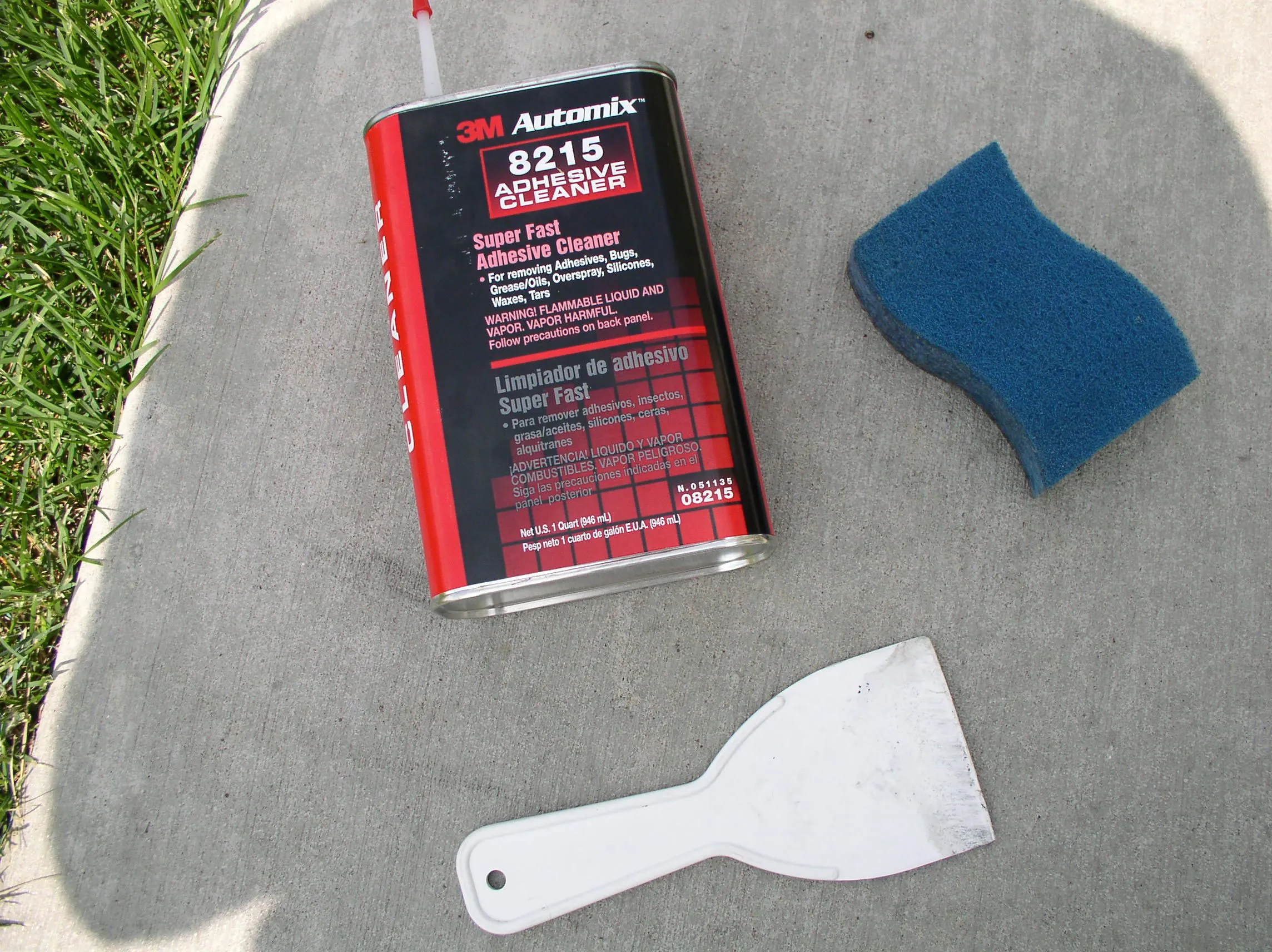

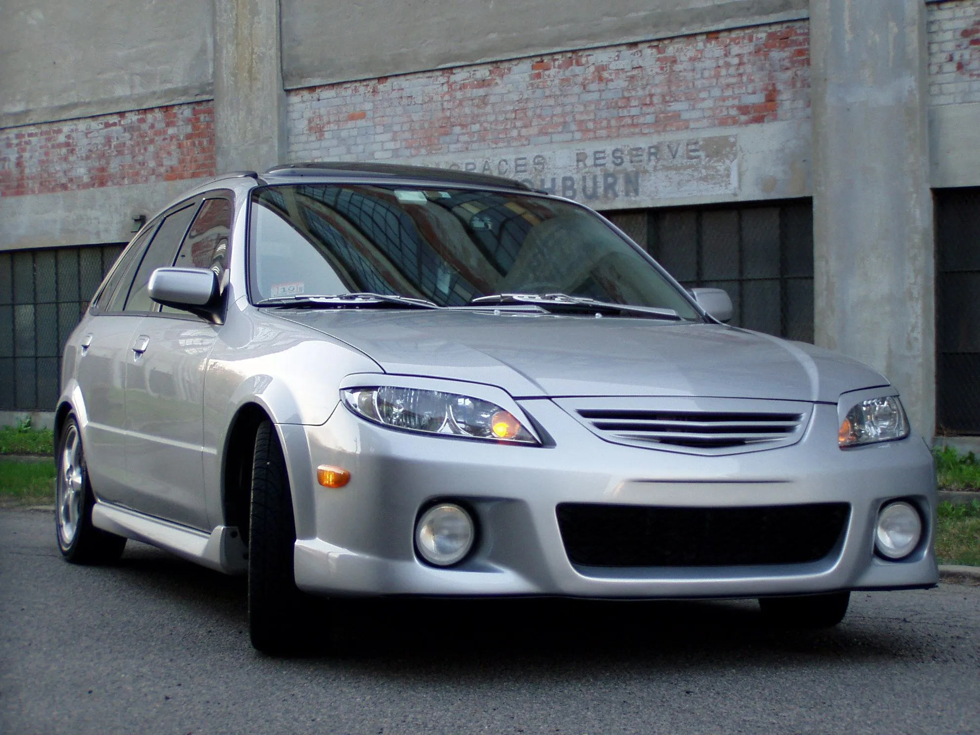

This is a great mod - it really cleans up the look of the car and has helped give my car a sports car look vs a wagon look. It took me about 1.5 hours using "3M Automix 8215 Adhesive Cleaner". I bought it at Bumper to Bumper auto parts store for $15. I works like a champ!
I used a plastic puddy knife to peel the moldings off first and then soaked the remaining glue with the cleaner and sponge. I would recommend NOT soaking the moldings before removing them because you may get lucky you may take some of the adhesive stripping with it when you pry it off. After the moldings are off then soak the remaining adhesive and wait for it to dry a second or until it becomes tacky enough for you to use the end of your thumb to peel it off. This is the most time consuming part but it is well worth the effort.
I have had my car for 9 months and the end result after washing and waxing is that you can't even tell that they were on the car. In fact, I had to get down on my hands and knees in the right light to figure out where they were!!(cheers)
