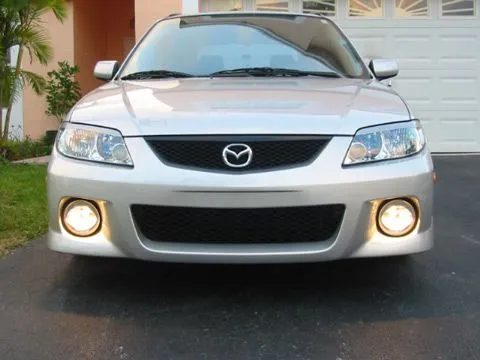

eggynatey said:
We had a foglight party today. :)
Hey eggynatey,
It looks like all those cards have their side markers and fogs only. How did you guys do it?! Did you use the instructions here?
djstan said:
Hey eggynatey,
LMFAO.... Yes that's what will happen if you follow the directions at the start of this thread...
