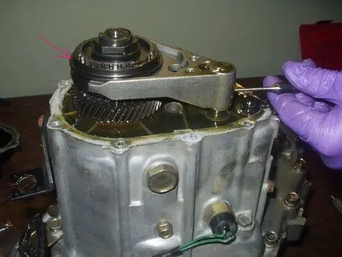

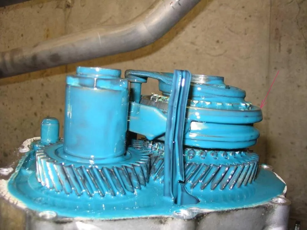

Did my tranny this weekend with new welded LSD and a few other parts along with my clutch.
I'm popping out of 5th gear!!!
The only part of the re-assembly that I left to my buddy and did not verify with a drawing(argh) (argh) (argh)
But now looking through drawings I see the Collar part that the 5th/reverse shift fork moves is flipped with the chamfered edge facing opposite each other. These are the two drawings that show different orientation.
Anyone with helpful information will be greatly appreciated!!!

The pic on the left is a 2003.5 msp trans.
The pic on the right is a pre-2003 trans.
Mazda updated the top-side of the transmission with a different set-up.
The gear selector ring was in backwards. In the pic above showing the parts in order the selector ring is backwards also! Runs like a champ now!
Knock on wood!!!
