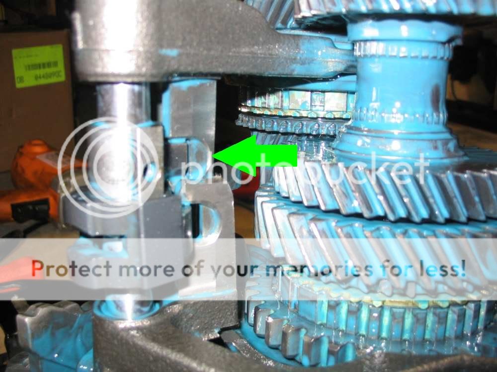

I don't see anything out of place in those pictures. I had a similar issue (not the same), where on the bench I couldn't grab a few gears when shifting. When pulling my diff out I decided to lift the main / counter shafts and slide the diff out, as opposed to removing either of the shafts. What happened was the linkages in the pic below, from post 11 of this thread, fell out of alignment. They should look exactly as they do in the pic; for me the top piece fell out of the slot. All I needed to do was to move the shafts slightly and slide everything back in place.
