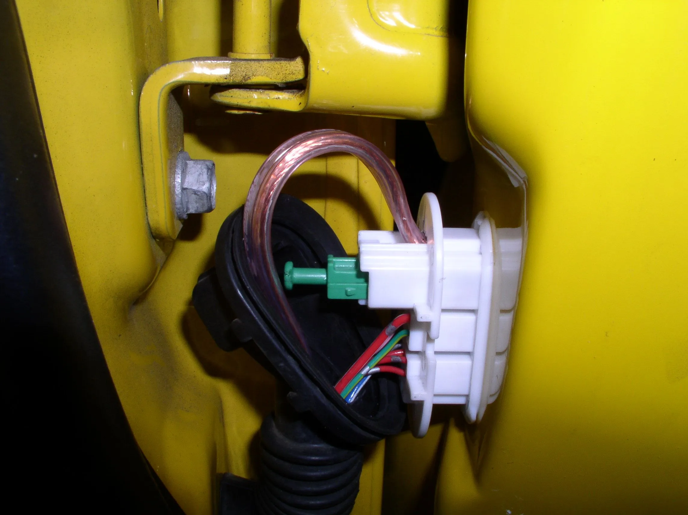

Well i just pulled 12 gauge into the rear doors and it was a snap. The pic below shows where i pulled the wire through the plug. Basically its right on top rather than through the small holes. The only problem with this way is that the rubber cover doesn't quite fit flush to the car. I haven't figured out how to remedy this yet, maybe seal it up with some silicone? I used Crankin Cable (I think that's what it's called) and it is some heavy duty s*** - makes Monster look like dental floss or something!

I just did this today. Mind you I only got one side done, but the idea is very good, and it's easy in application.
i am doin mine as well... but a 3 is not the same!!! i had to take my driver side door off to release the harness on that side!!! not fun at all... i took some pics and will have a short right up for 3 owners shortly... just thought i would post that here since this is the info i had going into my project and lets just say it was a bit different!!!
