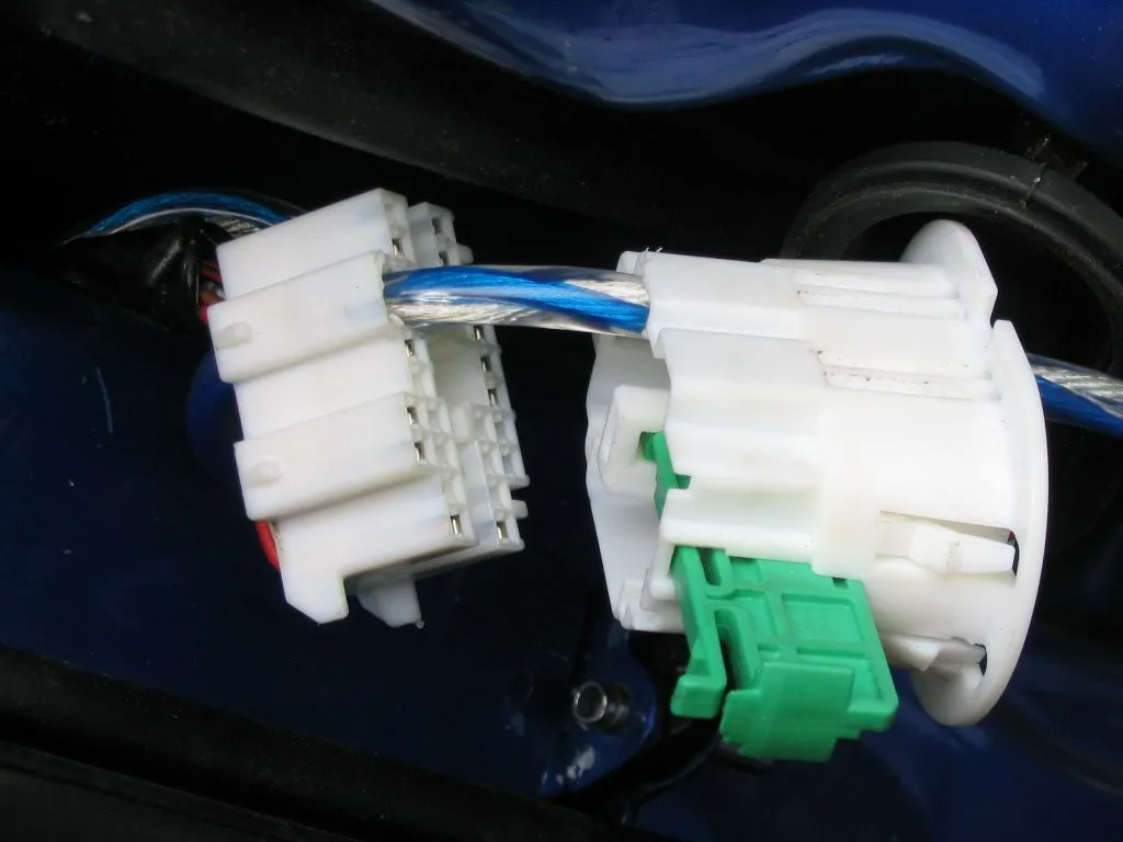

Just wanted to say that this thread was a great help today. I pulled apart both doors and installed my Eclipse components. If anyone is wondering, it is possible to run 16ga twisted pair cable through the wiring harness (see picture). Basically you need to drill out four empty slots. On the passenger side there is an un-used wire (no idea why) on the male end that has know female counterpart (poor guy). I traced it back to an empty molex connector that may have been used for a door lock switch at one time. I just moved the male end over one slot so I could get four in a square pattern to drill out.

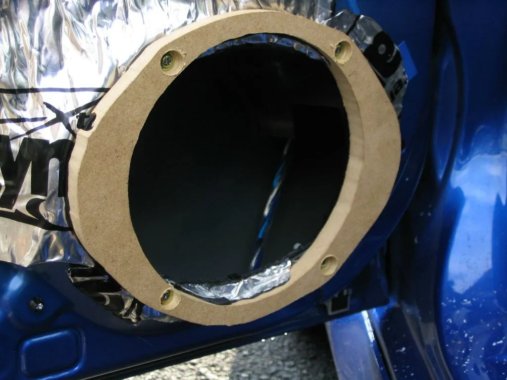

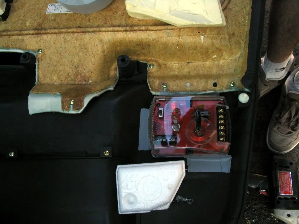

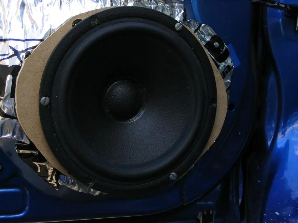

Let me tell you, the Eclipse baskets have got to be the largest I've ever worked with. They never want to fit in any door. They just barely fit in the 5x7 hole with a 1/2" baffle. I probably should have gone with 3/4" but I didn't have any lying around. Its worth it though because they sound great! The imaging isn't competition-quality with the tweeters in the stock locations but I can live with it.

3/4" will not hit the door panel (asuming that you remove the plastic ring that the stock speaker buts up against) as long as the driver doesn't have too high of a mounting depth. The Eclipse speakers are very deep for 6.5"s at 2-7/8" but with my 1/2" baffle the magnet came right to the edge of the stock water guard. There is probably more room back there but I didn't measure. So mounting depth shouldn't be a problem.
As for dimensions...Basically, I traced the outline of my Eclipse speaker, then traced the outline of the stock speaker over that, then cut out the union of the two circles. I didn't take any dimensions once it was done. The cutout diameter for the speaker was 5-11/16" which is typical for 6.5" speakers. However, getting your speakers to fit depends on the basket. The Eclipses have a cast iron basket that doesn't taper inward very quickly like a stamped basket. If the eD's are the same way (or worse) you may have to pull out the hack saw.
I did the same thing as him. Traced the stock speaker and then the CDT speaker over it.. I had to trim the plastic panel inside the door panel too though. The speaker would hit it, so i trimmed that oval on the inner door panel down almost all the way.
I used 1/2" MDF for mine.
For the fronts if your using a 6.5" speaker you can simply leave the top of the adapter aboput an inch high. It will clear under the door panel and give you the extra mounting surface most 6.5" speakers will need.
Ok, so you can fit 16ga wire through that door connector part.
Can you fit 14ga wire through, however? If I were to upgrade speakercables in my car, I was figuring to go all out w/ 14 gauge.
N2OInferno said:
I used 12ga and it fit. It was tight and I had to relocate the unused pin, but it fits.

Astral> Hell, Wakey pulled 10g power wire and RCA's to his doors, I seriously doubt cramming lots o' wire through is a problem. Especially if you move that pin, it won't be a problem. I've currently got one 14g, one 18g speaker wire, and then a 4x20g telephone wire thing going through there (possible seperate tweeter wiring, triggers for window modules, and still 2 spare wires for possible lighting)
Thatsaid, I don't think that 12 is really allthat huge for gains compared to 14, I went through this one myself... Look at the chart thing that 1sty linked to further up in the thread. I think I'm pushing about as much power to my doors as anyone, and I'm not in the least bit concerned. Infact I think that 16 would have sufficed.
