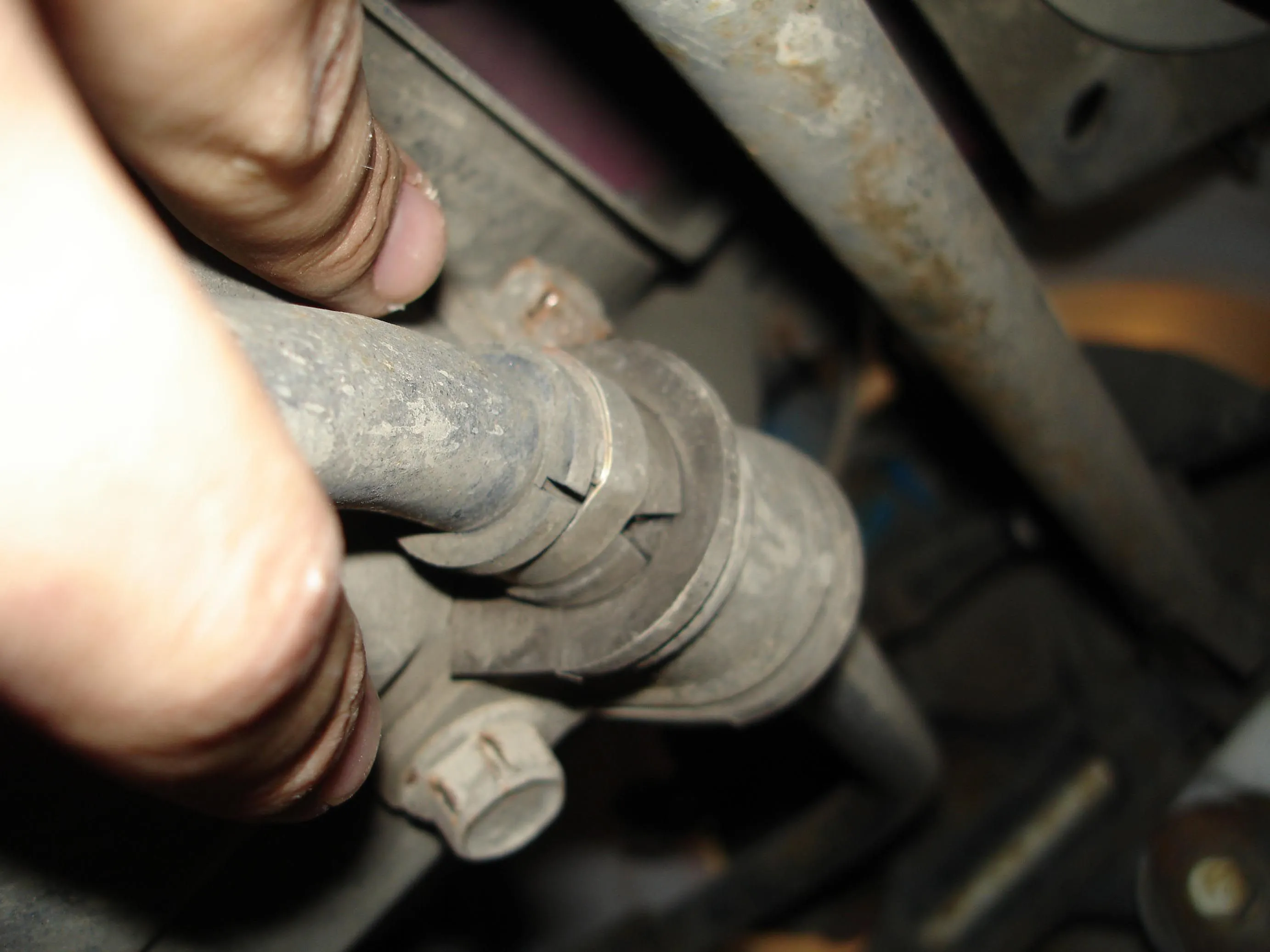

Get your ass up in the air (the car's not yours, unless you're a girl, in that case give me your number) and makse sure the car is secure. Pic 1

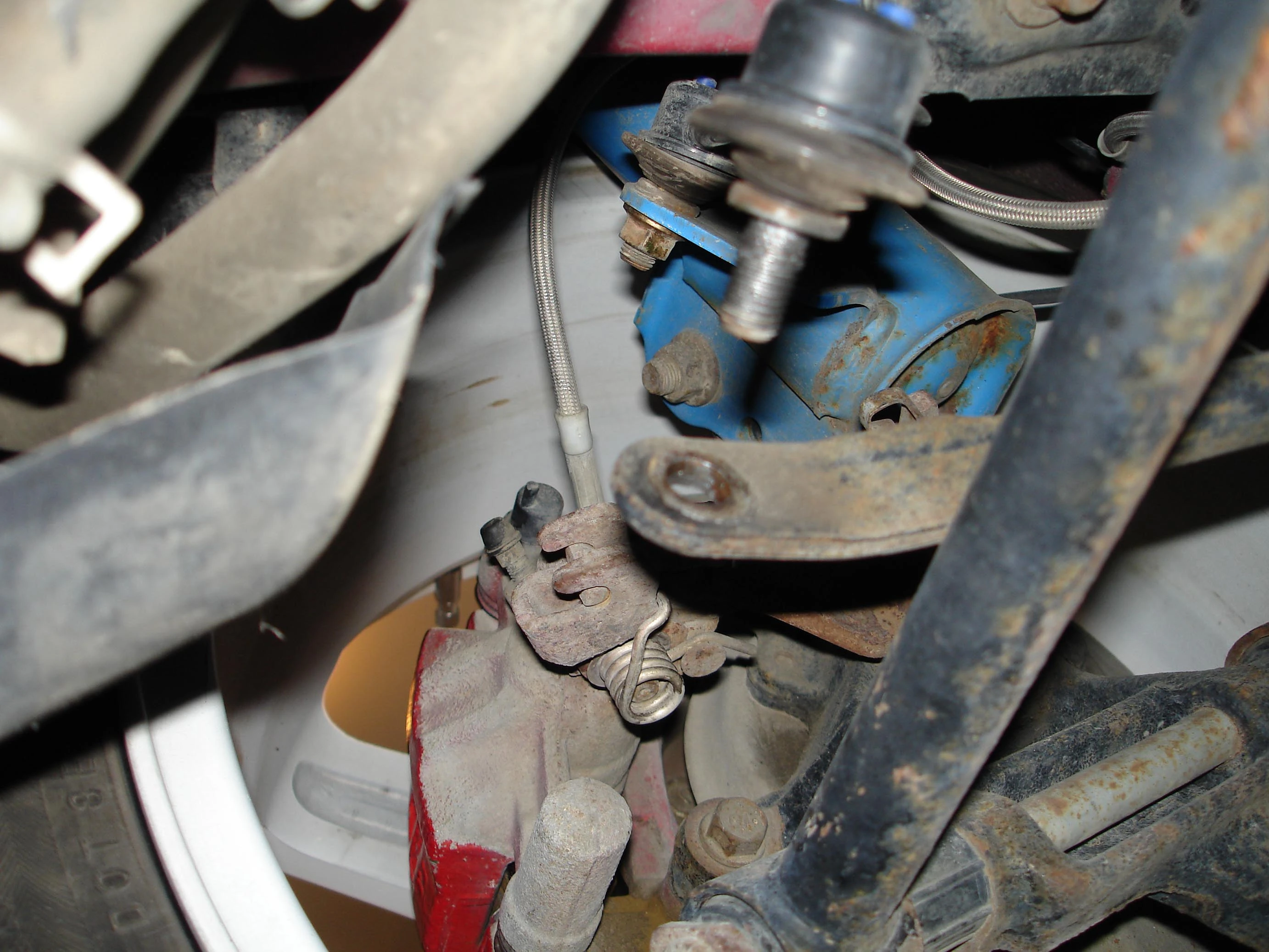

Now, remove the end link nuts. Stick the allen key in the middle, and loosen the 14mm nut. Take it right off and slide the endlink out. Pic 2

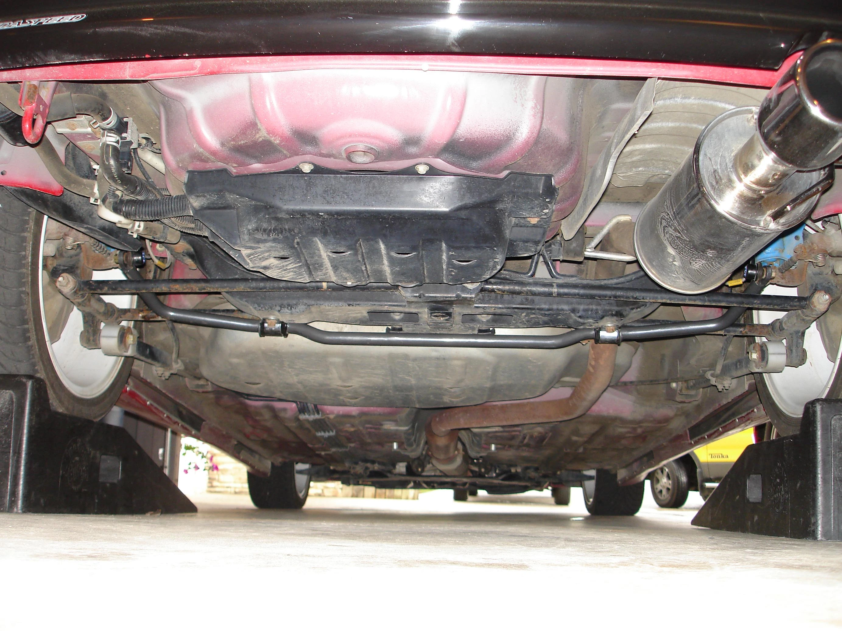

Now that you've got both endlinks off, it's time to remove the sway bar brackets. Just 2 14mm nuts, and 2 14mm bolts here. Very easy. Pic 3

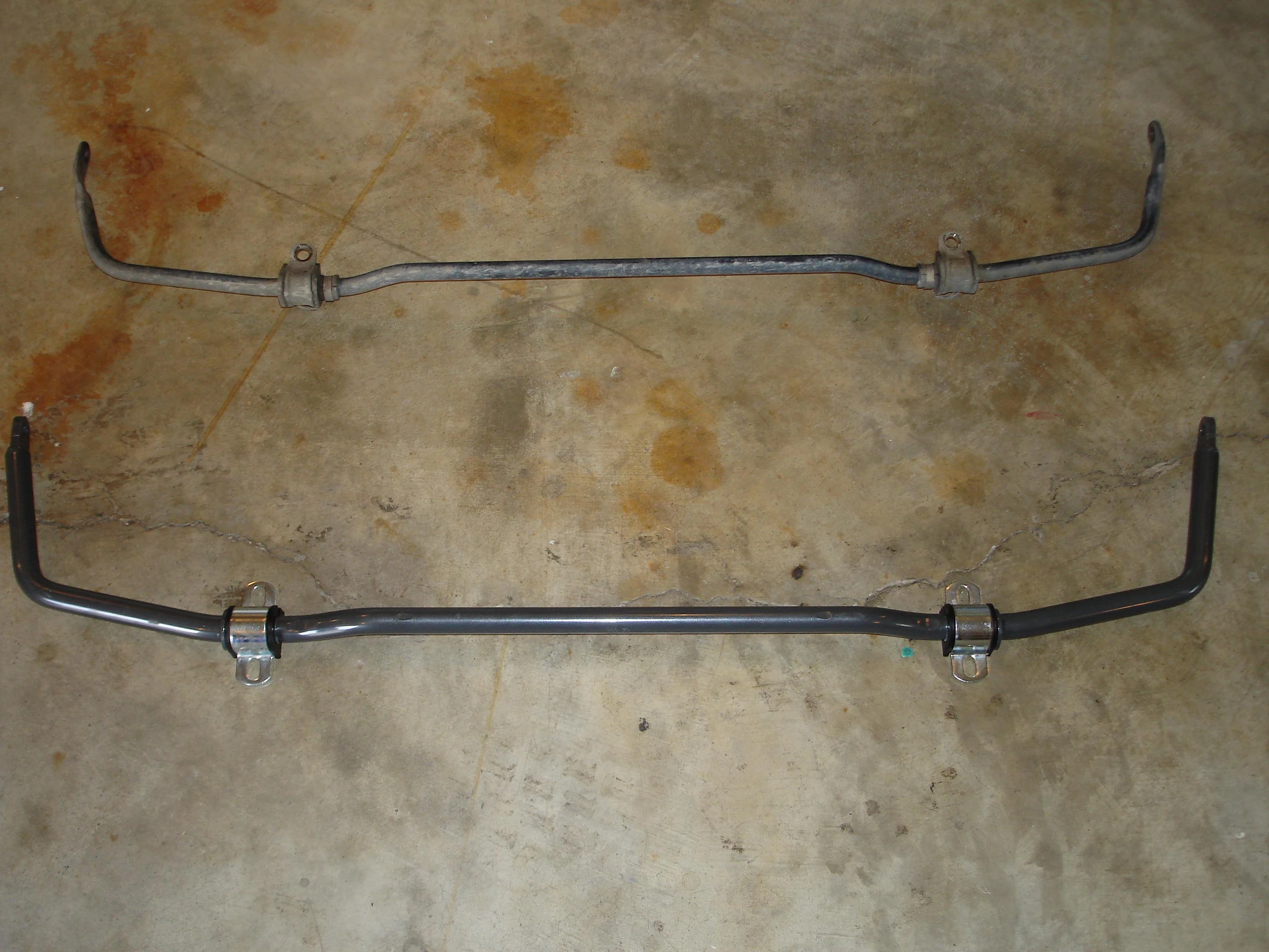

Be careful it doesn't fall on your head, and remove the bar from the car. Now, lube up the Progress urethane bushings with the supplied silicone lube and slide them onto the new swaybar, and then snap on the brackets. Compare your new bar to the old s***. Pic 4 and Pic 5

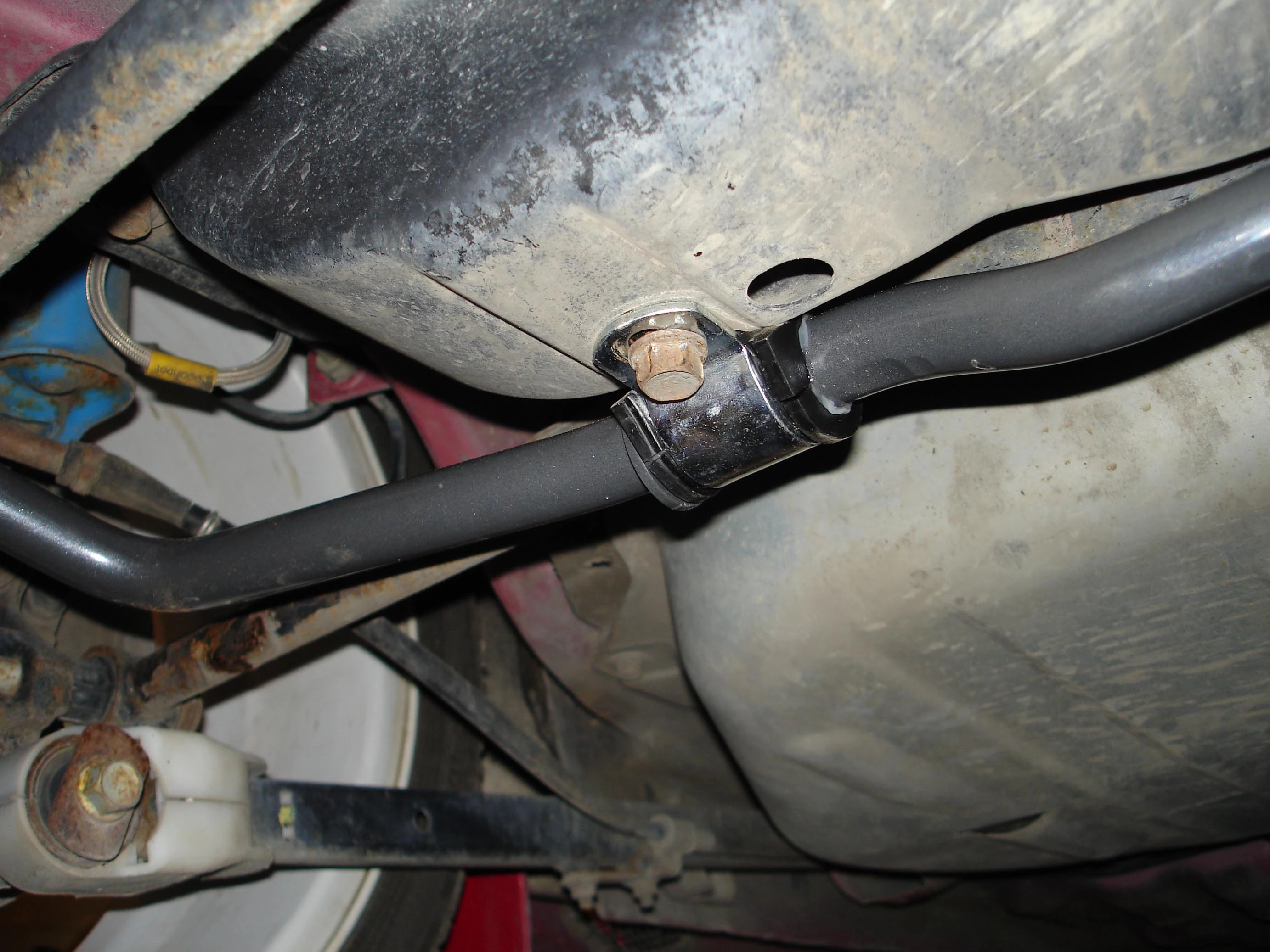

Now comes the fun part. You'll notice the supplied brackets need to be bent to match the stock ones. Don't s*** the bed, this is easier than you think. Put the new bar into the car, and secure it with the nuts on top. Tighten them down so there is no slack. Now, grab a floor jack. Simply jack the car from each bracket, gently and slowly and they will bend towards the back of the car, into position. This is actually a really cool way of doing it, as it kind of "pinches" the bushing around the bar real tight. When you get it lined up, you can slide the bolts in. Don't tighten them yet. Slide the endlinks into the sway bar, and thread the nuts on. (Which nuts? DEEEEEZ NUUTTZ!!!!!) Now that everything is in place, tighten it all down, and you're done. Pic 6 and Pic 7
