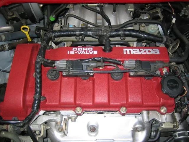

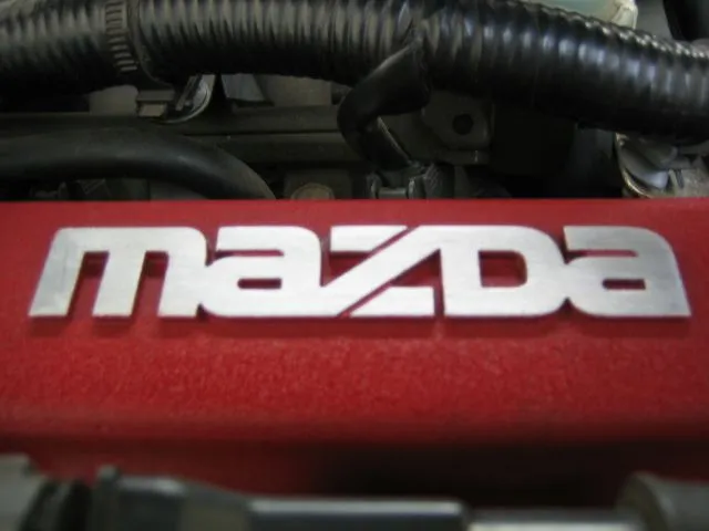

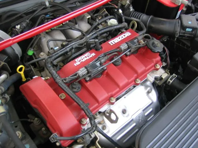

Thanks to Garretts77, here's my VC!!
That look's great! Quite familiar... I would reccomend painting the heat sheild black too. It makes the engine bay look very clean. I used 1200* black paint and it worked great. Just sand it down first and then make sure to get all oils off of it. I used brake cleaner after I sanded and then put about 5 coats of 1200* paint. It still looks good after about a year...

Yeah i want to paint the Heatsheild too, but couldn't find the right paint at autozone,i'm going to try walmart tomorrow. Hey did you primer it after sanding? cause i'm afraid the scartch might show.

The paint me and Garretts77 used was the VHT Wrinkle RED Paint. PN#SP-204. Good luck!!
