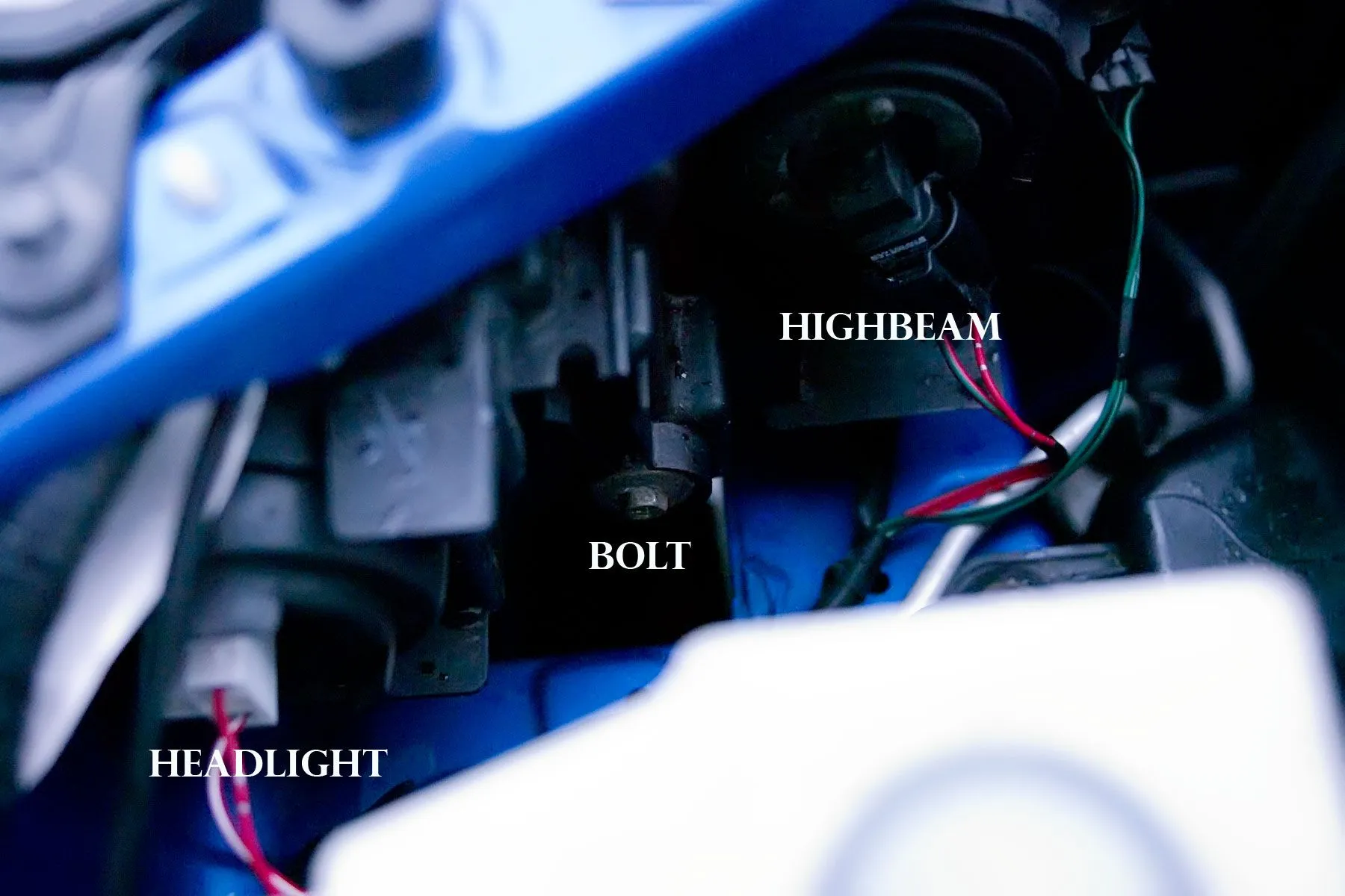

I had to go through lowering my lights a few weeks ago and this is what I found. It's actually a 10mm brass coloured bolt that is behind the lights. If you have a ratchet set use a 10mm bit and look at the bottm of the light assembly. Turn clockwise for lower and counter-clockwise to highten. There are tutorials that will demonstrate the procedure for aiming (i.e. at night on flat surface park xx ft away from wall....)
I have attached 3 photos of the bolt itself. These were all taken on the driver's side and naturally the passenger side is the same. I hope this helps a bit.

That's helpful. Is there any left/right adjuster? (not that you'd typically have to mess much with that)
I am sure that there is, but I can't answer specifically. It wasn't something I needed to do and I don't think I would work on that too much myself.
bazooka joe: did you guys know you can use a philips screw driver on this?
Yes you can. The turtorial I saw used the 10mm bit and I found it very comfortable to use, but a screwdriver will work also.
