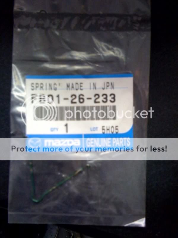

Ok so I am on the passenger rear and when I slid back the caliper there was no retaining spring???? So do I buy one from mazda or an auto parts store? This is weird because I am the original owner and the rear brakes have never been touched ( I neglected the rear brakes soo bad) Also I have uneven brake wear. Is this common or is that do to not having the retaining spring? the back part of the pad where the piston presses the brake to rotor is metal and the front side is pretty good? Hopefully someone can chime in.

So if anyone looses that rear Vpin or anti rattle spring on the rear here is the part#

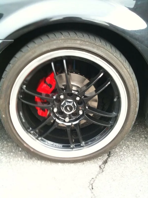

Thanks to this how-to I changed all my rotors and pads for under $150 (Centric Premium black-top rotors from CarPartsWholesale, Bendix CQ ceramic pads from RockAuto wholesaler close-out). Took me all weekend because I was taking my sweet precious time, removed every caliper, cleaned and painted each caliper. Since I took my brake lines out I then had to bleed my brakes which was well worth the trouble.
End result:
