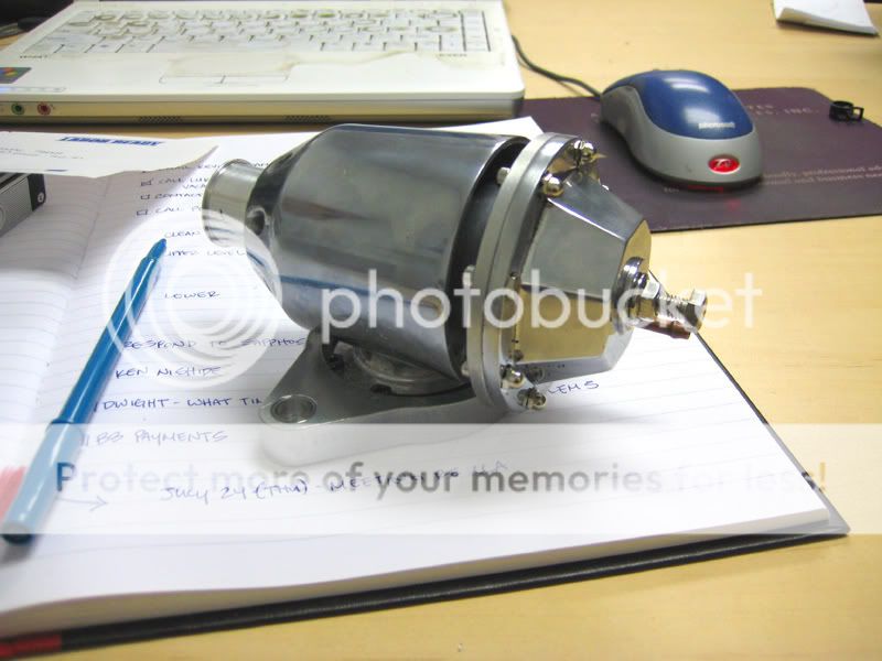

I took these a few months ago right after I put everything together and right before I stuck it in the car.
That was the absolute craziest C-ring I've ever seen. Usually, there's a tiny gap you need to close in order to get it into place - this one had a good 3/4 of an inch you needed to close together to get the thing in. What a PITA.
Oh, and re: what you asked (it's been a few months, as I said), but I believe the MS3 Kit and Valve seat together as is - it's tight - real tight. The O-Ring goes into the grove on the opposite side when you mount it to the engine.
Edit: Also, make sure you mount it as I have it pictured with the large opening pointing up and the small nipple pointing down. Once you get everything in place, the large part of the "UFO-looking" piece will hit the adapter, so you won't be able to rotate it to the correct position.
Man, I'm just post-whoring it up here. Here's how it should sit in the engine. Notice I had to ghetto cut the intercooler shroud (I cleaned it up later with a Dremel).
I also purchased a longer recirculation hose from Street Unit because of the odd angle the valve sits at - using the stock hose will cause it to pinch pretty heavily due to the shorter length. The majority consensus is that this will not impede any function, but I wanted to make absolutely sure.
