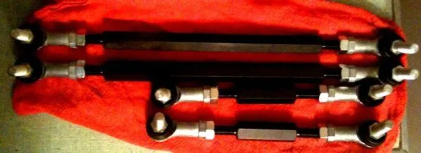

How to make Custom Sway Bar End links
Indeed those look good. Dimensions of the parts regardless of sourcing would help.
Typically any larger fastener supply house would not be able to provide individual items as wholesale costs are prohibitive to do so (thus why we have McMaster, Summit, Motion and other parts suppliers).
The dimensions on the joints change by manufacturer - the ones I got were THK. The threaded hex rod can be ordered shorter or longer.
Misumi is where I got mine. McMaster doesn't have evrything, especially in the metric sizes we need.

Nice that they have load ratings - and well rated for the application as well; the McMaster ball joint ends are non rated or if they are, relatively low values (typically I've seen only the spherical rod ends with listed ratings)
Aren't the balls in the first post rated to 3900 lbs?
yes, and that's what i just got, gonna try to put it togethter tonight

You're referencing the material Strength of Yielding Point (tensile*) and you're looking at the M6 size. The M10 (which I assume MP3me bought as that's stock size) is rated at 11300 N (Pk)
As such, they're rated in metric units (Newtons) and you'd have to convert to ANSI standard (lbf)
Thus, given 11300 N (Pk), which kgf = N0.101972 = 11300 x .101972 = 1152.28 kgf
Thus 1 kgf = 2.2 lbf, so 1152.28 kgf x 2.2. = 2535.02 lbf (comparable to 2036 lbf of the ones I purchased)
Now moving on to the forces themselves, the Misumi M10 bearing is specing out static radial (which isn't the same as the axial) load and would be 4105.39 lbf (as my axial pull out is "only" 1302 lbf)
(someone can double check my math)
That said, we end up comparing apple forces to orange forces. Axial forces run parallel or "through" the ball/stud - trying to pull the ball out of its bearing races - while radial load is orthogonal (90o) to the stud - forcing loads "through" the bearing itself...
In addition, we end up talking about the difference between static and dynamic loads (and not even taking into account any degrees of misalignment at any given point in the linkage cycle)
If just going off static loads, one would need to to convert axial to radial which I know can be determined, I just don't have the wherewithal/machinery handbook to take up at the moment....
So which are better? Not sure; higher numbers are arguably better, but I there's also a cost/benefit that one must evaluate as well as each person's suspension setups and driving demands.

This morning I cut the nuts off the ball studs with a cutoff wheel on my grinder. One of the end links was BENT, and the ball/socket had about 1/8" gap - I could move the ball left-right or up-down in the socket. I bolted in the new assemblies and Voila! No clunk! And SO nice and easy to adjust each side's length. SWEET!
So for everyone on the Clunk-kit GI waiting list (that has now been locked and rendered useless to us all) if you haven't replaced your endlinks, do that before you spend $200+ on the clunk kit. Looks like you have the time............

Per #1, no you don't, but it's a usability feature. You can tighten or losen (i.e. adjust preload on the swaybar) by turning the hex portion of the linkage in one direction, thus threading the rod in or out of each side simultaneously.
Otherwise you have to remove the link on one side and adjust the rod end/ball joint respectively, and reinstall.

its time to get some front ones for me now so ill be getting a set of LH thread balls and rod/nuts, and im gonna try out some 6" lengths of the hex rod to adjust my rods.
I wanted to use a 12" section for the front link but im not lowered, so my swaybar wouldnt sit level at stock right height.
center to center would be about 14" if i did that. so ill just have to have a 6" section connected to stainless threaded rod on both sides.
