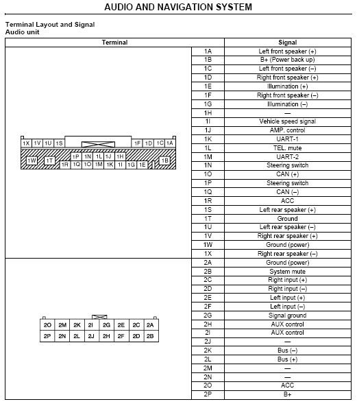

Hi guys,
i think i have a solution for owners mazda 6 2002 - 2005.
After many of researching i realized one thing. I have also mazda 6 2005 and the origin guide for AUX made by wannabe is for mazda 6 speed which is newer and has different 16 pin connector.
Lets take a look...
here's mazda 6 16 pin connector:
and here's mazda 6 speed:
attachment.php
so in my opinion for us (mazda 6 owners) we need to connect pin 1 (2A) with pin 9 (2I) which is AUX control instead of pin 13 (2M) which is AUX control for mazda 6 speed.
I didn't tried it yet but hope that it will works. (smoke)
Bye

Hi guys,
Bye
I have tried this, but nothing :(
Yes, nothing happend i know, but meanwhile i tried reconnect pins 2I and 2H (AUX cont) and then when i turn on the radio and press cd button i saw RSES on display...but no sound :( if i would had a scheme of this HU i will be able to do it because in this state RSES we need only switch HU mode to AUX but so far i don't know how :/ anyone have this intrenal scheme?

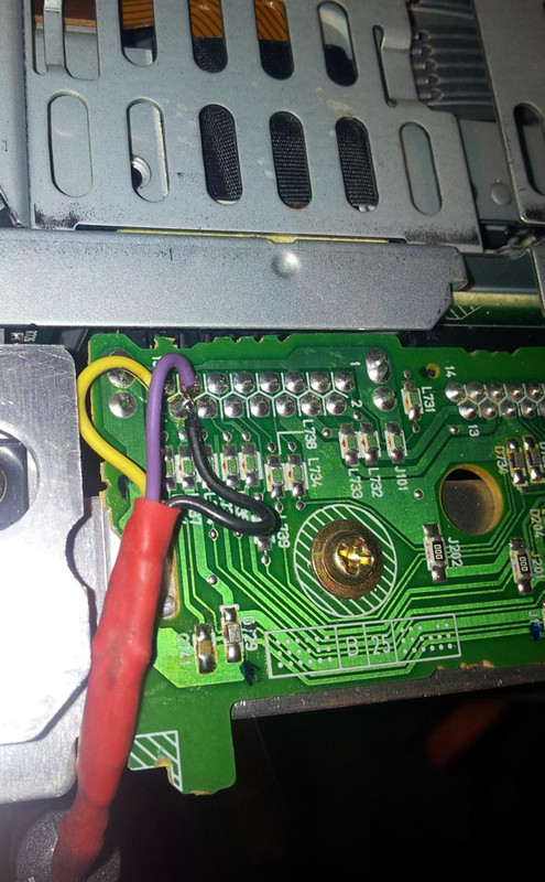

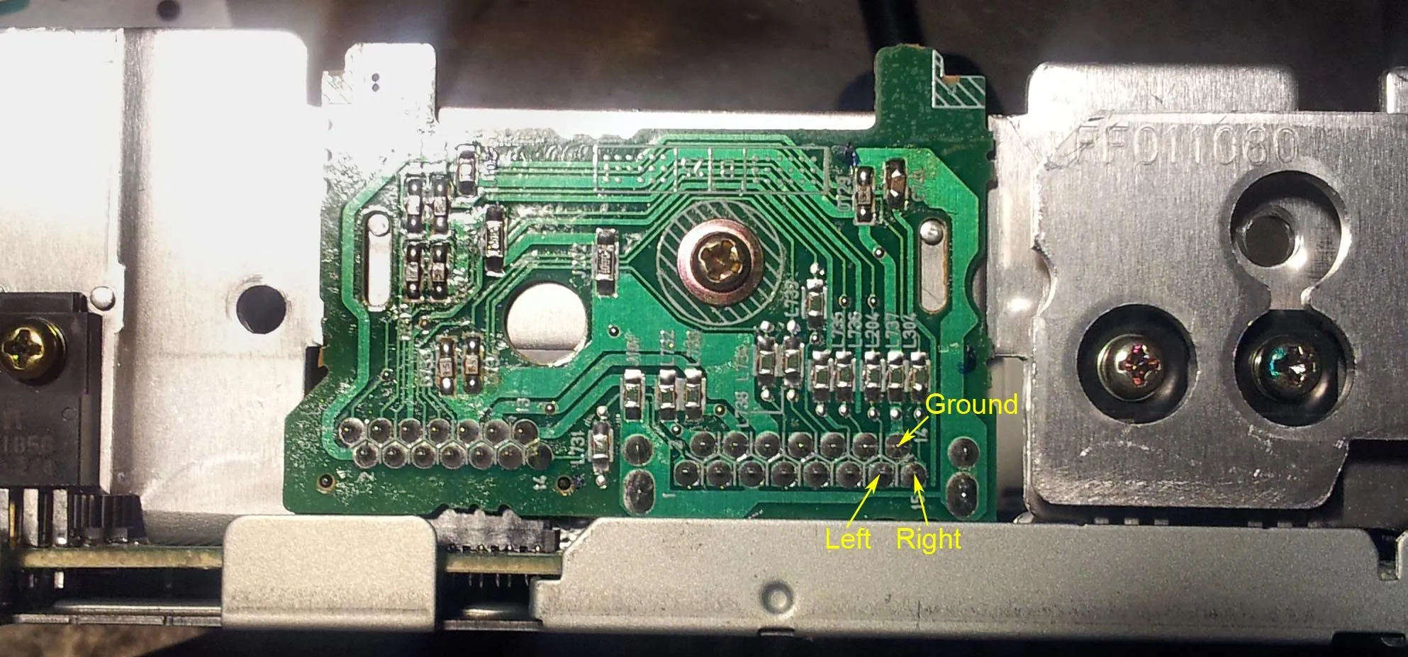

GREAT idea! Yesterday I have disasembled my head unit (2003 mazda 6 2.3i non-bose) and the PCB appears to be different. There is NO CN805 connector and no labels were printed on the PCB. So somehow I managed to switch my head unit player with a blank audio disk in disasembled mode and put a piece of long wire to each pins. When I touched pin 13 and 15 I heared a "clip" in left and right channels accordingly. So i soldered aux left to 13 and aux right to 15 pin. Afterwards i "assumed" :) that the ground should be a middle pin in upper row no14. connected ground to it and now I have crystal clear audio sound in my car. HUUUUUGE improvement over FM modulator. The only thing i wonder if pin 14 is really ground or not. Any help will be greatly appreciated. Anyways IT WORKS like a charm with my Ipod!
There is NO CN805 connector and no labels were printed on the PCB!
Sorry for not posting any images, but i simply had no time.

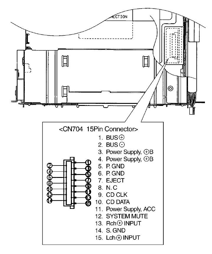

Ok, what you did is you soldered to the CD connector PCB of the amplifier.
I soldered on the opposite side, that is on the CD-player main PCB, which is located in the top module (top metal box).
Here is the PIN assignment for your connector (CN 704):
I hope this helps.

yes I was right "assuming" that the ground would be pin 14. :) Unfortunately i forgot to clean the lens physically so the only problem I had today morning was skipping cd during driving on not flat roads. Then I put a self-made lens cleaner and cleaned the laser. The disk never skips now, finds track much faster and keeps it. I want to try to write a blank CD with 2 tracks. The first 70 min silence and the second 5 or 10 minute silence tracks and put the last i.e. second track on repeat mode. In this case the second track would be written on the outer bigger radius part of the cd and I think it would be "easier" for the laser head to read data. I will give a try tomorrow and post my results. Also I modified my old Griffin Road Trip FM modulator and took Ipod lineout from it and it is charging and playing the same time holding my ipod in vertical position switched in sigarete lighter. Also when i turn off the engine, Ipod stops automatically.
In any case, I want to thank you for a BRILLIANT idea. The difference is HUUUUUUUUUGE. I have JBL sub with pioneer amp installed and it delivers MUCH better power via AUX rather from FM modulator.
